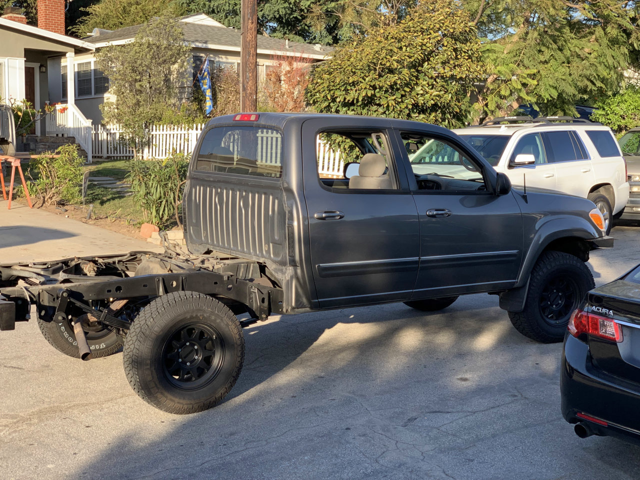

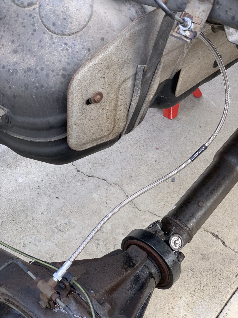

    A little update for my two friends. The front end feels new with limited wheel time. It needs a double check of torque and an alignment. That can wait, because I can drive the boy's truck. The rear end has the long-awaited shock relocation coming. As noted before,I made the frame weak by removing the OEM hitch, the spare tire, and stressed it more with longer shackles. It's complaining now. Like a bitch. I really like Archive Garage (10%) off now although not on the homepage - I got it, try adding something to the cart to check. I was on the phone. Or email Eric. Anyway, the bed is coming off after the weekend. Time for shock relocation, finish hitch and support bumper welds, assess frame bracing needs. I have AG hammer hangers in route and the bed brace DIY plates. I may fab a brace in addition. Skid plates are here, but they can wait as well, first things first. Other things that can wait are new lic plate bulbs, updated stereo, back up cam, compressor mount, lights.....geez, I'll stop.

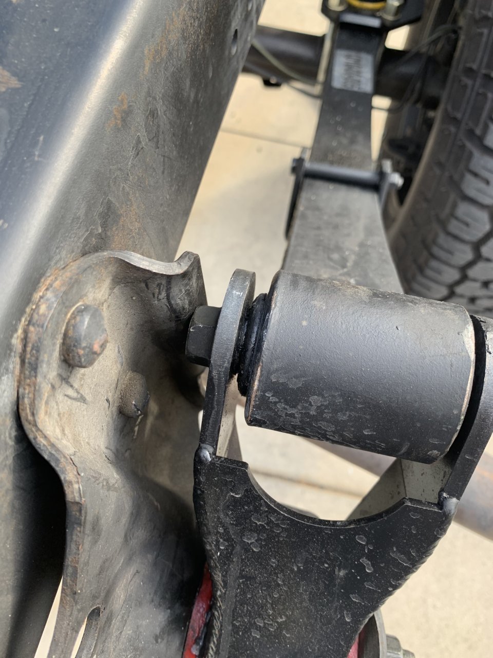

    I have his hammer hangers on order, but my shackles are TC and the hangers are currently OEM. These MD Archives could settle like any I guess. And then I could put OEM length shackles back on. But the build of them is really good, and I anticipate keeping it as is - except for the hammer hangers, which don't add or lose lift.

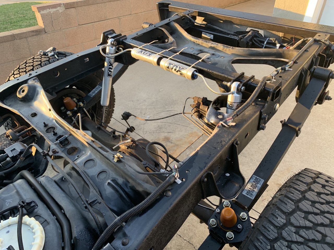

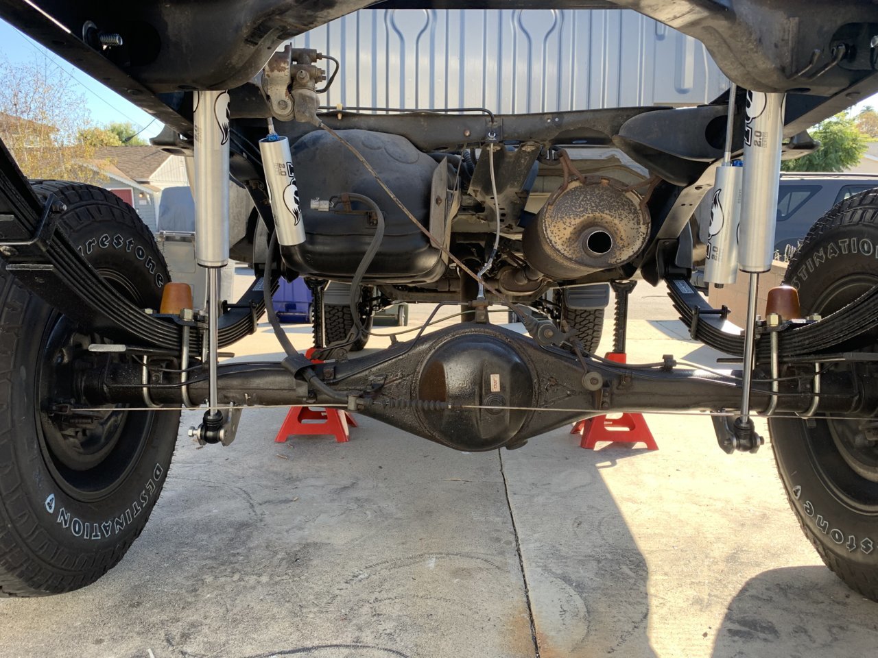

    Dry fit of the rear shock relocation.

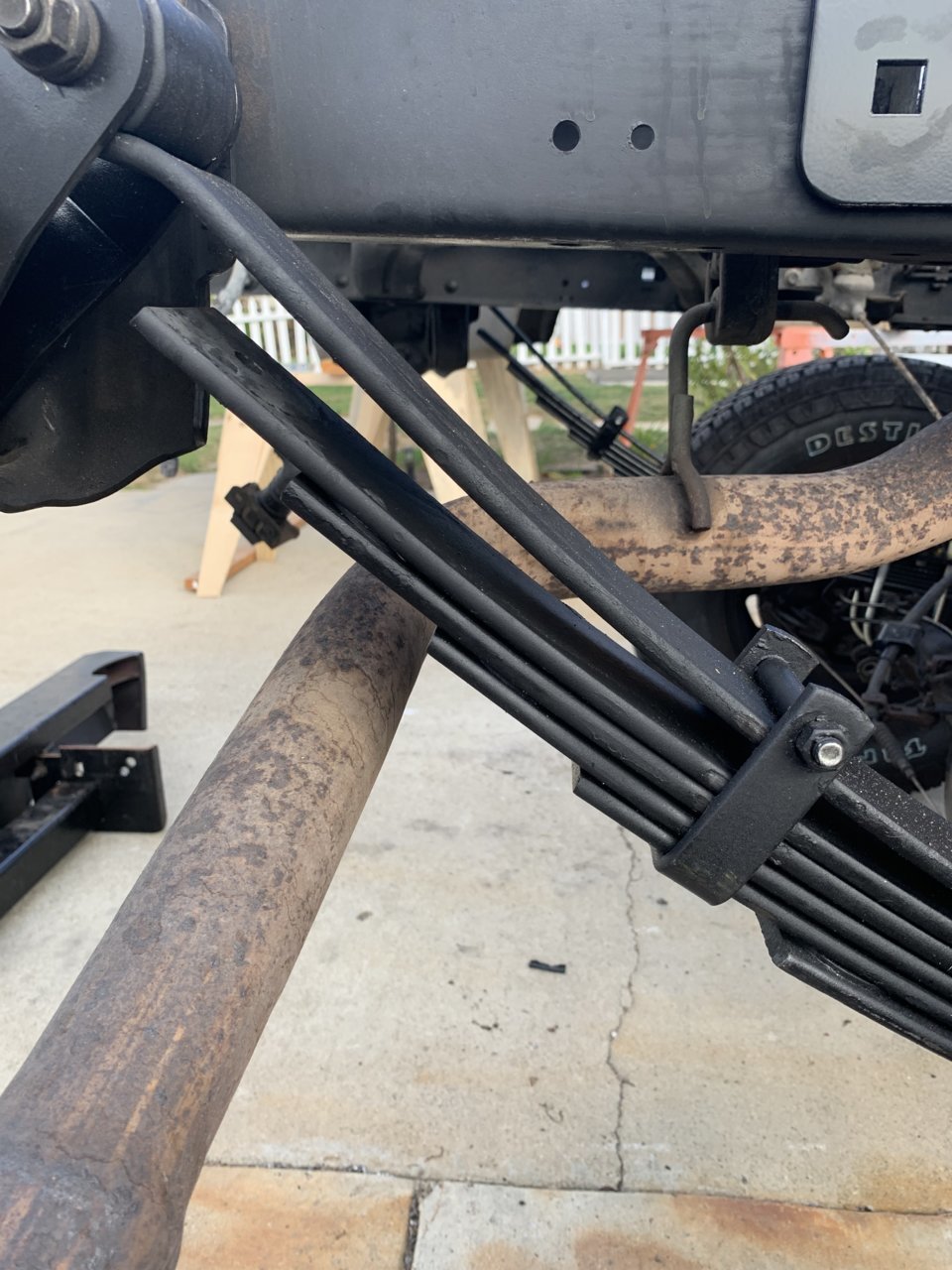

    I’m not at full droop yet, but clearly limit straps are in order.
    FrenchToasty, SharkDog and Darkness like this.

    From the first pic it looks like you have limit bolts :rofl: not a wear item like those pesky straps! Now im curious if my leaf springs hit that way, maybe not since I have stock shackles still.
    Second pic is just telling you to chop the last foot of tailpipe off like I did.
    FrenchToasty and Tundra2 like this.

    Lol, those are wannabe limit bolts, that would just bang and cry! I’m not going to worry about those until the new hangers are here. But, this is needed….

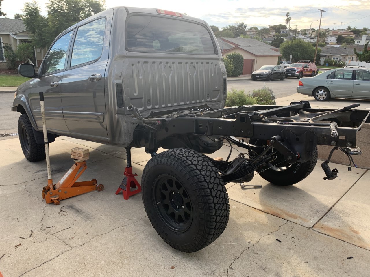

    Full droop. More available if I push down on the tides. But a good limit point.
    yup on the tailpipe. Just waiting to look at shock clearance so I make an informed cut.

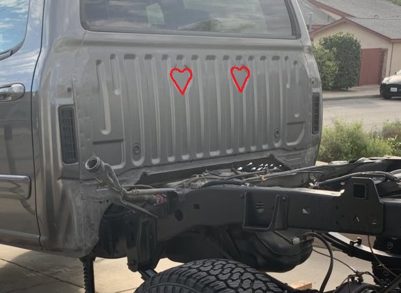

    Super weird observation, but the 1st time I looked at this picture, I saw hearts in these two spots while zoomed out. When I zoom in, clearly it's a round void. Optical illusion? Or maybe I'm just projecting how much I'm loving this build!

    I see them too, now that you drew them on there...:0

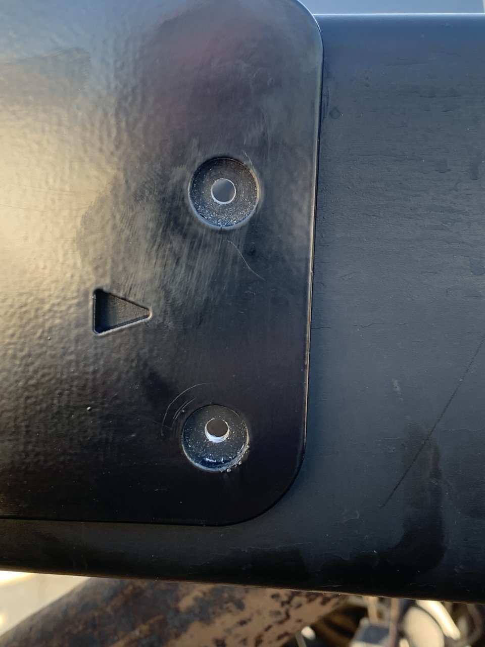

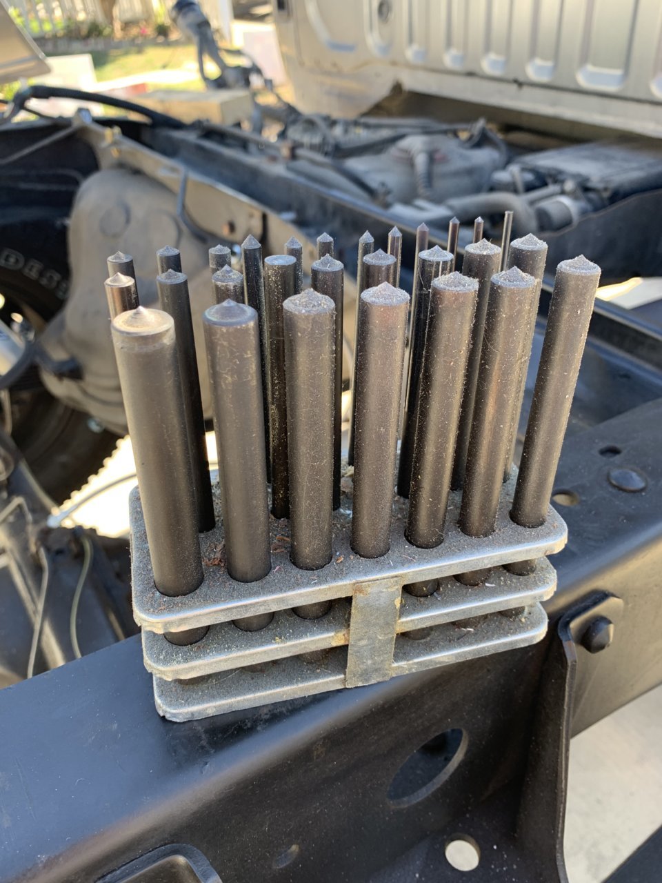

    Centering punches are great.

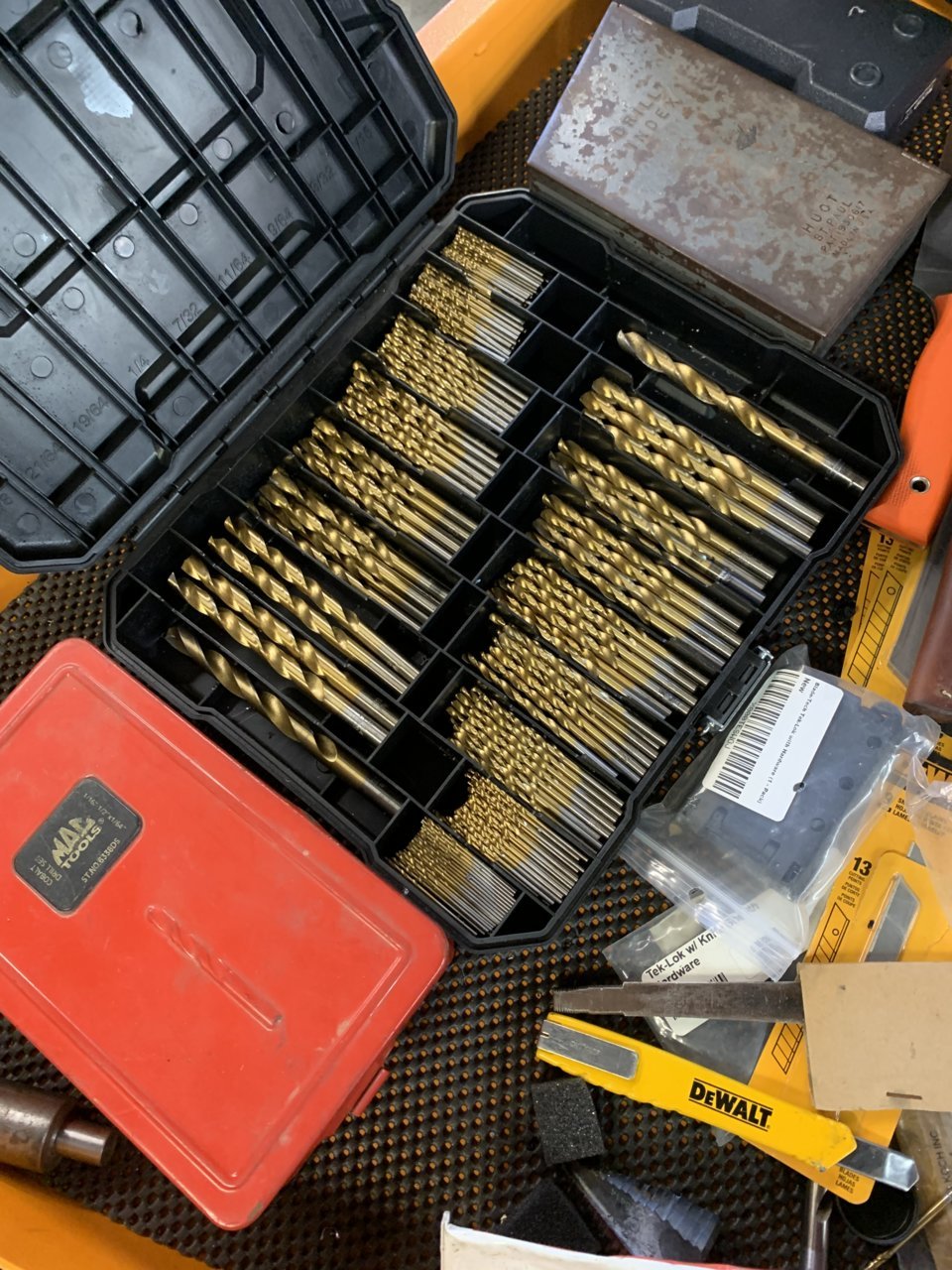

    That center punch looks like it did work well, I need to pick one up. Are you using step bits from here or something better?

    I love step bits but for this I buy the cheap Costco titanium bits. Run a 5/32 or close backwards to clean the punch, then forward to drill the pilot. Then straight to 1/2. Oil on the bigger bits. I toss the small bits, sharpen the bigger. If I was on a press, good bits.

    These are Amazon/Chinese. No way precision but good enough for who they are for. Served me well in many applications.

    Looks like a bit more than a foot was cut off of that tailpipe! Coming along nicely.

    Yeah, there was no where else to cut it that wasn’t up. Shock interference…

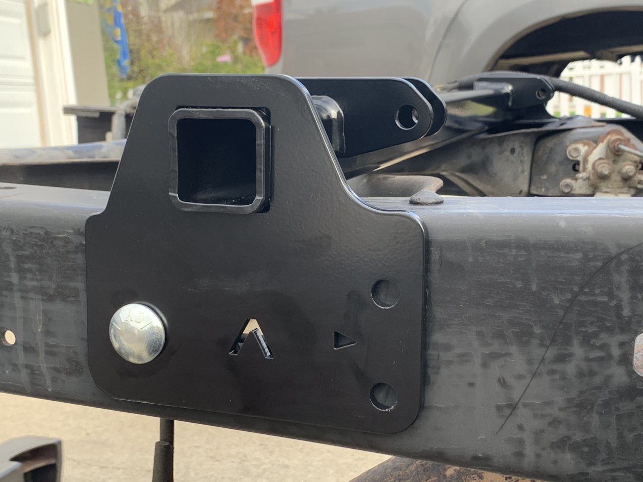

    Shock mounts lower than I would like, but I spread them out as far as I could. At first I was thinking about maximizing droop, but this spring setup will go forever. So I decided, hopefully rightly, to focus on compression and ensure they can’t top out. Straps for droop. The only thing that would turn up the mounts, would be shorter shocks. That would raise the low points 1-1.5 inches. Going from a 12" to a 10" shock would probably defeat some of what we are doing here.

    Might be time to join the Spintech club :fistbump:
    Is that with 12" 2.0 shocks?
    Did you measure right to the bump stop, or did you allow room for squish?

    I looked at where the bump stop would squash down to the hardware and explode. That’s what I was going for anyway. Yes, 12” thanks @Darkness insert fist bump

    I might be walking the line on compression. I think I'm still in the green, but I'll have to see when it's all loaded up and big dips. You definitely know those shocks are back there...
    Ignore the zip ties and temp bolts. :0
