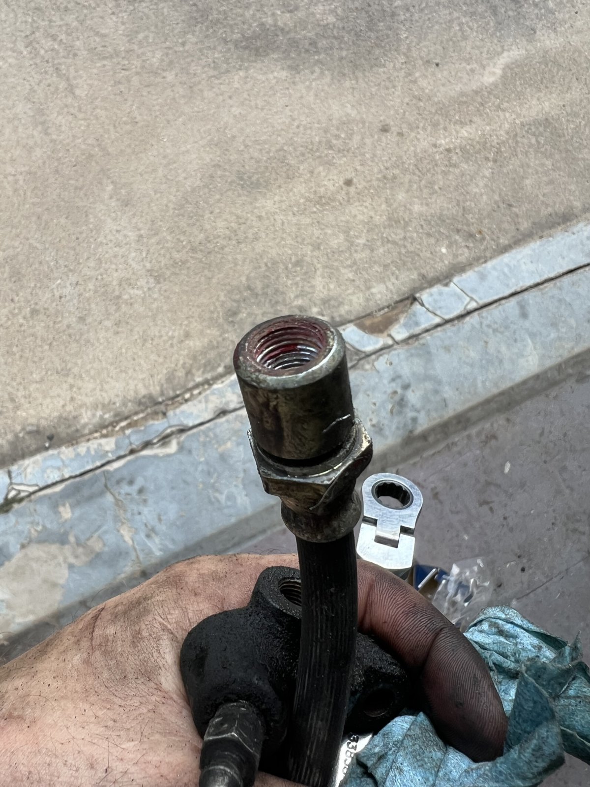

    Popped the top off and been enjoying it. Just replaced the clutch master, slave, and rubber hose and gave it fresh fluid. Clutch feels way better. It was always good but now it’s firm and has some feel. Also, someone decided to red lock tite the fitting on the rubber line. What a pain that was to get free. IMG_2156.jpg

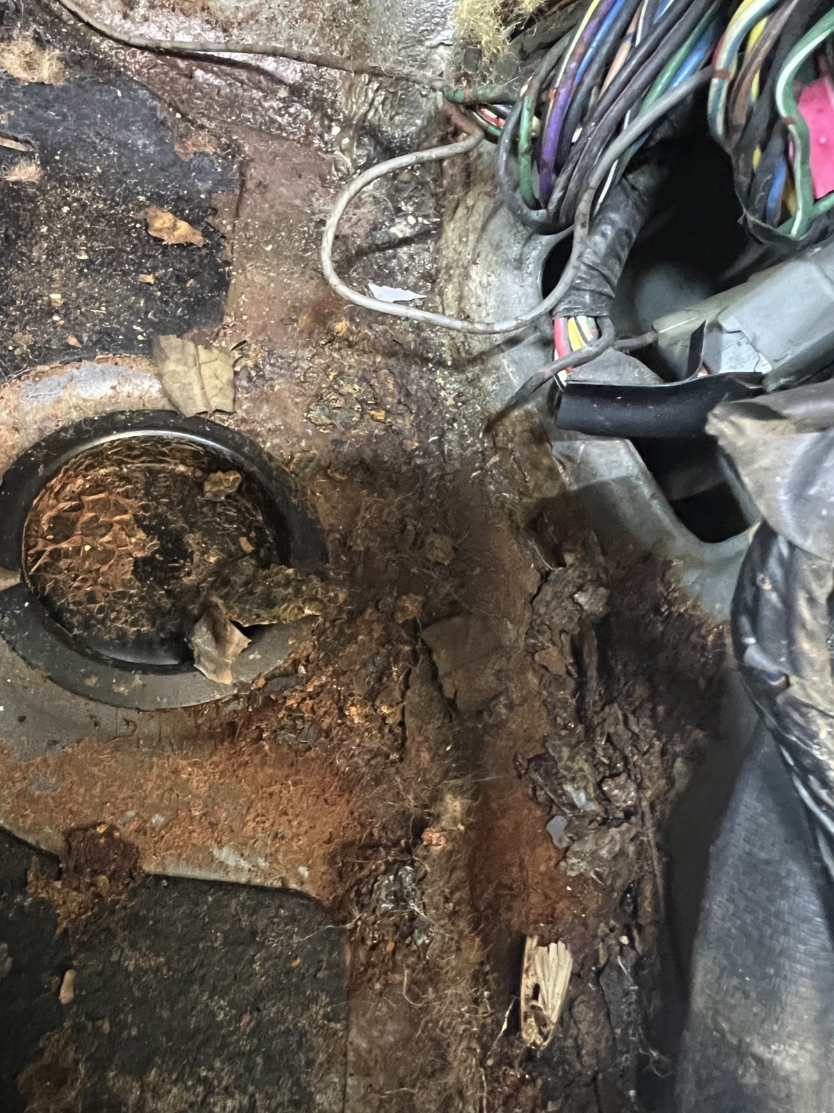

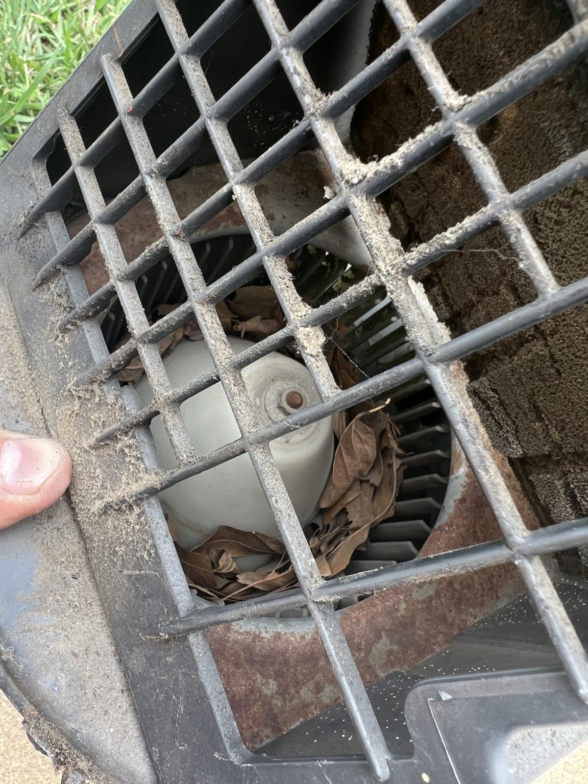

    Been a minute. Factory alternator gave up the ghost so I bought a new (not remand) ACdelco. It lasted less than 5 minutes before the bearings started to smoke. Rma’d it and got another and it lasted 10mins so guess it’s good.

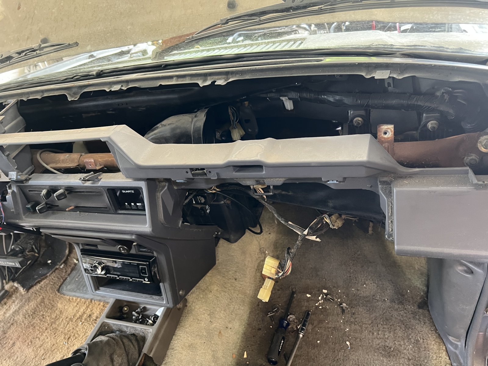

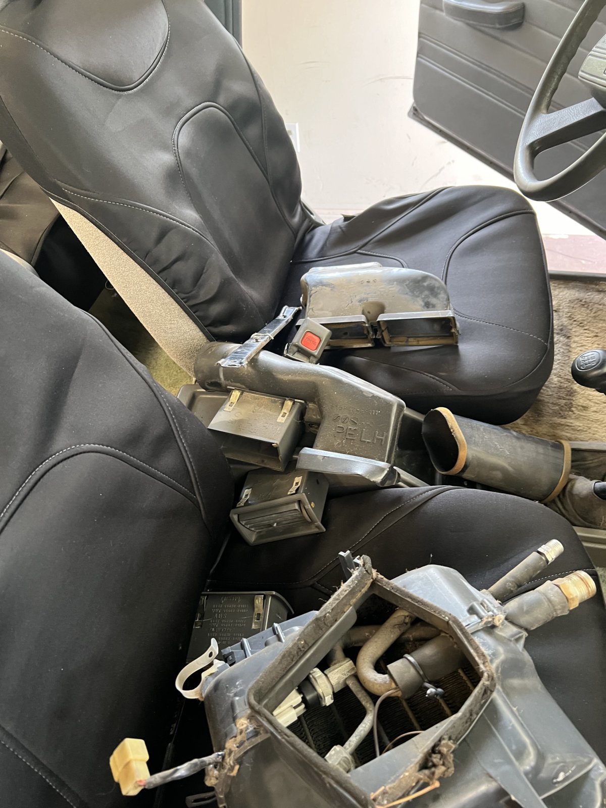

    Finally got not scorching weather to work on the AC on this thing. The AC conversion valves I got didn’t fit. I’ve got a funky 3/16 and 1/4 and had trouble finding some. I think I’ve got some and we’ll find out Monday.
    I went ahead and bought a new compressor thinking it may come with the valves and it didn’t. Of course I got the model specific to my VIN but my compressor has the older compressor on it. Mid year change strikes again (look at where the allen heads are).

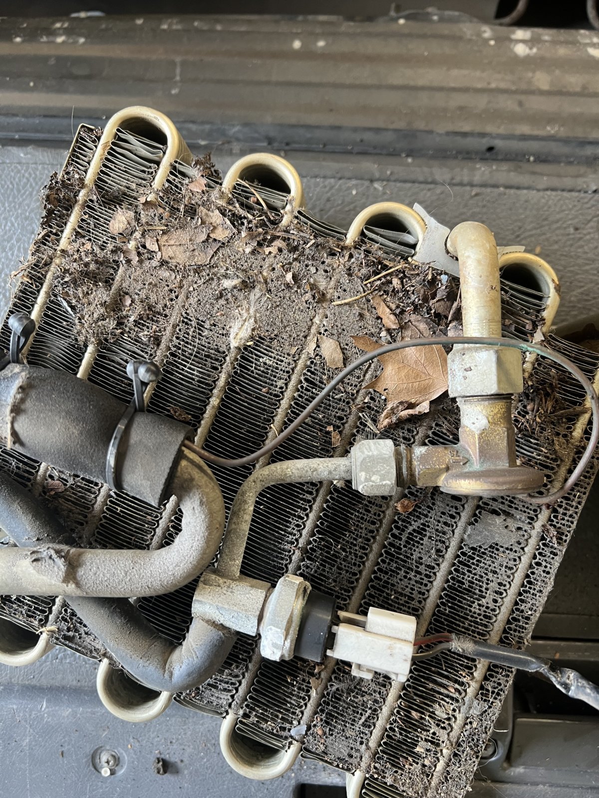

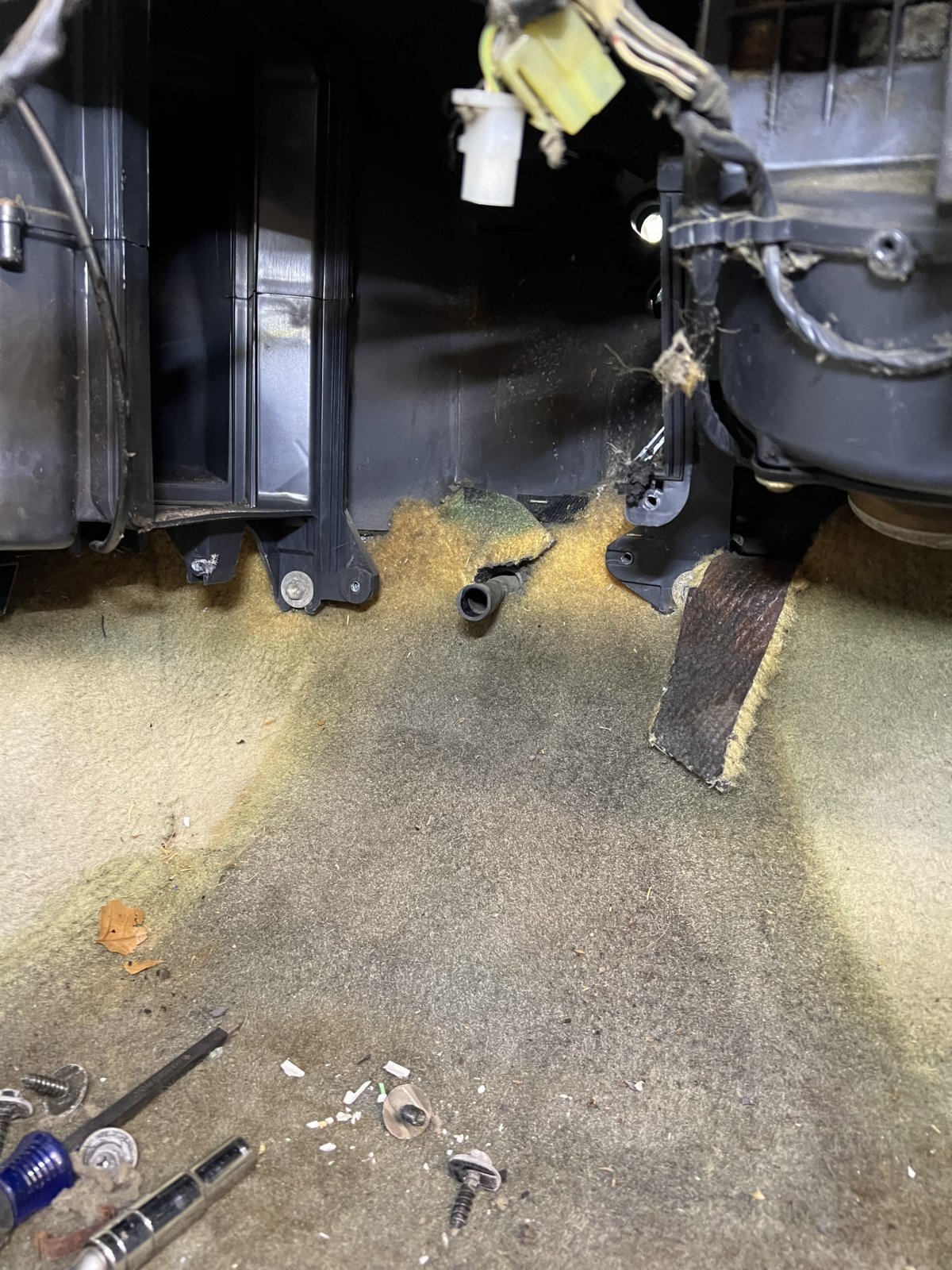

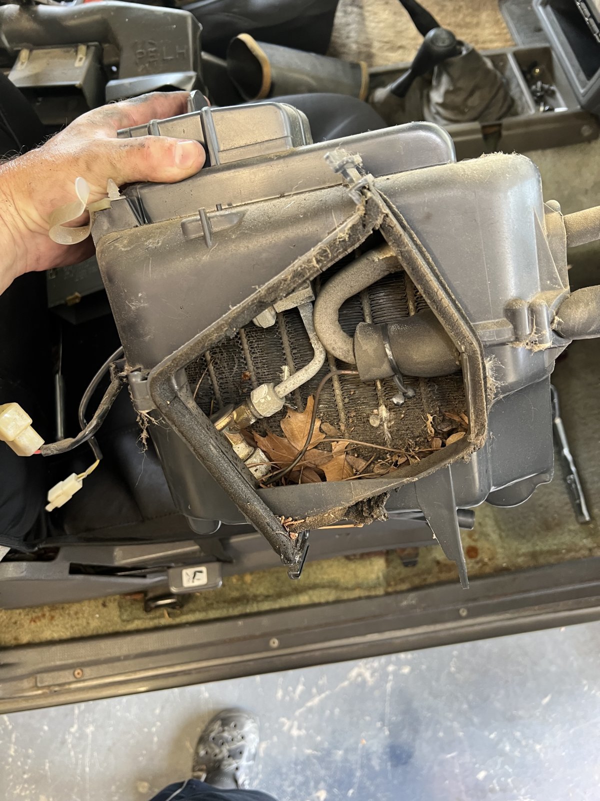

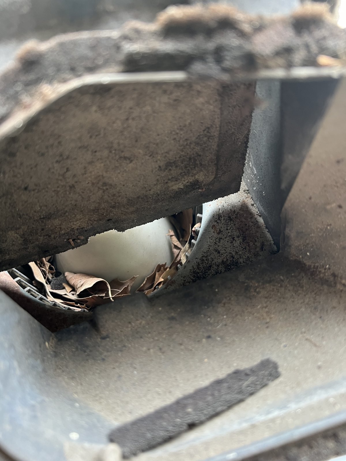

    Went to pull the evaporator out to replace the expansion valve and found it packed full of crap along with the blower motor packed full of crap. So now I need to go get some cleaner and get the evaporator cleaned up.

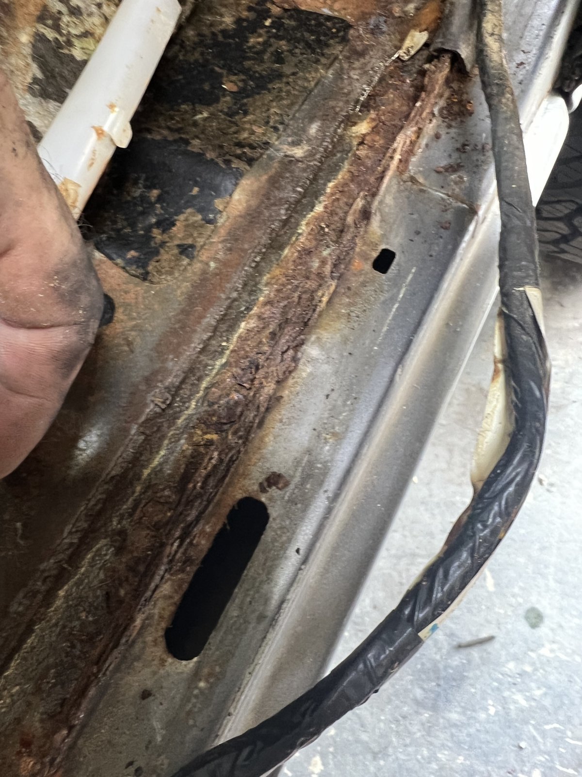

    Also found rust on the passenger floorboard. It’s not all the way through but there’s a couple of spots I’m not thrilled with. Gonna have to wire wheel it and go from there. Guess I got my excuse to order new carpet and pad now.
    All the foam in this system is rotten and falling apart so I need to source some new stuff to seal it back up.
    At least I’ve got all new seals and everything is apart so easy to replace all those.
    Maybe one day I’ll drive this thing with AC.
