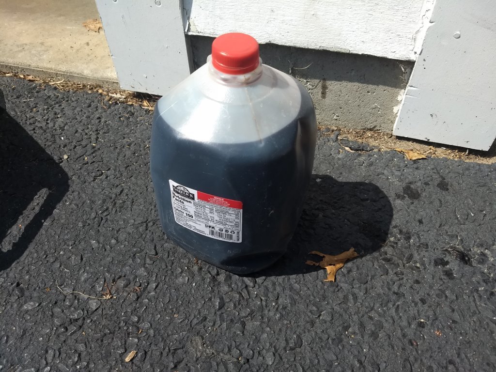

    Just for reference: a 2 years / 20k miles ATF with no cooler from 2022 Sequoia (V8). Tundra was worse. The color was the reason the cooler was installed in Sequoia as well. Otherwise the transmission was shifting fine. Occasional temperatures observation didn't reveal anything utterly bad, unlike in Tundra. But brown ATF with apparent inclusion of worn clutch materials speak for itself.
    We don't plan on getting rid of our V8s at 200k nor 2M miles, so I keep maintaining them good. My next car after Tundra is wheelchair.
