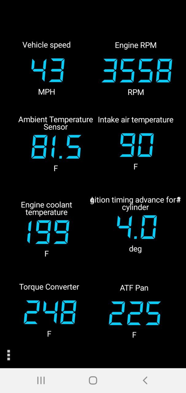

    Lol at the 68-221f operating range.
    Mine never had a trailer connected to it and easily exceeded that.
    SomeGuy4 and Ruggybuggy[OP] like this.

    That 68-221 sounds like the trouble code parameters mentioned in the other now locked Transmission Cooler Missing thread that the original poster was taking as the operating temps.

    I understand it came from Toyota rep. I think he got the information from the same place @Ruggybuggy pulled this information about a trouble code.
    A couple of posters in multiple threads have misinterpreted this code for the normal operating temps when it obviously isn’t. I don’t think it is coincidence that the temperatures for the trouble code as well as the reps response are the same. It seems like a misinterpretation on the reps part
    https://www.tundras.com/threads/2019-2020-transmission-cooler-missing.72484/#post-1861105
    GODZILLA and AZBoatHauler like this.

    And that code just refers to a defective sensor. Nothing indicative of temp fluid I believe.

    Exactly. Pretty much everyone has had trans temps over 221 at some point more than likely if they don’t have the cooler so there’s no way that’s the top operating temp for normal

    And if it was then that’s when the overheat light would come on. But it comes on at 302, 81 degrees higher.

    Ill bet that 221 temp is based on the 18 and older trucks WITH a cooler... since mine wont even get near 200 after adding the cooler.
    Toyota probably changed the warning light trigger and "normal operating temperature" window on the 19/20 trucks.
