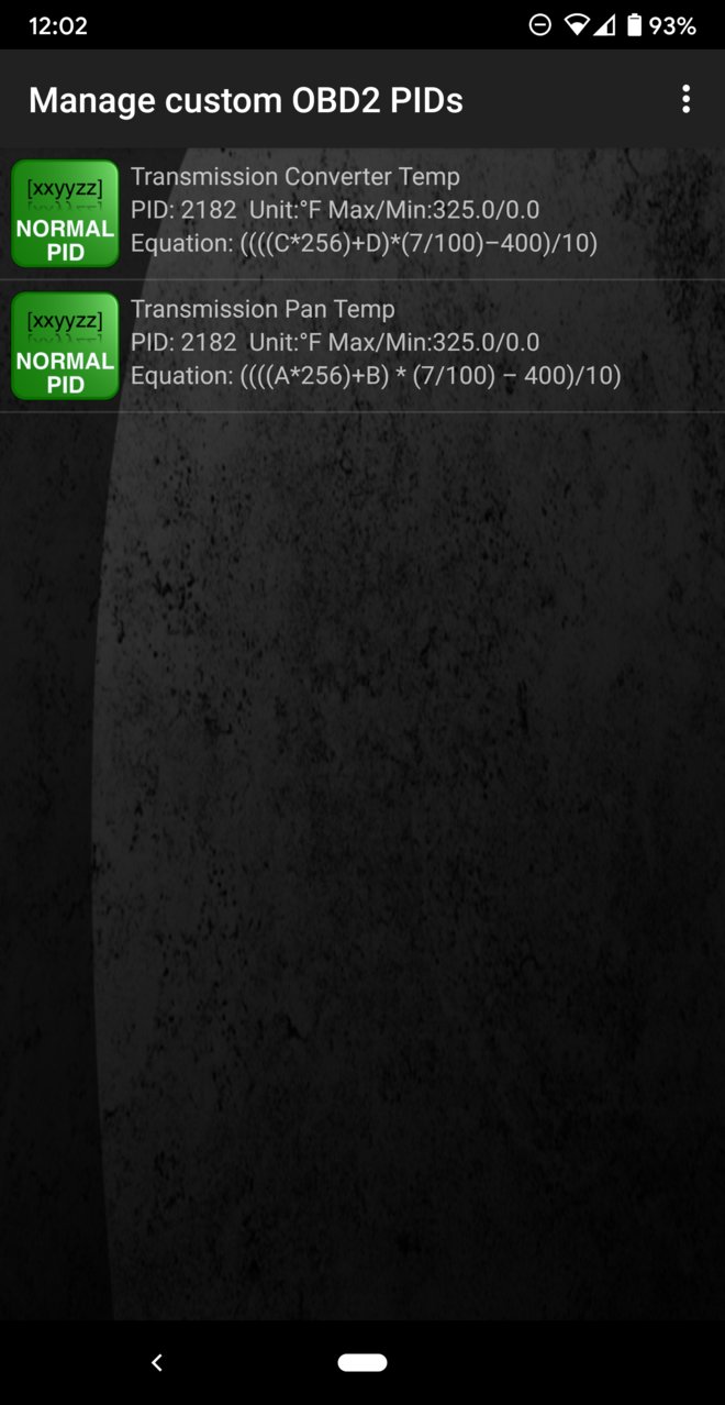

    #42
    AZ_Tundra1
    AZ_Tundra1 Gold member
    Jun 3, 2020
    #47514
    101
    Phoenix, AZ
    2020 White Tundra SR5
    Bilstien 6112 front shocks set at 1.9"
    That was it thank you! I also had the wrong PID numbers.
