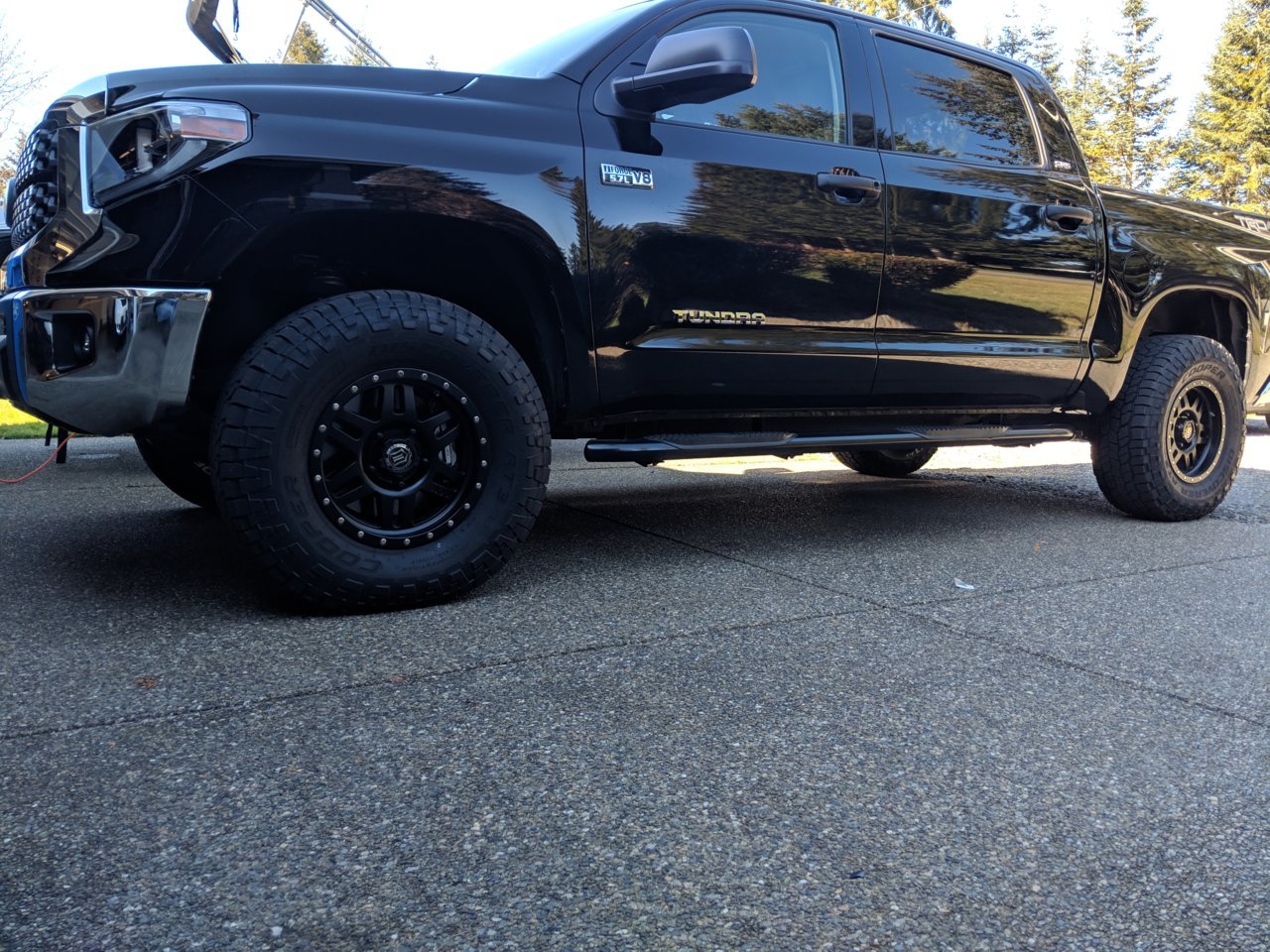

    I still have some work to do but it’s getting better.
    Wheels - Icon Alloys Six Speed Wheels
    Tires - BFG KO2 34 X 10.5 X 17

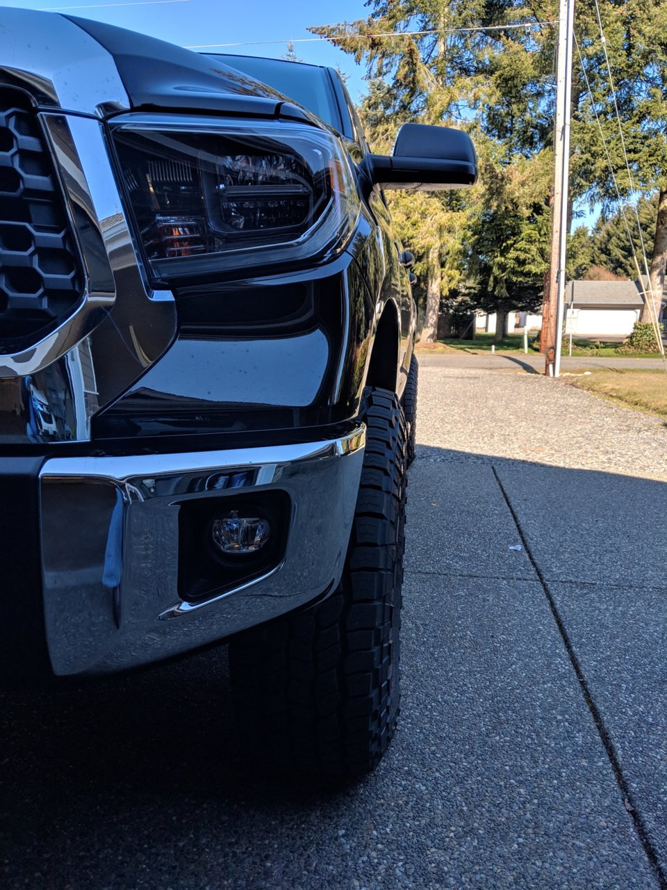

    Can you do a picture fromt the front showing how much it either tucks or sticks out? these might be my next wheel and youre running the tire size id want as well!

    I’d rather that they stick out a little more so I’m planning on just putting in some 25mm spacers. Here are a couple pics.

    Any rubbing at all? just trying to prepare myself, im doing a 2.5-3" lift and im inbetween a 285/75/17 or the 34". i want tall and sorta skinny clean with the lip. not sticking out toooo much.
  27. Feb 11, 2019 at 5:29 PM
    #27
    twestengineering
    twestengineering New Member
    Jan 11, 2019
    #24321
    5
    Trace
    2012 Tundra
    No rubbing at all. Probably 1/2 to 3/4” clearance in both directions and I didn’t have to remove my front or rear mud flaps. The pics show the closest that the tires ever get to the mud flaps on level ground.
    34” x 10.5 (and the metric equivalents) are perfect with just a leveling kit if you don’t want to do any trimming or mud flap removal.
    The negative for me was that the tire size was hard for me to find in stock, especially the 285.
    If I could do it over, I’d probably rather run 35’s, remove the mud flaps and do some plastic trimming if necessary. But that’s just me. I’m looking for a bigger/taller setup but it’ll have to wait now. I’ll focus on other improvements first at this point.
