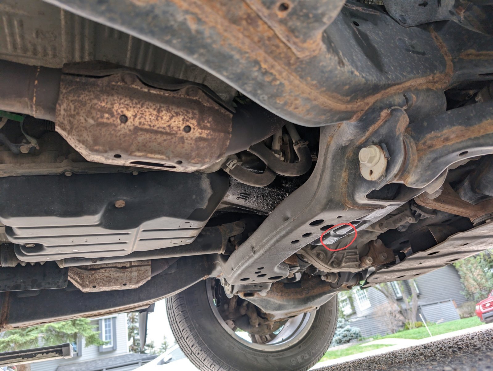

    Can you confirm there is a drip at the front of the oil pan in this photo? Are you getting any dripping on the ground? If so, what color, or can you put something down underneath to figure that out?

    RMS?

    Based on your picture it looks like it is coming from the bell housing weep hole (hole in-between the engine and trans).
    Could be Rear Main Seal.
    Could also be a bad PCV causing excess crankcase pressure. I had the same weep from the hole, changed PCV, no more weep.

    I like to change out the PCV once a year. its less than 10 dollars and really easy to do. If it gets you .01 mpg it pays for itself many times over.
