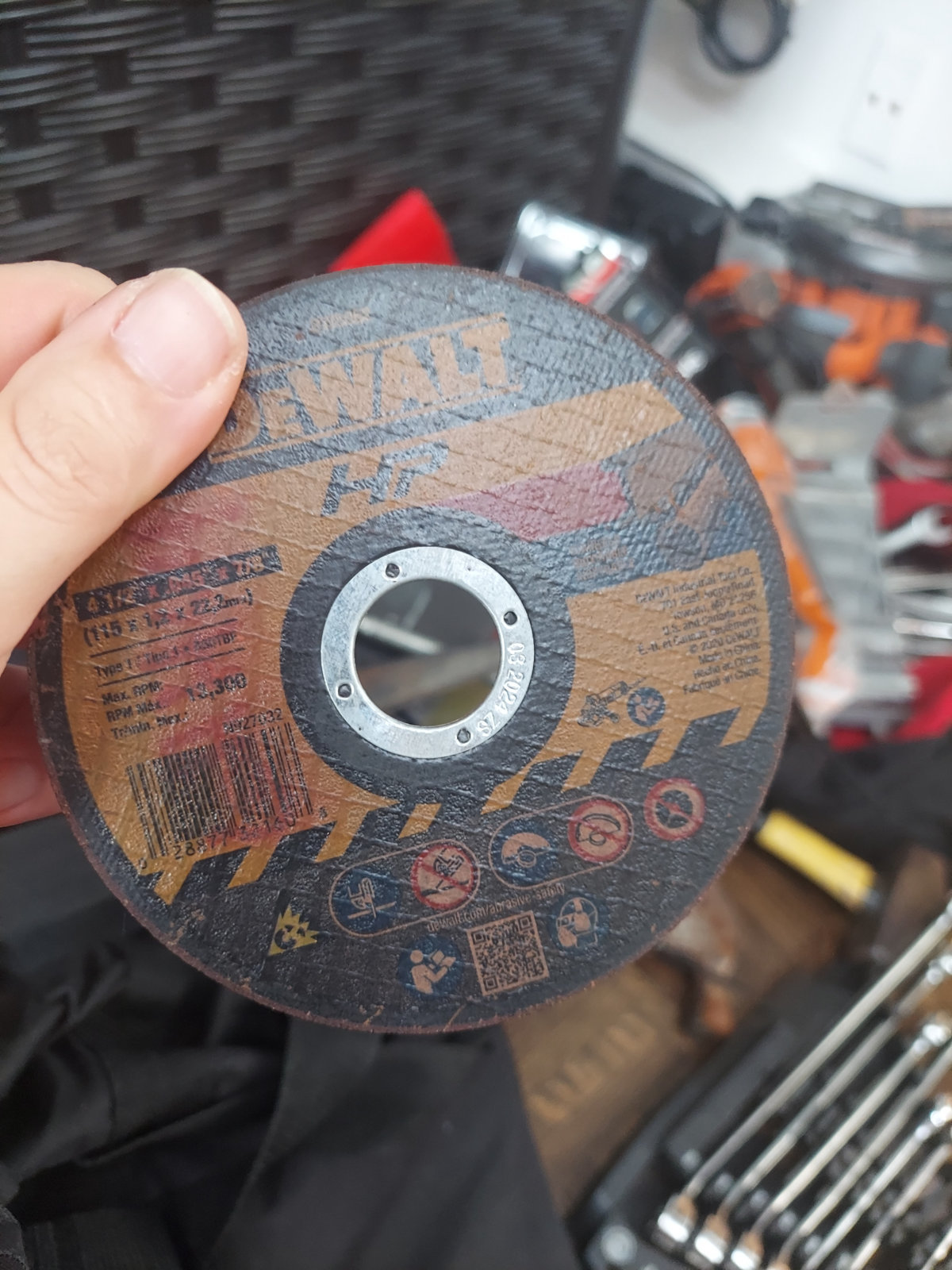

  28. Jun 25, 2024 at 1:16 PM
    #178
    BluegrapeVr6
    BluegrapeVr6 New Member
    Sep 1, 2022
    #82757
    481
    J
    02 SR5 RC Desert Sand- ARB'd 4x4
    BOSS head Unit, Track Rack, Tint. MT Baja Legend EXP 16x9, Pro-Comp 69, Icon Titanium Rebound 17x8. Cant decide on Lift. ARB Rear. Bash Fab Sliders.
    Hey i got the same kit. Everything looks good and beefy. I did opt for hd pads. How are you liking kit now after some time. I used to always stay w stock rotor and caliper but just mess w trying new pads and fluid when I tracked cars.
  29. Jun 25, 2024 at 1:20 PM
    #179
    BluegrapeVr6
    Sep 1, 2022
    #82757
    481
    J
    Planning to trim with something like this the fold bad to get rid of cut hazard
    The Black Mamba likes this.
