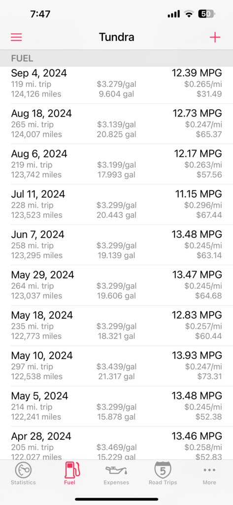

    Best I've ever seen on my 2019 Pro is 17.5 mpg. Worst is 9 mpg. Typically in the 13-15 mpg range. Yes this thing has a Genuine Cooling systems aux transmission cooler.
    By comparison...
    I picked up a 2024 suburban with 5.3 *. With or without the DFM system engaged, best I've seen is 21 mpg. Typically in the 18-19 mpg range.
    So... similar weight vehicles. One with smaller V8 and complex fuel management system (electric power steering, electric fan, 10 spd transmission, 3.23 rear gear) vs old school port fuel injected V8 with larger displacement (hydraulic power steering, mechanical fan, 6 spd, 4.30 rear gear). Same driver, same gas, same roads, same conditions, same payload while driving.
    The complexity only buys you a few MPGs. In real world driving I get 3 mpg better in a 2024 5.3 suburban than my 2019 Pro.
    One thing I did do in my 2019 that made a noticeable difference in mpg was change the rear and front differential oils to Royal Purple. I picked up a solid and calculatable 0.5 mpg. I'm not a Royal Purple homer, I expect similar results going to an Amsoil product. My local parts store happened to have RP so I tried it.
