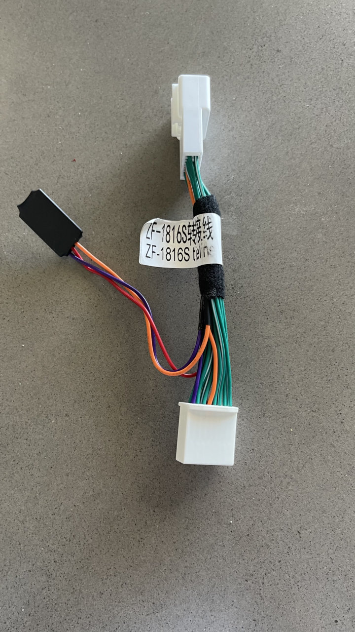

    There is a cable I cant figure out where it goes, its a 16-pin cable one side is 16-pin male and the other is a 16-pin female, and the label says “Tie Line” in Chinese. Most if the wires are straight through except for 3 of them that go to a module thats shrink wrapped. Anyone know what this cable is for?
    Edit: I figured out what the cable was for. It goes inline with the AC controls and I believe it is there to change the output of the head unit from 12v to 6v but not sure what its used for. It does connect into the input for the head unit passenger airbag light, so it could be that.

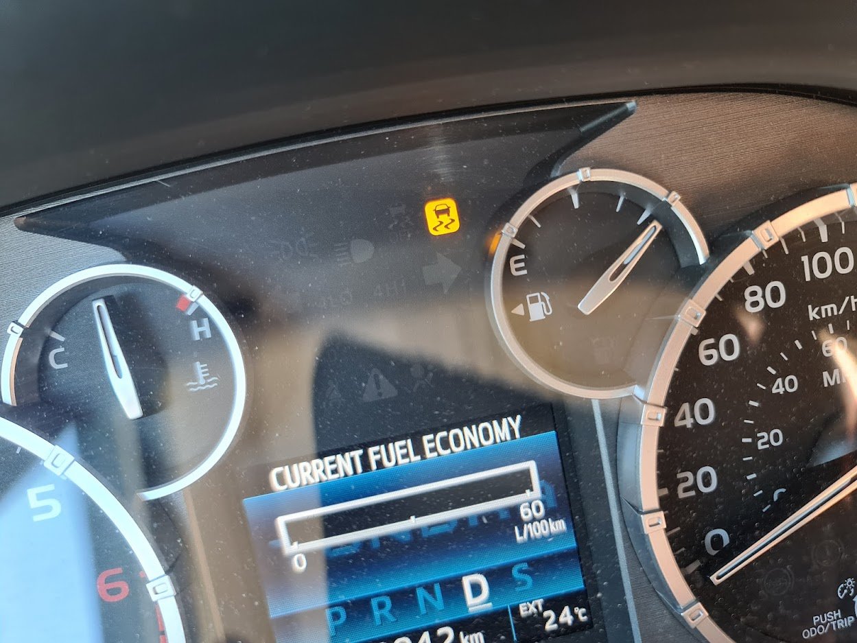

    i got a light lidup on the dash since installing the radio , anyone else ever had this problem ?
