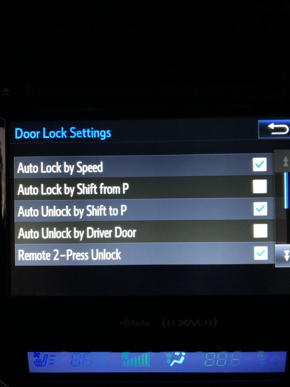

    The truck auto-locks now several seconds after turning it off (not sure exactly how long - within 15 or 20 secs or so). If you still have the doors open (like if you’re unloading groceries or something) the door chime goes off until you shut the door.
    Does anyone know if this can be disabled? Really don’t like it.

    I want to keep the auto door locks it had. When vehicle speed hits 10 mph or so, doors lock...I want to keep that one. I just don’t want this new feature of locking after turning vehicle off - I really can’t wrap my head around why Fortin would think that’s a good idea.

    How’d you disable after vehicle turned off? There wasn’t an option for that.

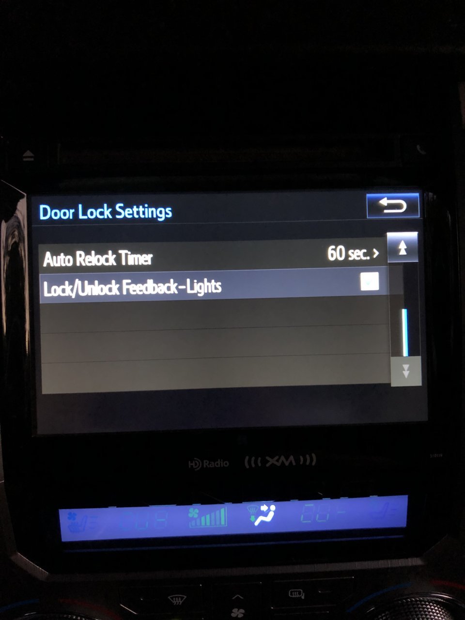

    Auto relock timer I think.

    That one relocks the doors if you don’t open them within 60 seconds of pressing unlock on fob.

    Ok I’ll try that. Thanks guys.

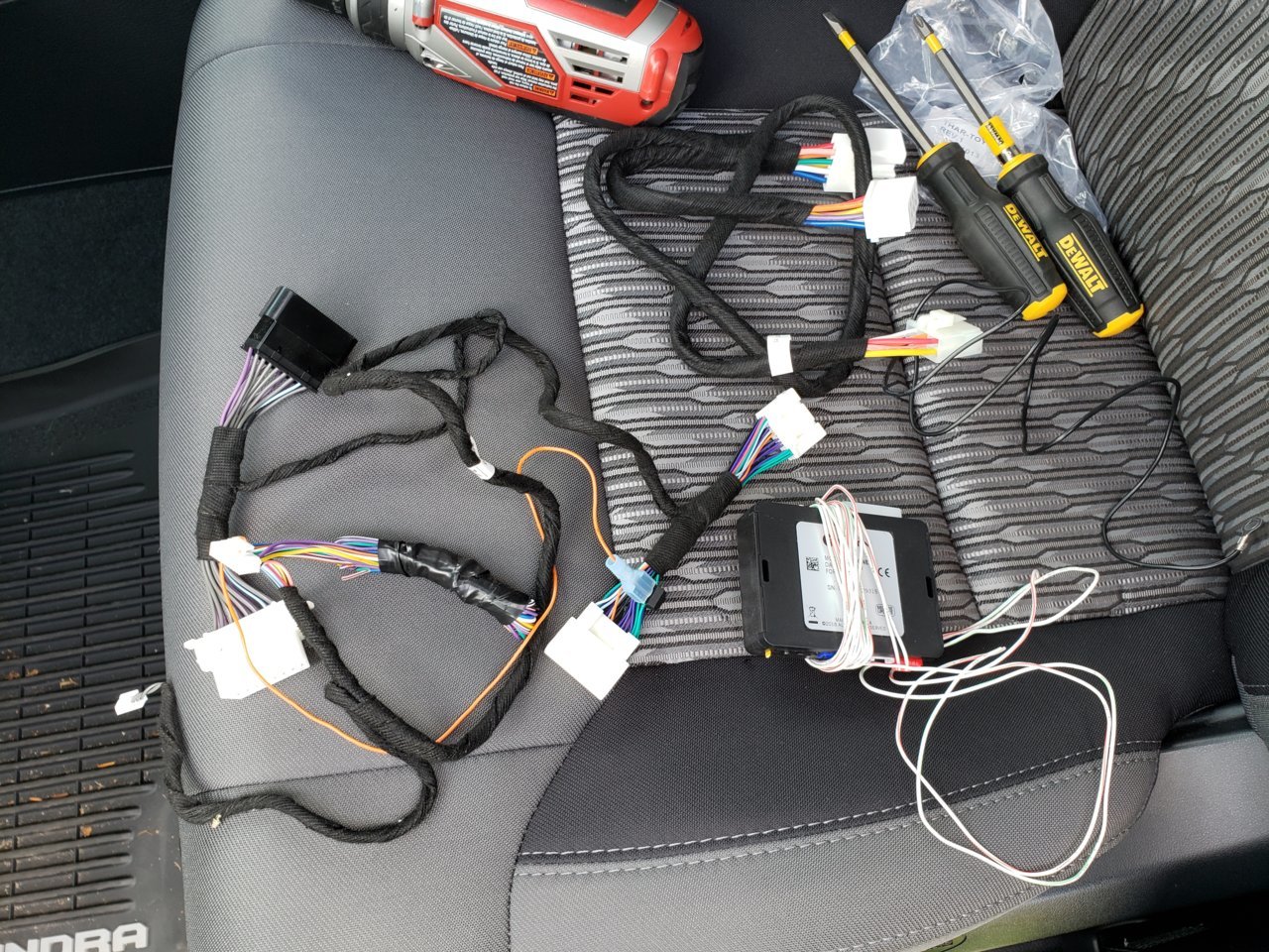

    Mine came in the mail today. Hopefully it's not raining tomorrow so I can install it.

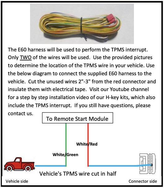

    Any help is appreciated. James is on vacation. I don't see the wires on the t harness that the wires from the box connect to. Any help?20190908_120251.jpg

    Not trying to be mean, but have you read through the instructions or watched the video that James emailed to you? There is a video for another company that offers the same kit in this thread somewhere. Look back a couple pages and you should be able to find it.
    The wires you have wrapped around the main module are for the TPMS wire splice that you'll need to do in the driver's side kick panel.

    I see it now. Just trying to make sure I cut the right wire now.

    Well cutting into a wire is a bit nerve racking but got it done and everything seems to be working just fine.

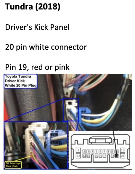

    Finally got mine installed I did have to add the extra white wire tap to relock.

    2018 install went smooth. i re-did the orange connection before i started since a few people were reporting issues. and i did end up having to connect the "white wire" with the black one in harness to get it to lock after starting. all-in-all went fairly smooth. hardest part was finding all the relevant info in this thread that's close to 700 posts now. Big thanks to @james@tech12volts and @T-Rex266 for putting this on, reading back through the posts today reminded me of all the BS you had to deal with to make this happen. THANK YOU!!!

    I have an 18 1794. Did the install on the weekend. Had to do the white wire splice to have the doors re-lock, which was not a big deal. Everything works but the only issue is when I enter the truck and insert my key, the driver seat memory doesn't adjust. Before driving I have to hit my memory button on the door to set everything back, namely the steering wheel. Anyone else?
