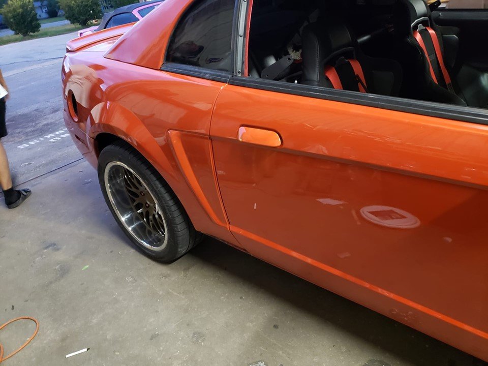

    And InfernoToyo love the color !!! Just painted it .
