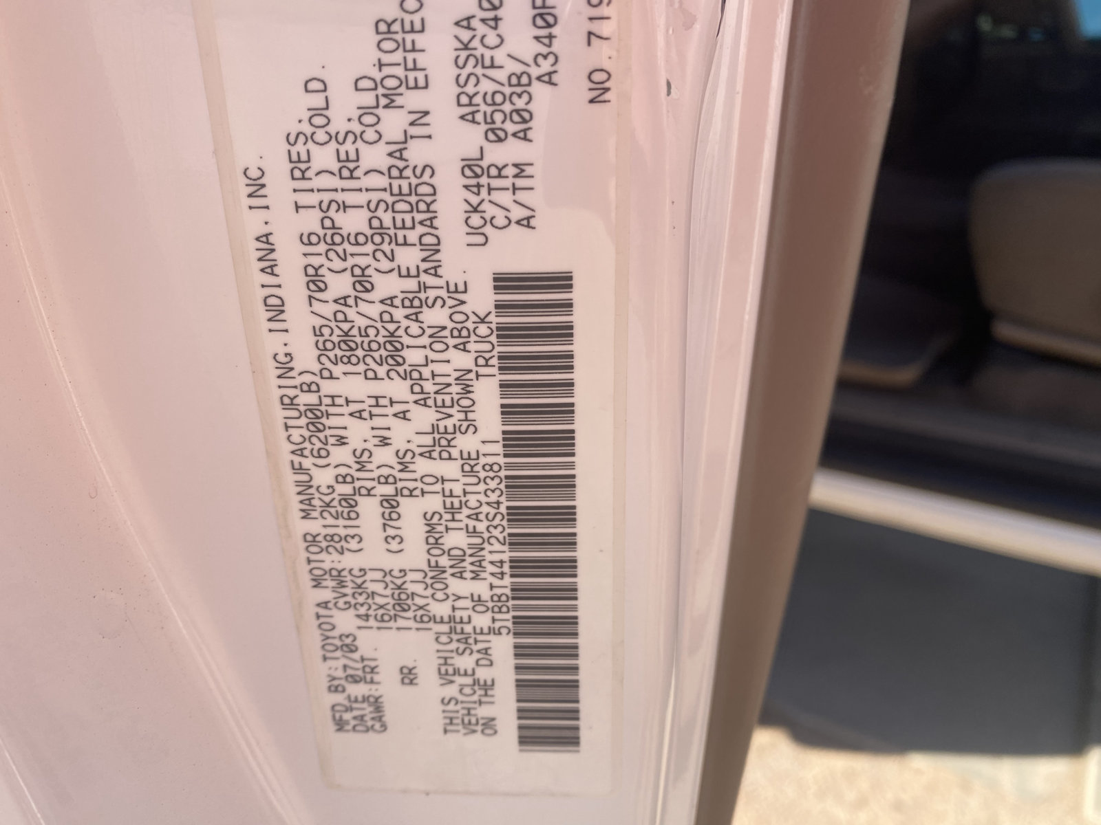

    I can't speak for the 03+ trucks but I believe that the base or SR5 trucks came with 245/70s, and Limited or TRD package trucks got the 265/70s. I believe on my window sticker it shows that the 265/70 R16s came with the TRD package. Or the Toyota website, I can't remember where. It says so somewhere though. Maybe I'll go look at my original spare.
    I could be wrong but I thought that all 00-02 trucks came with 16" wheels, and 03+ had optional 17"s.

    972
    Tempe, AZ
    2003 V8 SR5, Access Cab, 4x4, White
    Bilstein 5100s with OME 2884 springs, Firestone RideRite airbags.
    '03 come with 265/70 R16. Mine is SR5.3BA06AE1-C46D-4410-ABEF-4AB14379A262.jpg

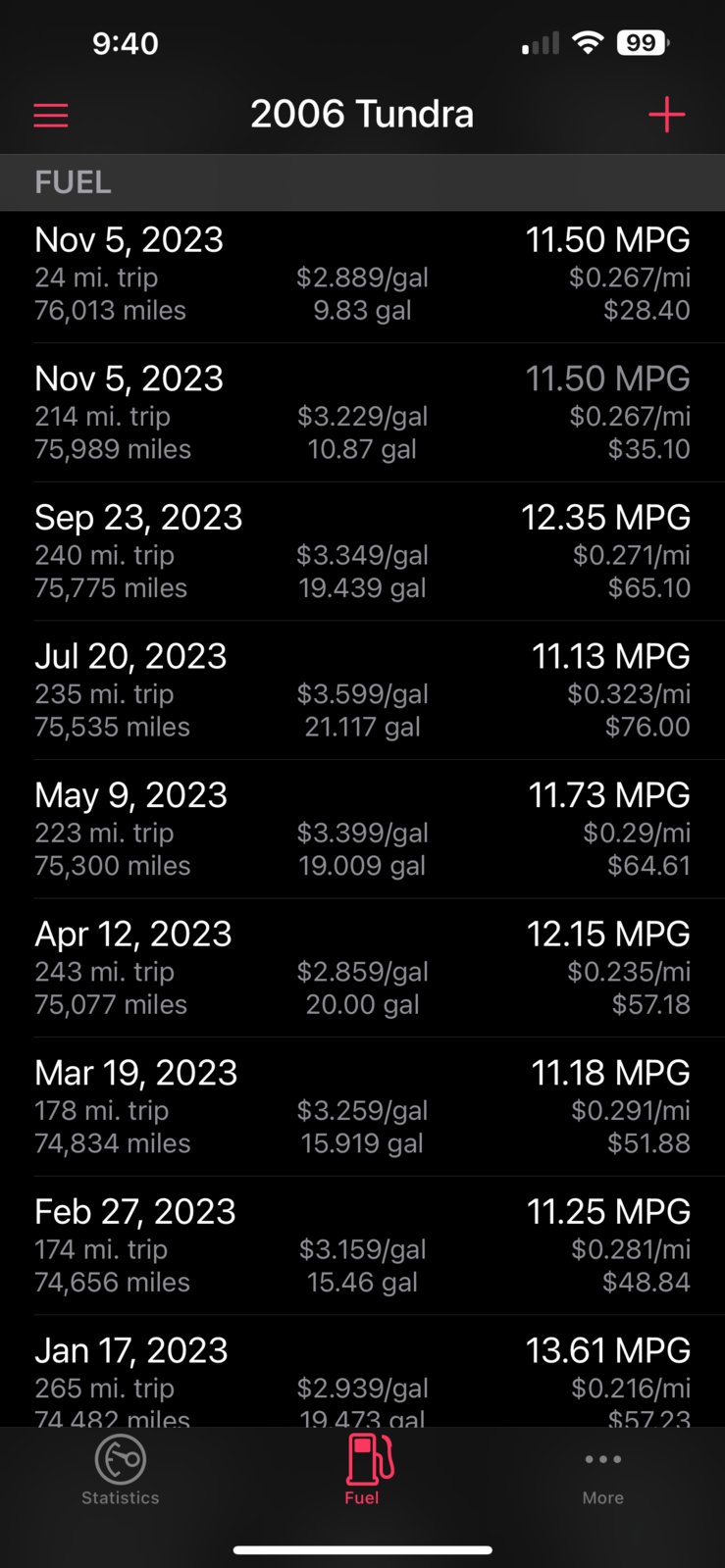

    It’s interesting, after every MPG-influencing change I’ve made, within 2-3 tanks of gas, I’m back to where I was.
    I really expected to see a more radical change in mpg back in September after lifting the truck, knowing my tire size was increasing 5% in diameter and probably 20% or more in weight.
    Assuming I’m figuring that percentage of change correctly? I’m using 100 - (oldDiameter/newDiameter), putting me at 5% change, i.e. 100 - (30.6/32.2), remembering our PEMDAS, I’m figuring my odometer is logging 5% lower miles (right?), yet … taller truck, heavier tire, logging fewer miles per tank, and more weight in the back with the cap… looking back at my 80/20 city/hwy driving, over early the entirety of 2023, I’m still in the range I’ve pretty much always been, save for some maintenance action I took here or there.
    Weird.

    @shifty` - what app are you using to track your mileage?
  8. Dec 26, 2023 at 6:26 AM
    #38
    shifty`
    Jun 20, 2020
    #48239
    31,487
    ATL
    '06 AC Limited V8/4WD
    Road Trip LE

    The non-TRD OR package early models came with 245/70/16 tires on steelies or Patricks. The TRD OR upgraded tire was a BF Goodrich Trail TA in 265/70/16 on Patricks. There was no 17" tire option on the early models.
