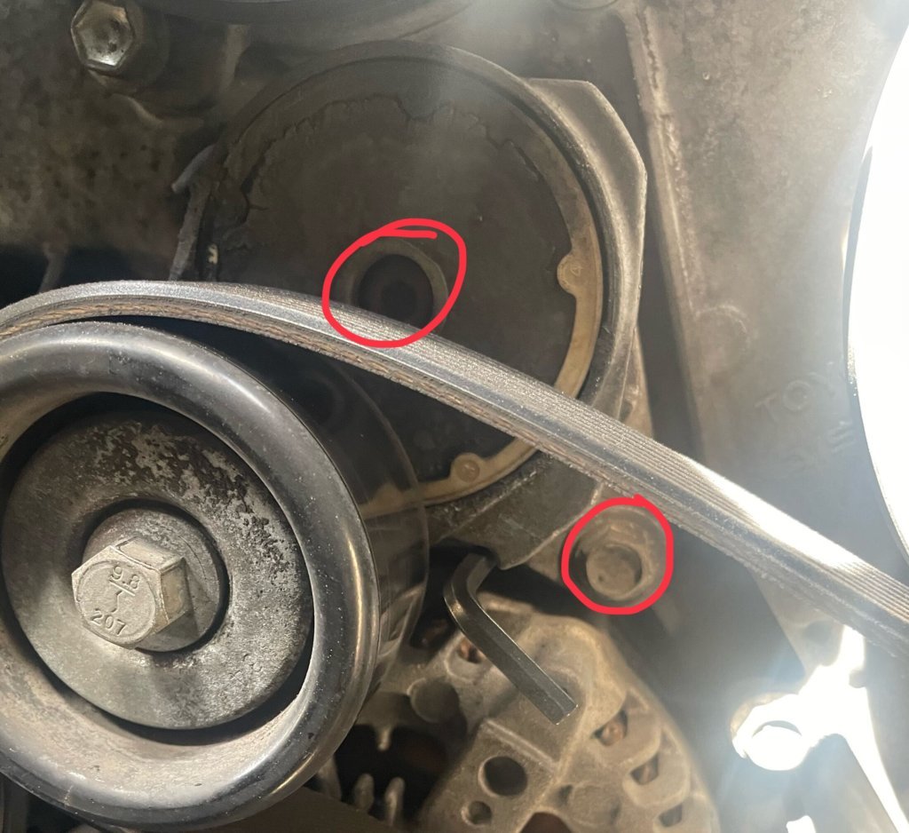

    PCV valve takes 30 seconds.
    If you’re under the truck with no skid plate in the way, you can reach a 14mm (I think) socket up and compress the tensioner spring, then stick a 5mm Allen key into the slot at the bottom to lock it open. From there, the belt swap is a 2 minute job.
    With the tensioner locked open, it’s a really easy swap. I think it’s just 14mm and 12mm bolts.
    EDIT: It’s actually the 12mm bolt and a small (10mm?) hex bolt that holds the tensioner onto the front of the engine. Circled:

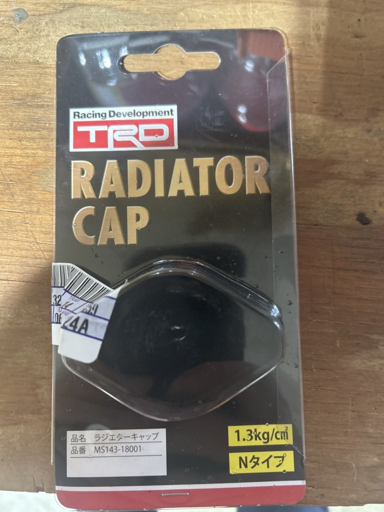

    Ordered thermostat and radiator cap. I have the reusable trd air filter and cleaned last weekend. So I will have:
    New spark plugs
    New pcv valve
    New radiator cap
    New thermostat
    New tensioner
    Will pick up new belt at dealership this week
    Not sure I want to mess with the maf sensor as I don’t want to f it up. What’s the proper cleaning process for that?

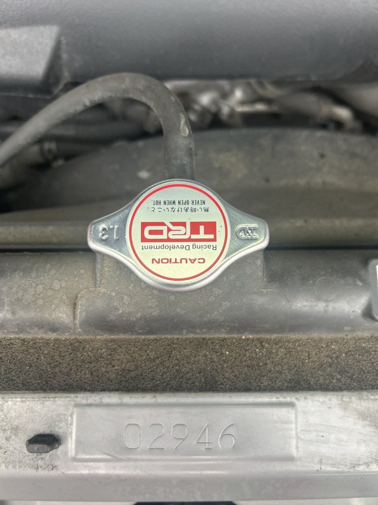

    I replaced the spark plugs; pcv valve, new radiator cap and thermostat will be here today. Those will get done this weekend. Took the truck in for a 4 wheel alignment as well to try to extend my tire life. I had the mechanic inspect the serpentine belt and tensioner while it was in - he said it looked great and there was no sign of cracking or play. I have the parts and will periodically inspect and replace when needed.

    I got the thermostat and radiator cap today. It’s raining now so I won’t tackle the thermostat until the weekend. But does this radiator cap look right? Is it oem?
