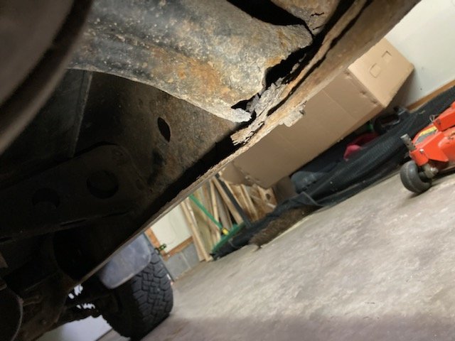

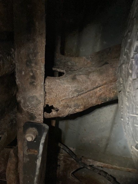

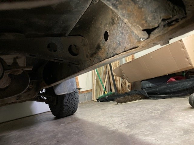

    I did read your thread but only after purchase, thats on me. Pictures show spare tire carrier and crossmember that front gas tank strap mounts too. I did search for unclaimed recalls but none outstanding.

    If I recall, it was a service campaign, not a "recall" per se, the sticky thread for frame replacement would tell you more. I believe that thread says a lot of what they're looking for is perforations, and trucks '00-'03 are applicable (or is it '00-'02?!). One of the perforation locations they check is in that spare tire area. @NickB_01TRD @Tundra2 and others have had their frames replaced. They still had to pay a grand or three out of pocket on stuff that the campaign doesn't cover, but ... really, suffer through the 8pp of this thread: https://www.tundras.com/threads/early-1st-gen-2000-2003-tundra-frame-replacement-faq.54331/
    It should tell you everything you need to know, including what to look for in the service records. If a dealership ever inspected the frame, it would've had three outcomes: (A) no rot found, no action taken (B) rot found, customer wants frame coated, or (C) rot found, customer wants replacement frame.
    Some dealerships are known to turn away frame replacements. Guys on here have chosen to go to dealerships 4-6 hours away because they'll actually inspect honestly and replace. Don't get discouraged if your nearest dealership says "no". And also ... expect them to find some things wrong you didn't expect, which will jack up your out-of-pocket a bit.

    Update: Called dealer and found out my frame has been sprayed so recall is closed. Dealer claimed if it hadn't been sprayed, whole frame replacement would still qualify under recall. All 3 cross members are still available from dealer for ~1500 total.
