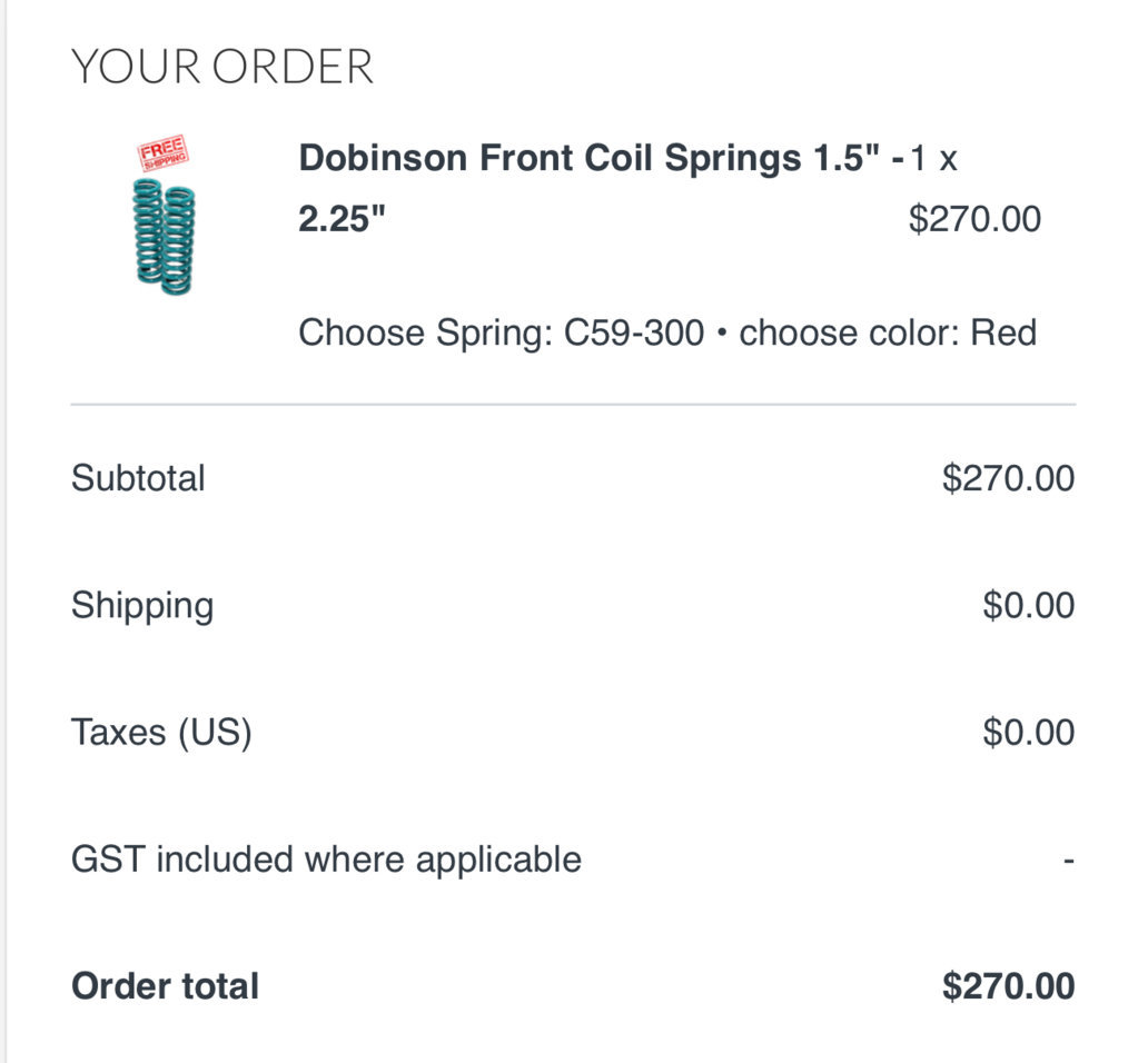

    Thanks for that! I did some searching and came across the Dobinsons C59-302 spring, which lifts 1.75 inches using the bottom ring on 5100s according to 1stgenoffroad. It is taller than the ome 2884 while also being a few pounds softer.
    This might be the spring for me. Might be as much lift as I can get with my current relatively new 5100 shocks while staying with stock ucas.

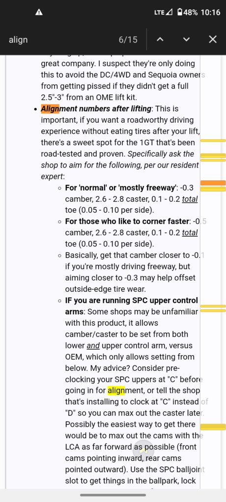

    do yourself a favor and use @assassin10000 's alignment specs.
    Those specs have been widely accepted by toyota enthusiasts for years as being the best for our lifted tundra's and at least the castor is greatly out of the factory recommendations
    and when alignment is done I would request a printout from their system showing the final numbers. I've had to go back 2 or 3 times until they got it right. Just my experience

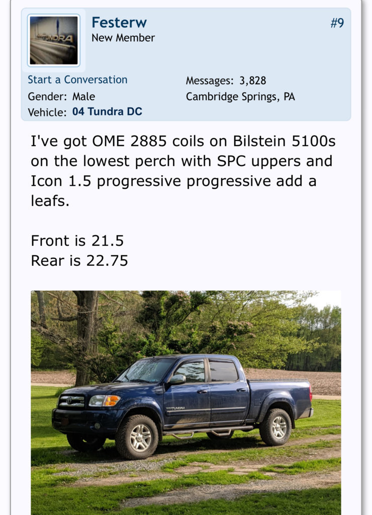

    i just measured and was at 21-1/2" on the driver side from center of hub to fender
    I can't find the thread where people posted their before and after but I dont believe I got more than an inch and a half
    Looks like more:
    KNABORES and KTM_AJ421[QUOTED] like this.

    I wish I knew where I started, but it sounds like 21-1/2 is about right because Festerw from that thread also has a double cab, 5100's on the lowest perch like me, and he is also at 21 1/2 but with the 2885's

    Are assassin10000's alignment specs the ones from the "so you just bought..." everything thread?
    Weagle[QUOTED] likes this.

    Yes sorry I could've just referred you to that post.
    I misread it when he gave them to me and thought it was only a 2.0 on the caster. Mine is OK but I can see where the 2.8 would be even better and will probably do that in the future
    Just fyi with my castor at 2.0 combined with my 32" tires/wheels and 305's i'm about to have to trim the lower front edge of the fender, which is pretty much not visible anyway. That much caster pushes the tires and wheels toward the front of the truck. If I would had this alignment to start with, I probably could've avoided modifying the pinch weld and just done the easy fender trim/grinding and been able to leave the mud flaps on. I'm gonna try to put those back on now because there shouldn't be interference
