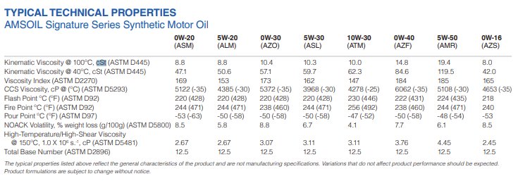

    This might help...notice how 0-20 and 5-20 have the same viscosity @ 100* C. Wont be any difference once its nice and warm. You would have to jump to 5/30 to really tell a difference
    Voto[OP] likes this.

    Looking at flash point and NOACK volatility, 10w30 is their best offer. Better base.

    Those are Amsoils numbers. Every oil brand will be different. Speaking of Amsoil SS 0W30 is thicker than 5W30.

    2019 Red SR5 DC 4x4
    Among those oils in the table 0w30 is the quickest to break down to a lower viscosity :)

    How so? I’ve seen uoa’s that prove other wise. It’s pretty sheer stable. Mobil ESP line is also another good oil.
