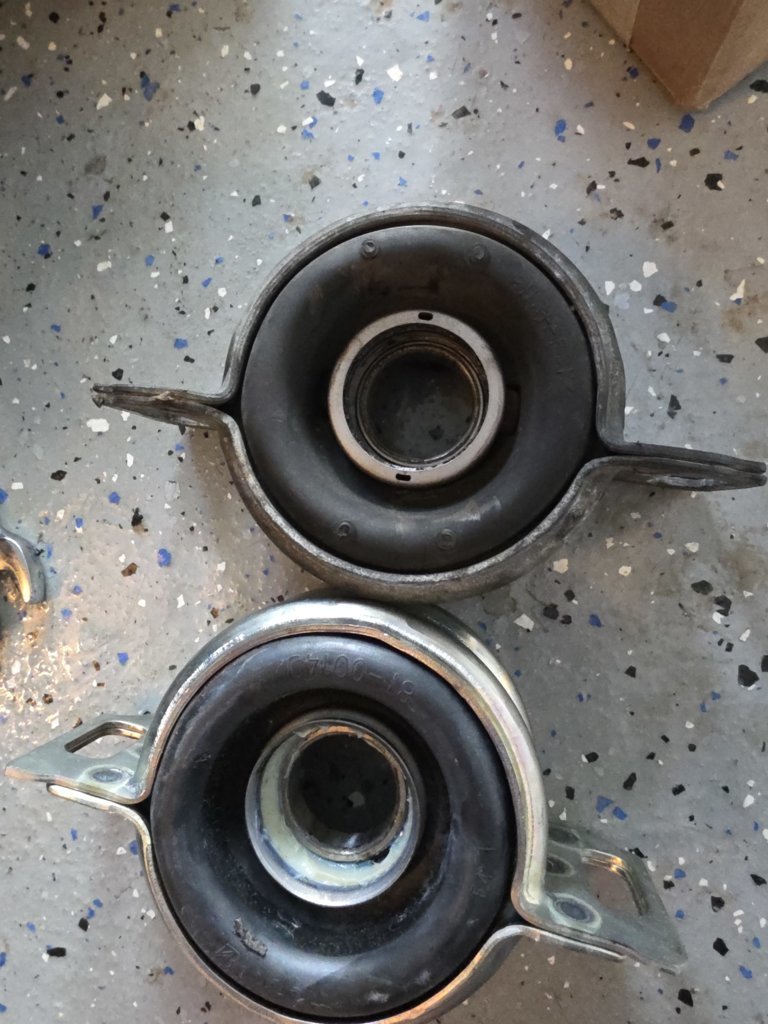

    Hey guys, I'm about to replace my carrier bearing since mine has a fair bit of play in it. Obviously I didn't want to shell out the money for a toyota bearing, since spicer makes them. So I called spicer, and they gave me the part number 211750-1X
    They told me this is a direct replacement, awesome! Only paid $66
    So I got bearing today, and it looks identical to the current one, but it has a differnt toyota part number on the bearing itself, when I search that part number, it comes up as a first gen carrier bearing. Again, it looks identical to mine. I guess I'll find out in a few weeks when I actually replace it. I also picked up 3 spicer u joints, part # 5-178X

    Just an update
    All parts numbers were correct. Carrier bearing is working great. For those interested, spicer makes 2 greasable u joints for this application, the only difference is the location of the grease zerk. The u joints I got have the zerk located on the body of the joint, the other has the zerk located on the end cap.

    Posting this for others but I have a 2017 four-wheel drive tundra and the Spicer 211750-1x is not the correct match for what's on my truck. Crazy because if I enter the vehicle information on Amazon fully it swears this is the one for my truck. Included a picture to show the difference.
