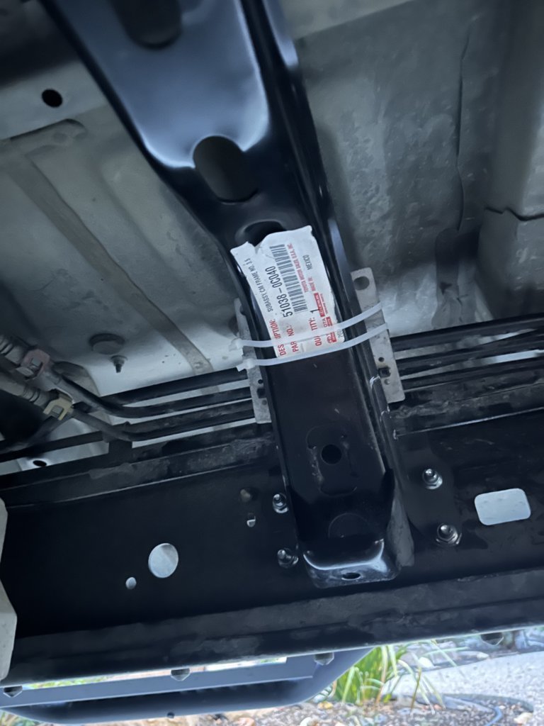

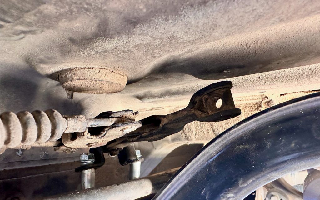

    Not entirely. The skid plate part number he listed is incorrect. I know because I bought it and it’s for the 26gal tank. I later went through the rest of this thread and found my answer on post #420
    Also, be aware that the parking brake cable will interfere with the new cross member. I had just about finished installing the new crossmember when I found that the cable interfered. Perhaps there’s an OE mount that relocates it, but I haven’t searched. This is how I got the cables to clear:

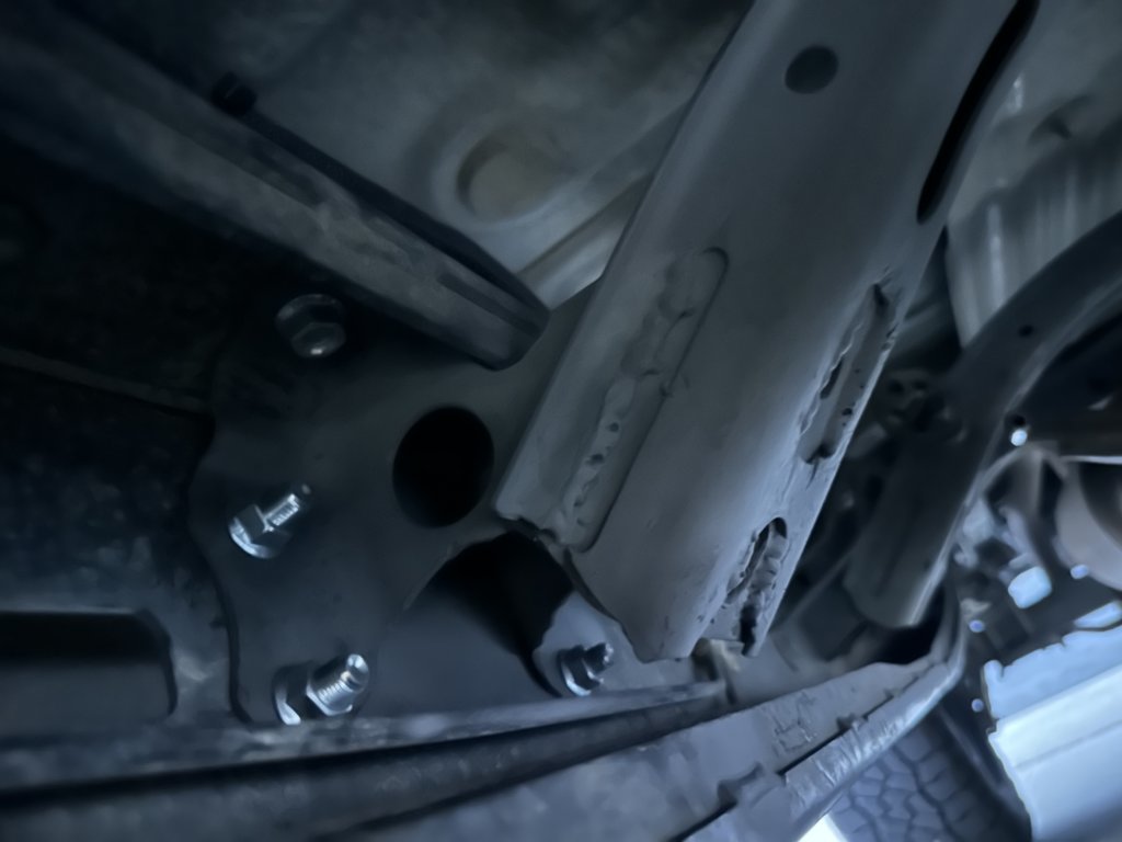

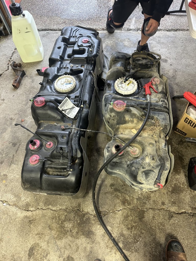

    Finished my tank swap: few things I observed during the process:
    It was easier to cut the welds on one ear of the cross member get that bolted in and then slide the other side of the cross member and weld back together in the truck. I wish I would have thought of this before notching the cross member.
    I bought a used tank that came with a fuel pump, my pump from the 26 gallon tank did not want to fit the 38 gallon tank so I went with the one it came with.
    the straps from the 26 g tank are tight but fit the 38 g tank. (RCI straps should be here in a few weeks to replace them all)
    other than that, it was really straight forward.
