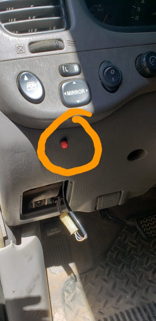

    As I parked it to start work on it the alarm started acting a fool ( I hate AM Alarms ) when I disconneted the battery. SO I chaulked it up to low battery/disconnect reset issues, then I found a little red blinking button on the left side of the dash ( yea I bet you heard this 1 before )

    My wife tells me it is to reset the alarm ... ? Why, I ask, she said that is the reason I bought it as YOU could figure it out, I asked her millage does not count here does it LOL, she says my F250 has 438xxx miles and still going ..... SO I shut up.

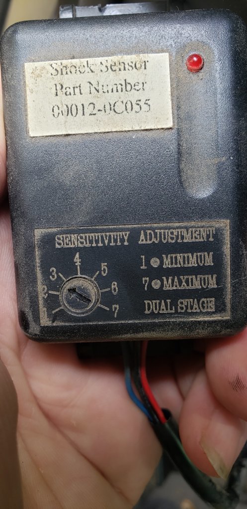

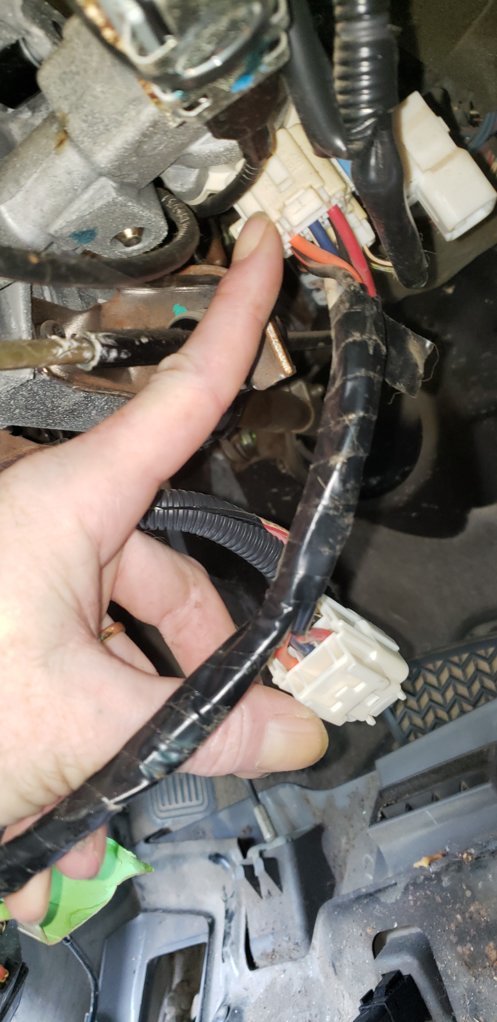

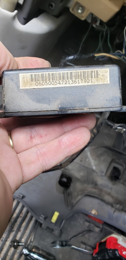

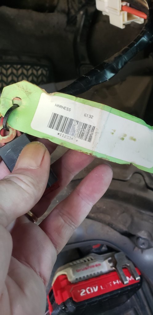

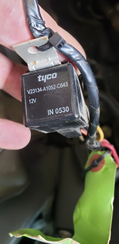

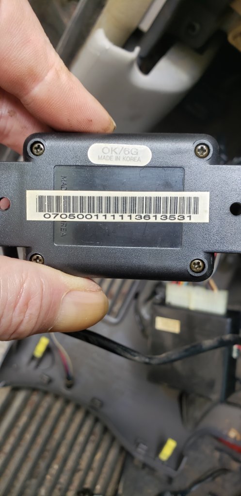

    Now for the good stuff, these are pics of the unit still installed and functional, it is a aftermarket setup so it is almost plug and play except for a few t spade wire splices ( these are further up behind the fuse block no good pic yet) .
    20250624_142938.jpg20250624_143015.jpg20250624_143037.jpg20250624_143056.jpg20250624_143117.jpg20250624_143135.jpg
    This image is of the plug and play main harness, index and thumb, I unpluged and pluged the fatory plug into the factory plug-in at ignition switch (I have a bad back and 2 vertibre broken in neck so I did not get all twisty looking :)
    I am curious to what aftermarket manufactor this setup is from as it does work, is simple to install from what I see personally.

    Ok, I was wrong. It appears it is a SECURIKEY+ system, which would've been ported by the regional entity, or the dealer. It looks almost as if that last picture, it's two of the same wire plugs, which is interesting.
    Anyway, I'm attaching the schematic. If I were you, I'd remove it fully. Aftermarket alarms tend to flake out after 10-15 years. Some last longer, but ... they're not made to OEM quality standards by any stretch.
