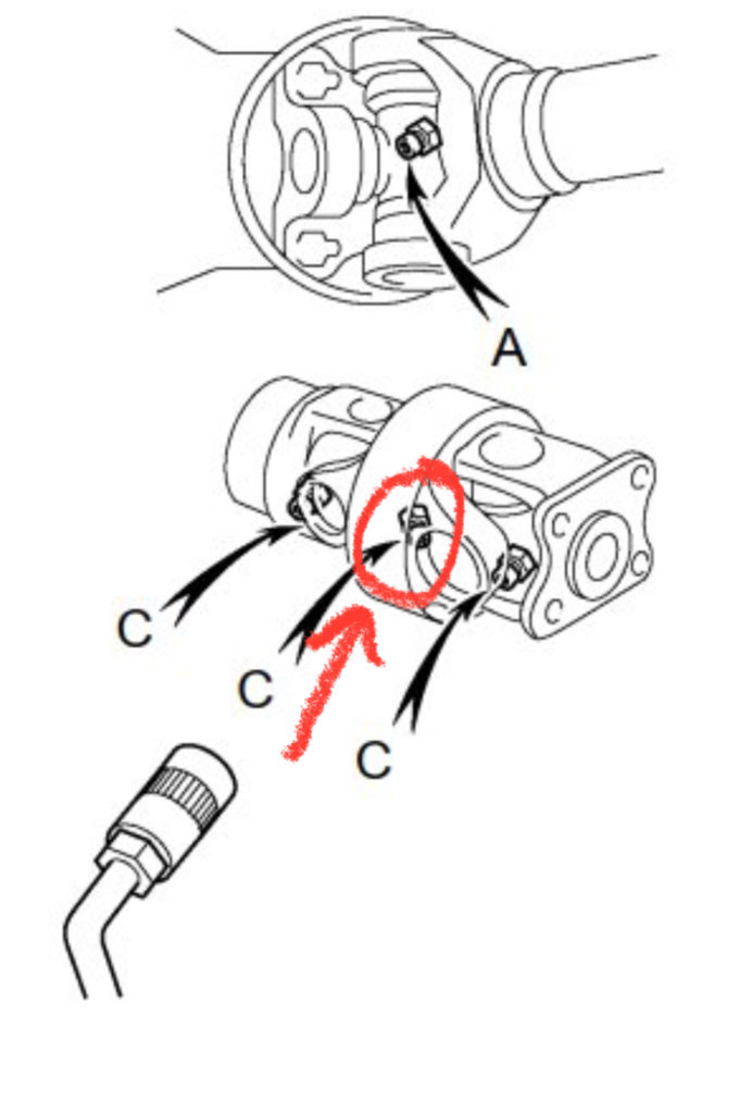

    When it comes to regreasing the zerks, should I be popping the zerk open after pumping grease in and hopping up and down on the rear of the truck for each and every zerk point (sorry if that's not what they're called)? I know I've got to do it for the rear yokes, but what about the other 6 points?

    Only the slip yoke.
    The others, grease should squeeze out from just under each cap of the u-joint. Wish I had a link to that ChrisFix u-joint video. Greatly dislike the guy, but it's great for newbs.

    I had a hell of a time trying to find a video that shows the process of a standard u-joint. But essentially, you're doing four things every time:
    1. CLEAN the zerk, wiping off thoroughly with a shopcloth is ample. You don't want to force dirt into the joint
    2. Gun should be loaded with a good moly-fortified grease like Palladium #2 or similar ... Before greasing your first joint, always test 6-8 pumps to ensure grease is coming out; airlocks can happen, where nothing will pump out of your gun, YouTube can help with solving that
    3. Then lock on the zerk and start pumping, the grease should disappear into the joint
    4. With every zerk except the slip yoke (#B in your picture), continue pumping until you see grease exiting around the perimeter/base of the 4 round caps** then wipe up all the excess grease so it doesn't sling all over everything, including yoru exhaust, which may stink later
    ** You should be greasing roughly every oil change; If you haven't greased in 10k+ miles, I'd continue pumping until you see new grease coming out of the base of the caps. Otherwise, pumping until you see about a teaspoon or so of fresh grease is genuinely enough.

    Greasing these u-joints. Are there 8 different zerks to shoot grease into? I didn't see that many when I initially checked it out, but they could have been hidden

    See the picture you posted. There will be a zerk at each of those locations, four at "A", three at "B", and one at "C". If you don't immediately see it, it may be rotated out of sight 180°.

    Maybe I'm confused by this photo... but it looks like 4 A's in total, spread out along the shaft, then 1 B, and 3 C's in the middle

    Yeah I got my Bs and Cs backwards, but I'm moderately dyslexic so it's expected.
    It's like the J5 sang it, A-C-B, it's easy as 2-1-3...
