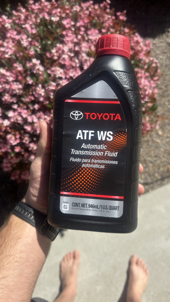

    What type fluid did you buy?

    Wrong link sent - here's what I got from the dealership. ATF WS Fluid. Ignore the feet, unless that's your thing...
