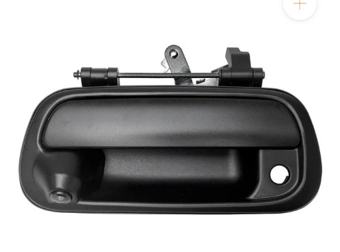

  30. Apr 11, 2020 at 5:28 AM
    #120
    speedtre
    speedtre New Member
    Jan 20, 2019
    #24808
    1,699
    Inland Northwest
    2006 BSM Toyota Tundra DC TRD 4x4
    It's not the cleanest way to go and you can replicate it with 10 minutes work and less than $60 with a brand new handle and a good camera (or your current handle for $40). There is a cleaner option, but too rich for me...let me see if I can find it....found it....this one is $144 with "10OFF" coupon till 4/15
    https://www.mastertailgaters.com/pr...zVzd162yooTuobJIIFyliToz8O37ctGMaAsVdEALw_wcB
