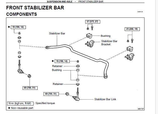

    I found the solenoid so for 125 bucks I'm replacing it to see if it fixes my "reverse only" before buying a new transmission. Can't replace it without dropping the pan. I highlighted my two problem areas that are keeping me from getting clearance. There are also some solid brake lines but they flex just enough to clear without worrying me.

  29. Oct 15, 2023 at 12:35 PM
    #29
    shifty`
    shifty` I'm having daydreams about night things
    Jun 20, 2020
    #48239
    28,508
    ATL
    '06 AC Limited V8/4WD
    Got it.
    Pull the sway bar (stabilizer bar). It's non-essential and you can live without it for days or weeks if you want. It just stiffens the front end. You may be able to get away with just pulling the four clamp boots loose. If not, pop off the top nut on the swaybar link, which is usually easier to do with the truck on the ground IMHO, but if on jack stands already, you can also use the OEM bottle jack to lift the LCA enough that there's no tension on the swaybar link.

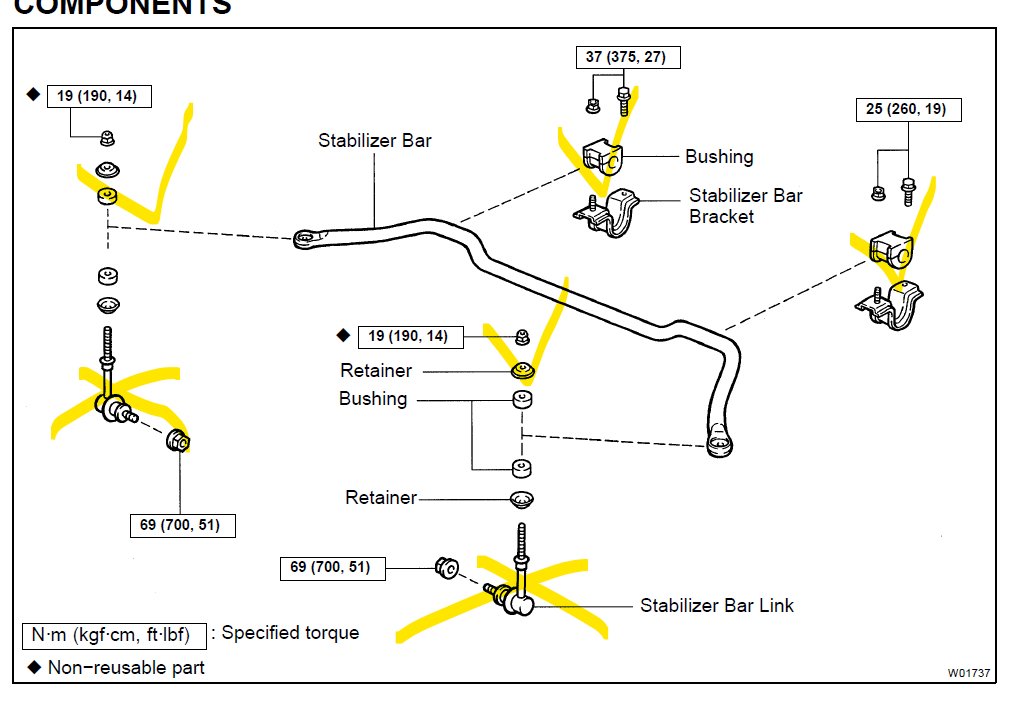

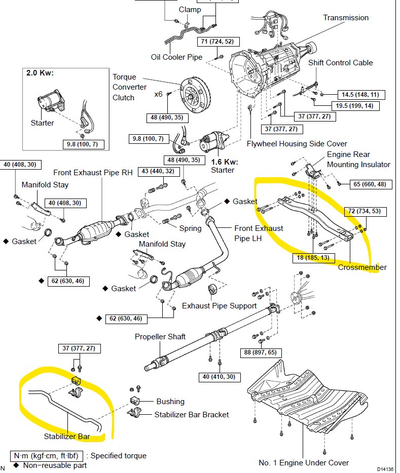

  30. Oct 15, 2023 at 12:43 PM
    #30
    manshack_one
    manshack_one [OP] New Member
    Apr 24, 2023
    #95993
    28
    2005 Tundra SR5 V6 4x2
    Just so we're on the same page I put yellow check marks on the parts I think you're saying are ok to remove and yellow x's on the ones to leave in place. I wouldn't drive it around without out so this is just a temporary drop so I can get that pan out. So do I have the checks in the right spots to do this safely while I'm under the vehicle? I have the front tires just up on ramps (had enough clearance to drive in reverse up onto the ramps since I have no forward gears at all right now). There are no jacks under it right now at all. Just up on ramps. Safety first. :)
