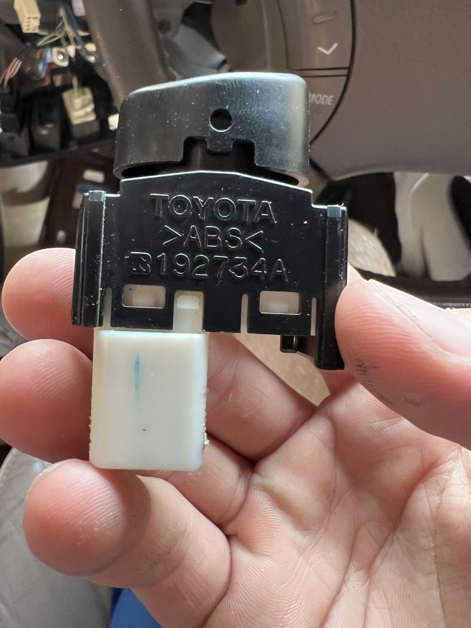

    Not sure if you got this figured out, but I just fixed my dads 04 AC rear window. The switch worked intermittently, but not consistently. Popped off the trim panel to the left of the steering wheel, removed the window switch and cleaned the rocker contacts (not the harness contacts). The contacts directly below the switch, not the wire connections. Be careful when removing the switch, but once it’s out just use a QTIP with some brake cleaner and get the contacts nice and clean. Reassemble and it’ll likely solve your problem. The easier solution is just purchasing the part on Amazon, but this was more fulfilling for me.

    If you want an authentic part, never purchase on scAmazon or fleaBay. :D
    Thanks for updating on this. CRC contact cleaner would probably work also.
