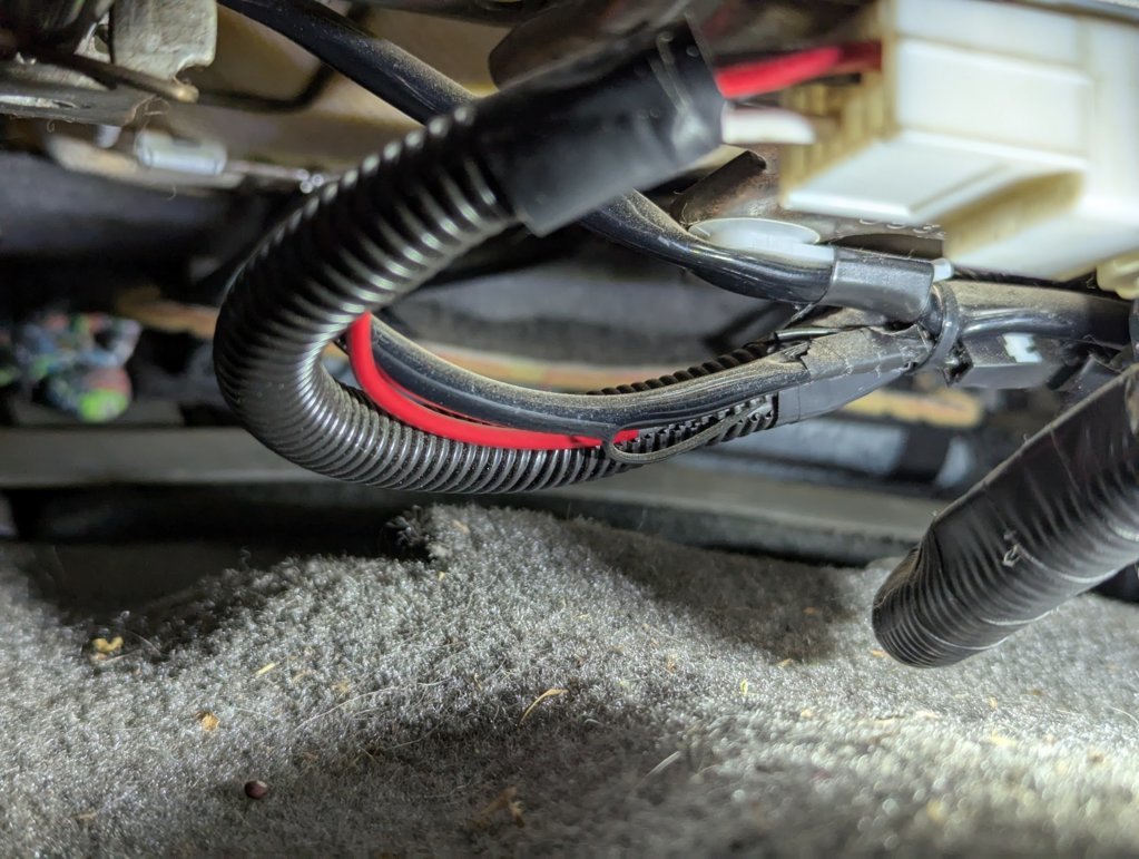

    I'm in the thick of the wiring saga. I too, have two wire pads and I think I'll just follow the PDF as instructed and things will turn out with a hi and low. Everything is IN the seat. My ONLY question is... I hate cutting factory wiring.. How did you keep the seatbelt ground in pin #3 AND add one additional wire to Pin #3 from the heat pad?

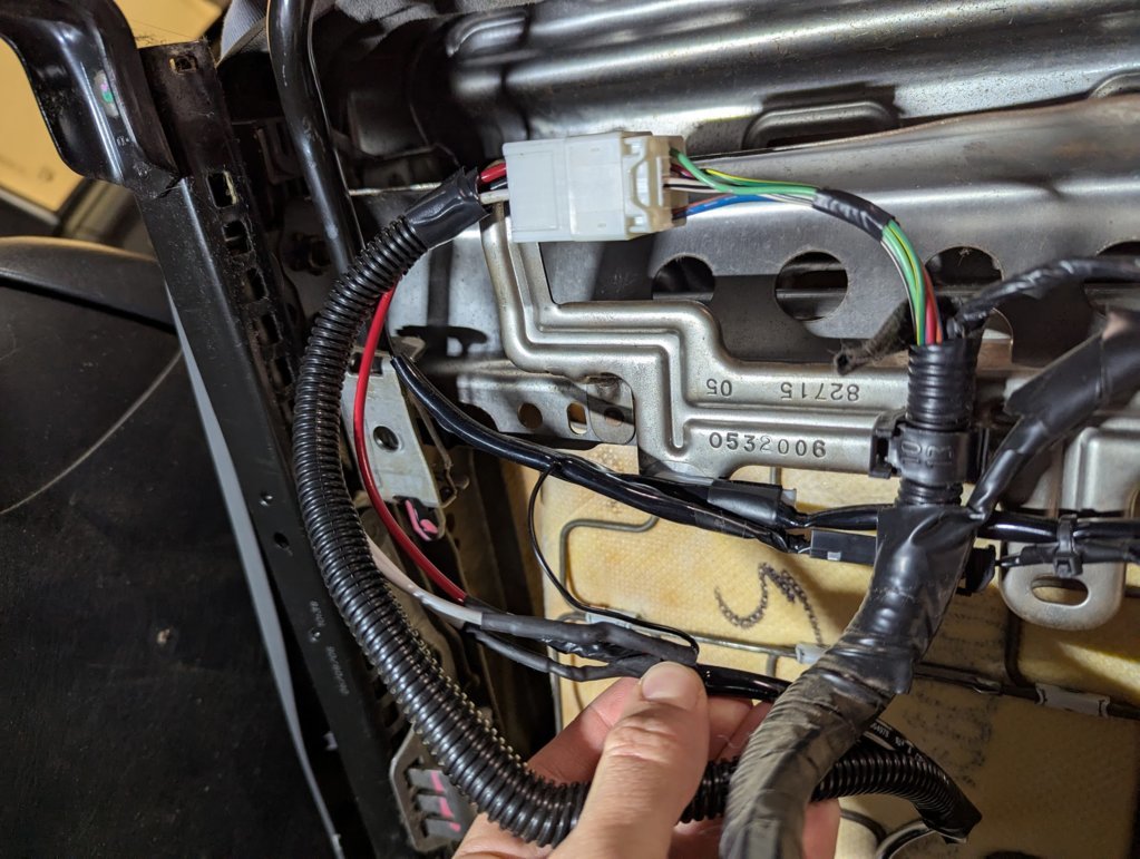

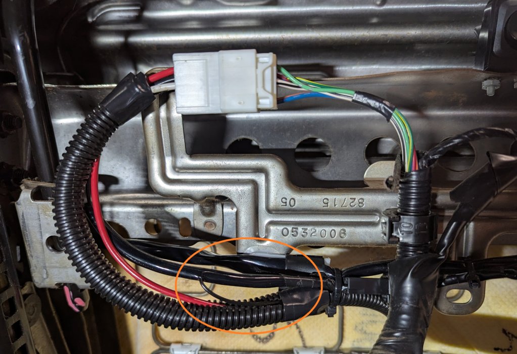

    Sorry I am taking so long, I unbolted the seat to make sure I got you some decent pictures. First picture with the orange circle shows the jump from seatbelt to heated seat harness, and is how I have it all buttoned up under the truck. Second picture, I took the zip tie and tape off.
    The black wire is coming out of the seatbelt harness, I just brought it around into the heated seat harness. I think I did this on my bench without considering how the harnesses runs under the seat. Maybe you splice it in a different place, or on the other side of the splice, and it may lay nicer. I think all of my connections are soldered with heat shrink, as opposed to just crimping butt splices - they aren't as good. Hope this helps.
