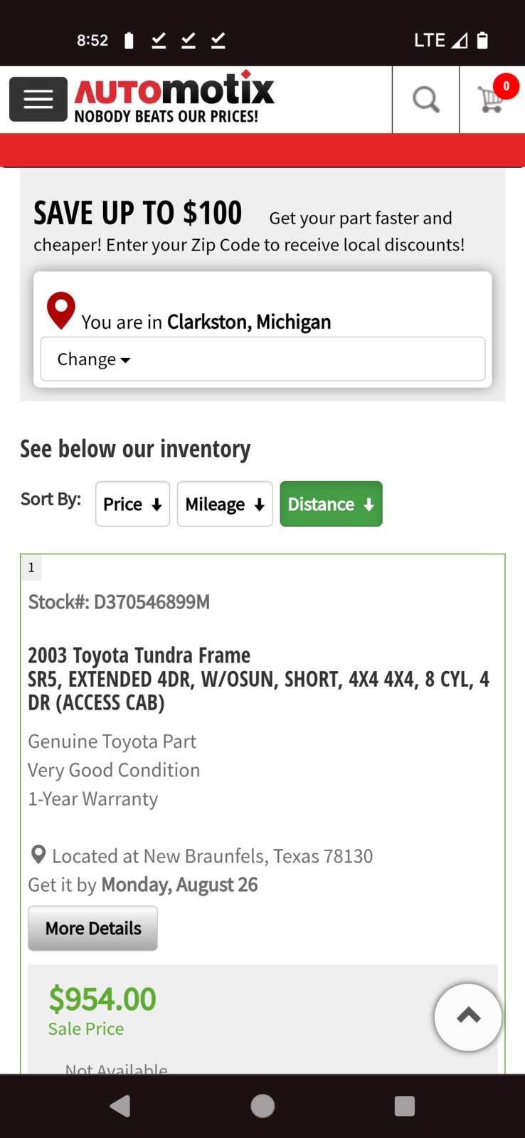

    appreciate the input. Just curious. Where did you get the frame from?

  5. Aug 7, 2024 at 3:23 PM
    #35
    MI_Treetaco
    MI_Treetaco New Member
    Dec 8, 2022
    #88113
    59
    99 Tacoma trustyboy, 06 Tundra rustyboy
    I eventually found one in good condition on FB marketplace, not too far away. Before that I was looking at car-part and LKQ nationally. Saw promising options there, but hard to tell condition as clearly on those.
    BTW, saw the other day that Upullandsave in Pontiac just got a 2002 Tundra in the yard. Haven't been to check it out yet but might be worth looking.

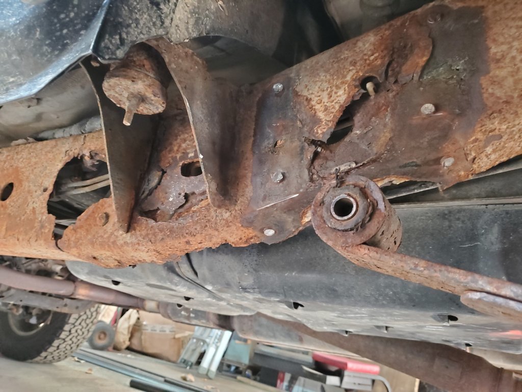

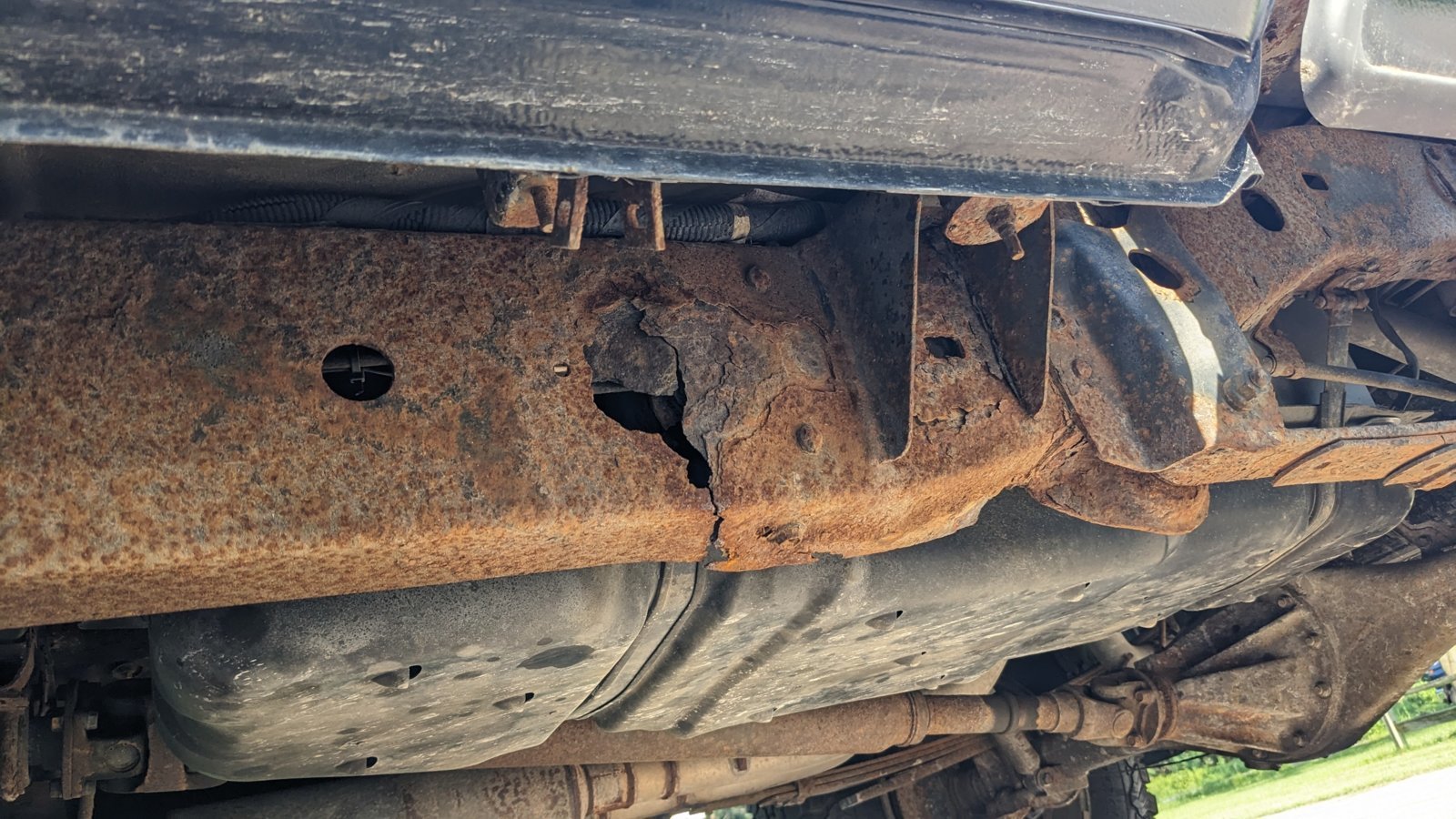

    Quick update:
    I spoke to a couple collision shops and a trailer/frame shop. No luck there.
    I called one welder who has good reviews near by. Sent him some pictures of the frame damage. He said he has dealt with similar looking frames before and said he would be willing to work on it.
    I spoke to another welder and he said he knew of some places that would swap out the frame if I ended up getting a new one.
    So sounds like I might have a few options just gotta call and figure out what they want to charge for something like that.
    One question though looking online at these frames, I put in the year, make, model, engine size and 4 wheel drive and it gives me some matches. The only thing off is they says "SR5" and mine is not a SR5 it's a "limited". Should that make a difference?

    Limited or SR5 won't matter for the frame. As long as engine, trans, cab and drive type match, you're golden.

    Yeah, like KNABORES said, just make sure that you get the same engine/trans/drive combo as your truck. The base frames are the same, but the motor mounts are different for the V6 and V8, and 2wd has the trans crossmember in a different place vs the 4wd.

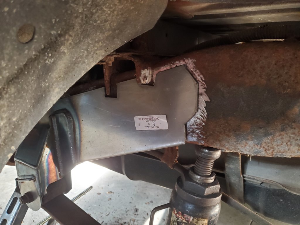

    2003 Toyota tundra limited access cab
    Found a local guy who is going to try to tackle it. He's been welding for 30 years and says he has "worked on and seen worse"...
    :welder:
    So that's promising, I guess. I'll update with images and info as I get it. thanks

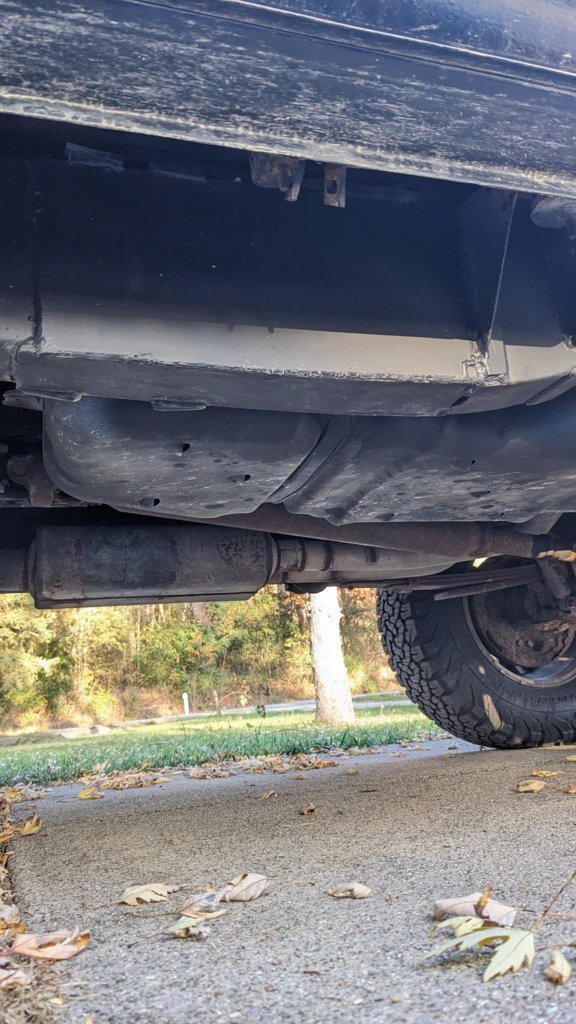

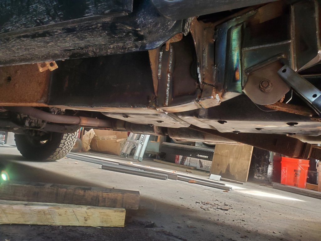

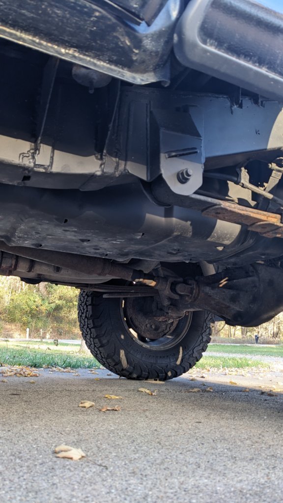

  15. Oct 26, 2024 at 2:58 PM
    #45
    Mack88
    Mack88 [OP] New Member
    Aug 4, 2024
    #120849
    14
    Here's the before and after. I'm quite pleased with it. Ended up welding a C frame over the top of the existing damage as well a safe-t-cap behind it.

    That’s great news Mack. Congrats!!! Now get some Fluid Film on her or some other such undercoating and reaply every year. Miserable frigging job but soooo necessary for our old trucks if you live in the rust belt.

  18. Oct 27, 2024 at 8:09 AM
    #48
    Mr Badwrench
    Mr Badwrench New Member
    Jul 20, 2018
    #17205
    1,400
    300 hectares on single tank of kerosene
    That turned out good. That was probably a better bet than having to strip everything off and reattach to a new frame, could really open a can of worms with that with the unexpected stuff. But if Toyota offered to do it, hell yeah, I'd throw them the keys and say 'have at it', doesn't sound like that was an option in this case.

  19. Oct 27, 2024 at 4:40 PM
    #49
    shifty`
    shifty` I'm having daydreams about night things
    Jun 20, 2020
    #48239
    28,438
    ATL
    '06 AC Limited V8/4WD
    Work looks stout, wish Toyota built it like that from the factory. It looks like you may be missing the plastic round spacers at the end of each leaf spring. That's what the hole is for in the end of each individual leaf - to hold a little plastic disk with a center post (center post goes in the hole). If you find you're squeaking like a MFer out back, or clunking over bumps out back, that is most likely your issue.
