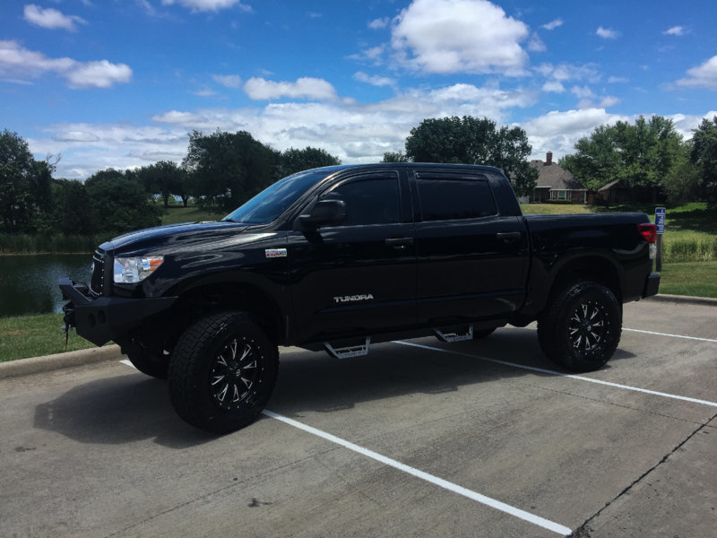

      This is without a doubt the best looking Tundra I have ever seen. Great job!!!
      JTP likes this.
    • JTP
      Thank you. She's pretty sweet and we get a lot of looks for sure. Very Blessed to have it for sure.

      Do you mind me asking how much lift you have? What size wheels and tires? I have 3"/2" lift. I've been reading for days trying to figure out how much tire I can get under mine without cutting anything. The more I read the more confused I get. The offset really puzzles me. Again, super sweet ride you have. I'm jealous lol.
      JTP likes this.
    • JTP
      @Munk
      Im running a 7" Rough Country lift.
      20" wheels.
      Offset is the SAME AS STOCK WHEELS
      Tires are 37 X 12.5 R20 Nitto Terra Grapplers
      This all BARLEY FIT UNDER A STOCK BUMPER. It will RUB on occasion with a stock bumper.
      My front bumper is a ICI Magnum which the tires do clear.
      I AM NOW HAVING TO GO WITH 4:88 GEARS (FRONT AND REAR BECAUSE I AM 4X4) GOING UP TO THE 37' TIRES
      IF YOU WANT TO GO WIDER ON TIRES YOU ARE GOING TO START JACKING WITH THE WHELL OFFSET WHICH IN TURNS WEARS OUT YOUR FRONT END AND BEARINGS FASTER. YOU WILL ALSO HAVE TO START CUTTING ON THE FRONT BODY MOUNTS OF TRUCK GOING WITH WIDER TIRES
      I went with TALLER TIRES< NOT WIDER and have not had to cut on the truck.
      WIDER TIRES = CUTTING ON TRUCK
      THESE 12.5'S STILL LOOK PRETTY MEATY FROM THE FRONT AND FROM BEHIND
      TALLER LOOKS EVEN BETTER FROM THE SIDE
