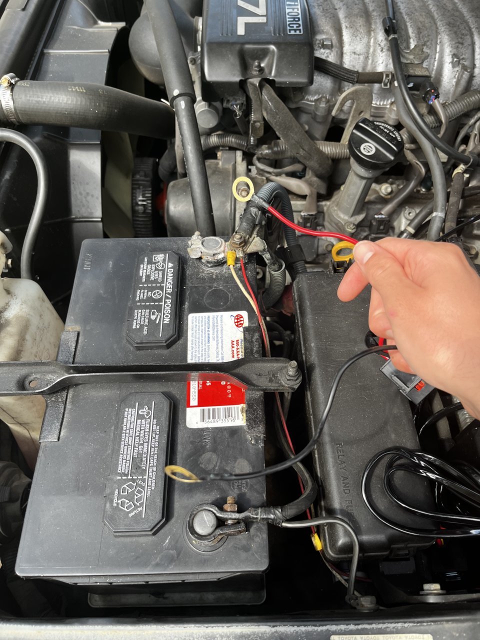

Quinn2002T4.7, Sep 25, 2023
    • bfunke
      Picture appears you have some corrosion on the positive battery post/terminal. Loosend it and wipe it clean then put a little grease on the post. Tap it on securely and tighten the 10mm nut. Try that first.
