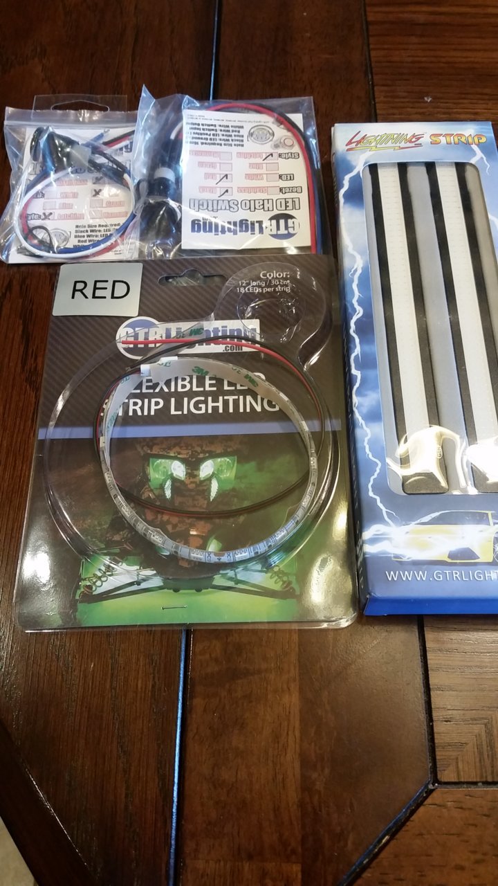

GTR Lighting LED strip and button
710
27 Jul 2018

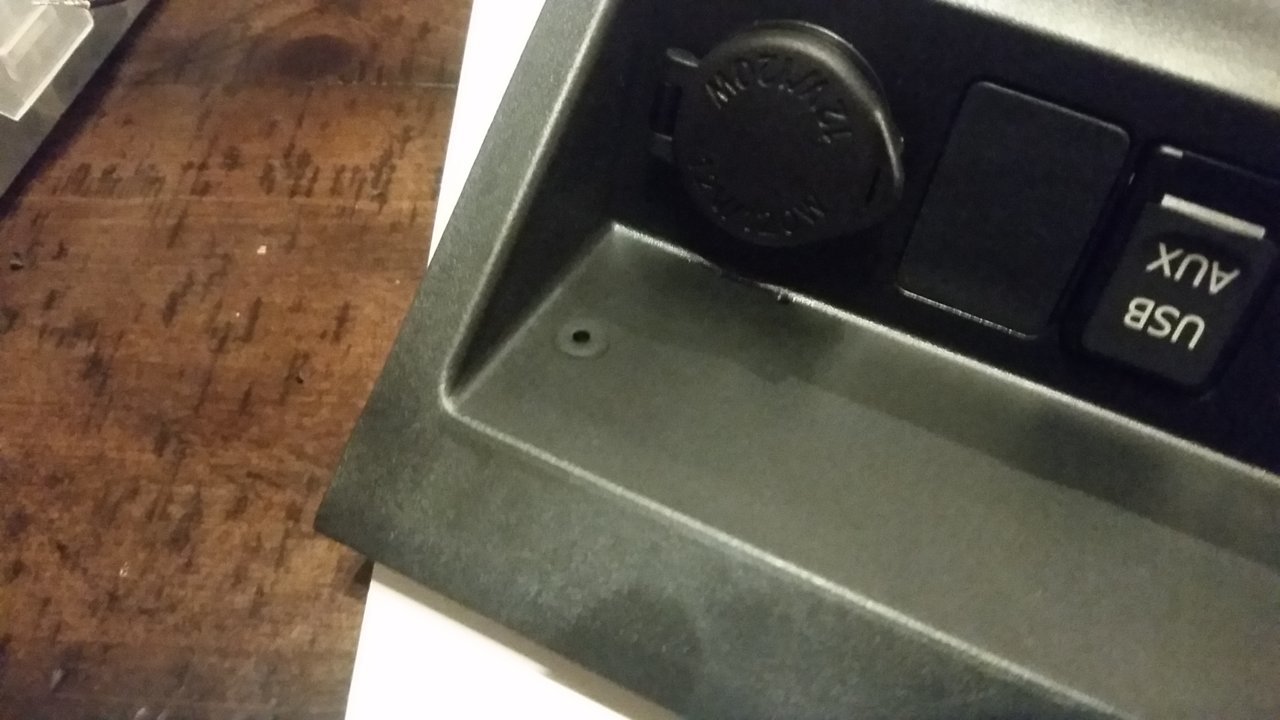

Small hole for wires
746
27 Jul 2018

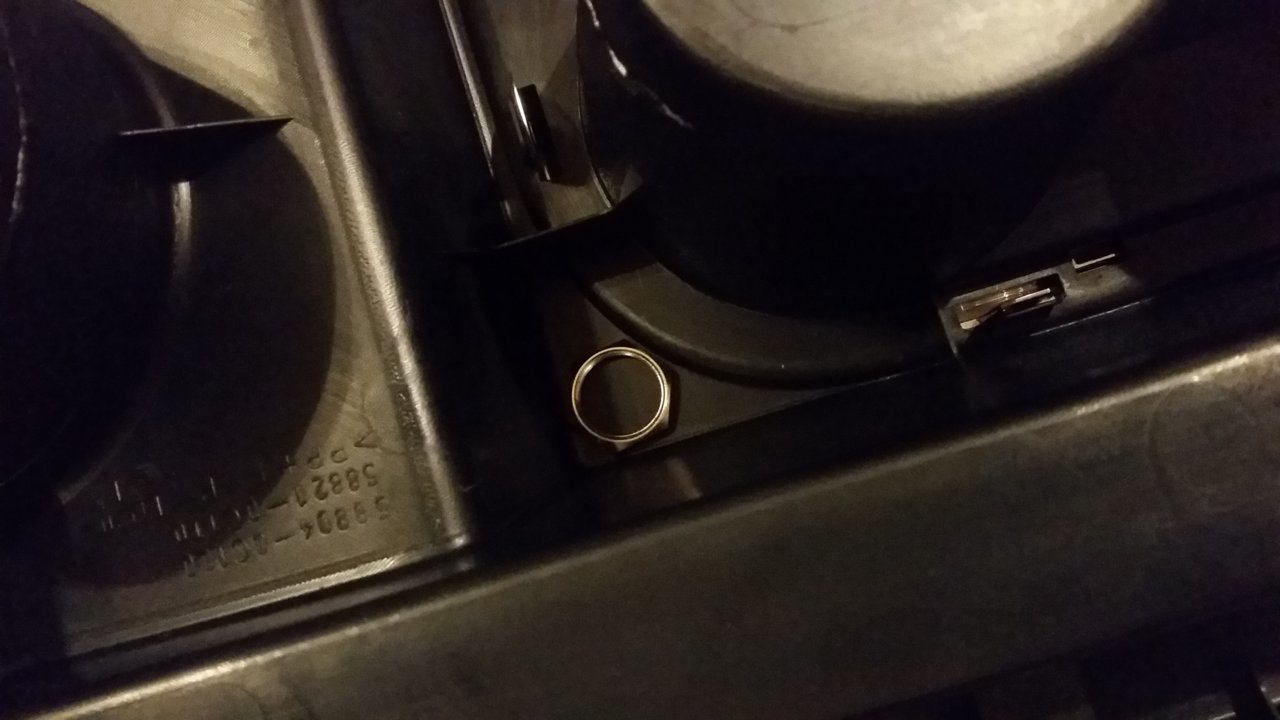

Rubber grommet added
734
27 Jul 2018

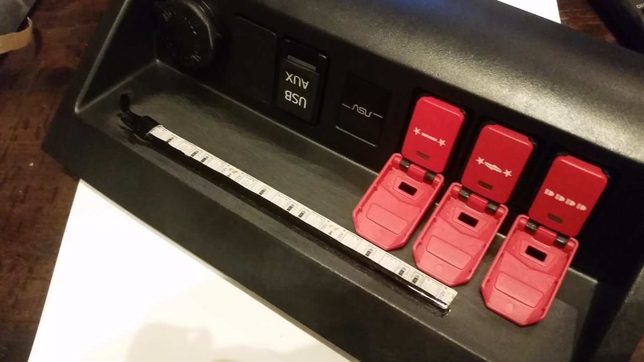

Panel sanded to help LED strip stick
761
27 Jul 2018

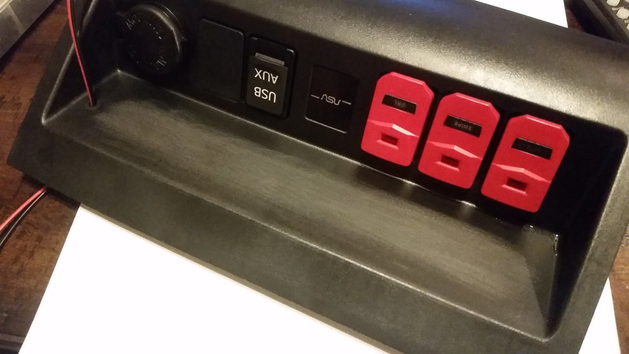

LED strip fitted, attached and front painted to reduce glare
716
27 Jul 2018

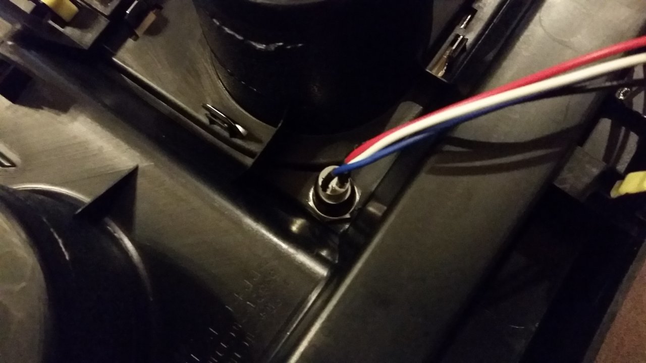

Button nut fitted for hole placement
706
27 Jul 2018

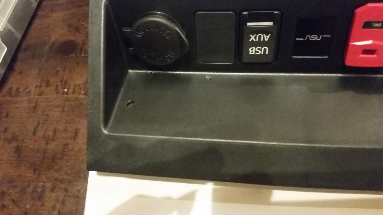

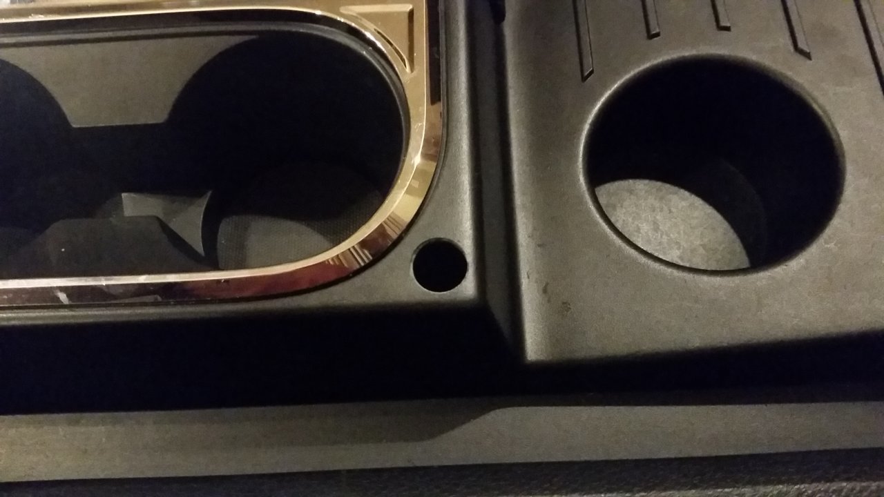

Hole for button drilled
737
27 Jul 2018

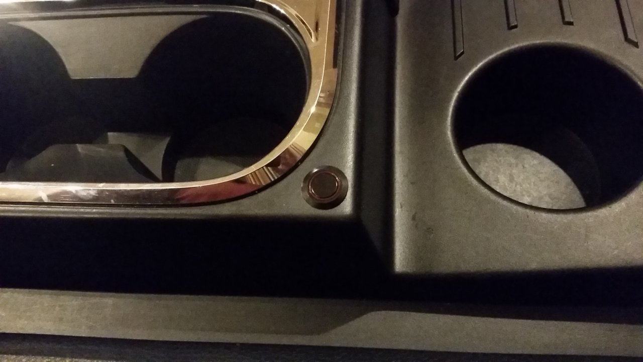

Button installed (bottom)
734
27 Jul 2018

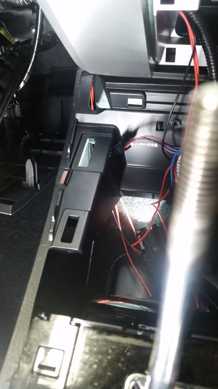

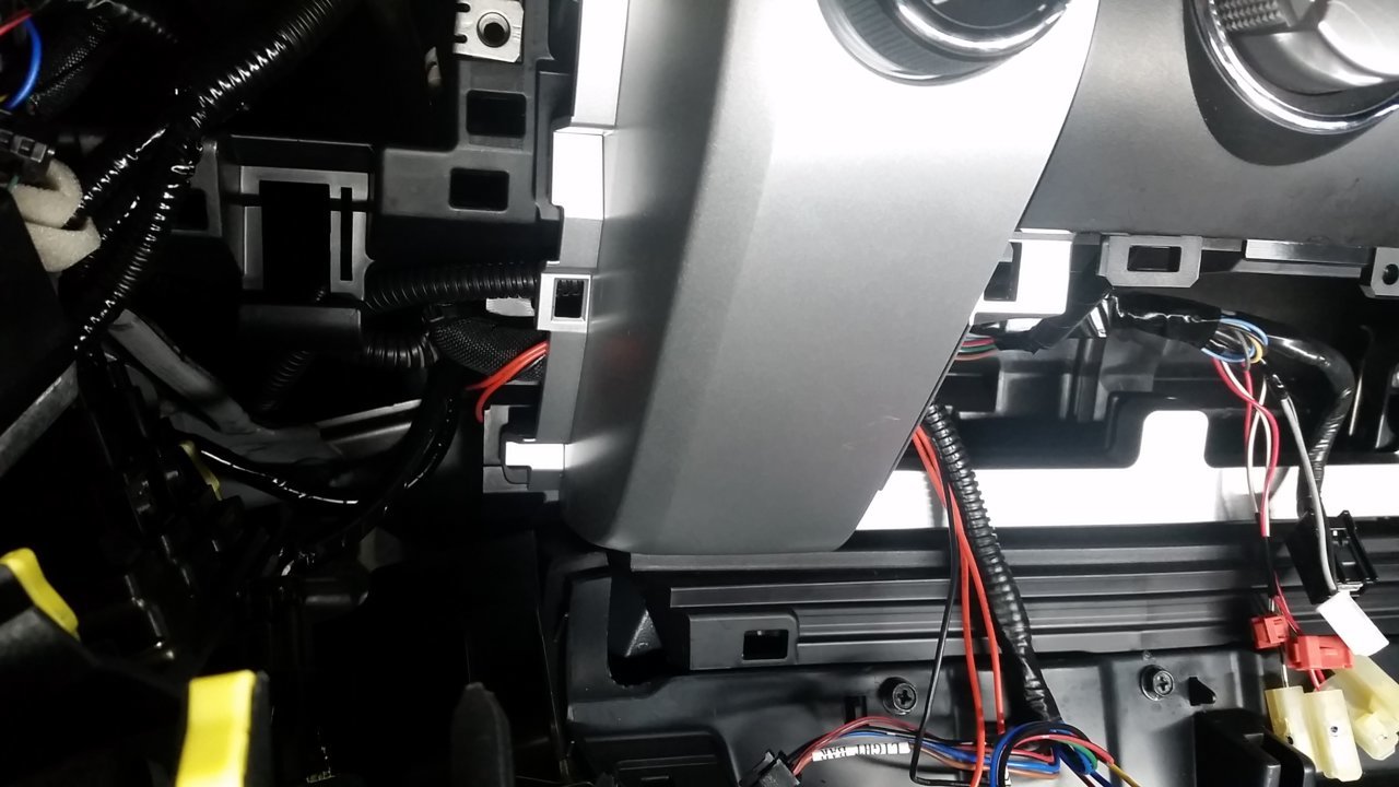

Running wires up left side of console
699
27 Jul 2018

Run thru same opening as other harnesses
666
27 Jul 2018

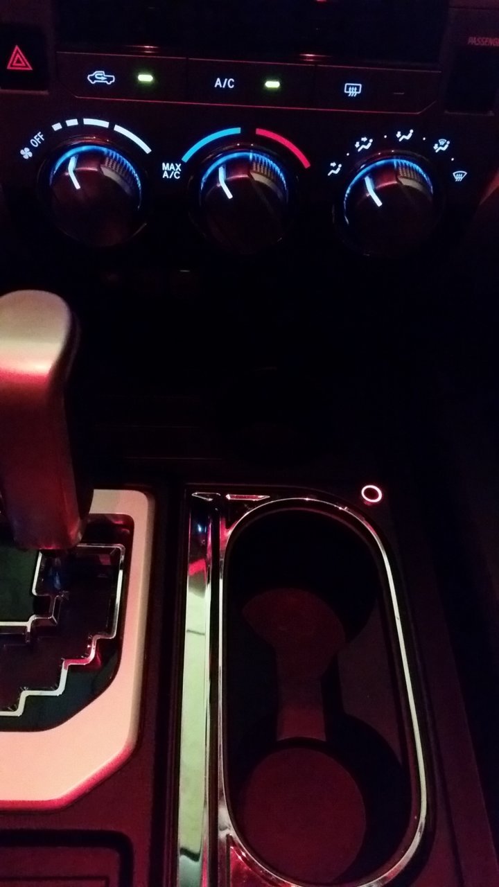

Button with LED strip off
665
27 Jul 2018
