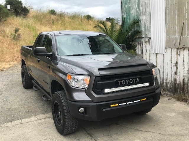

      Sweet Tundra! What did you coat bumper chrome with? Are those wheels 0 offset? Thanks.

      Thanks @UTAHRTK I coated my bumper with Iron Guard truck bed coating from Harbor Freight. ;) Sanded the heck out of the chrome with 80 grit sand paper and used self etching primer. So far it is holding up well! Hopefully it works for a long time or I will come up with something else. It does not have a gloss, so I feel like the finish comes out better than a lot of other choices. It’s all in the prep work.
      Wheel is a Pro Comp Phaser, offset is +12.00mm and 5.5 backspacing. Tire is a 285/65/R18 .... since I already had the tires but I imagine I will probably go up a size on the next round.

      Also, as of now it is just stock suspension and only has a spacer leveling kit for the front.

      Looks awesome. I have some method 704s and Mickey Thompsons arriving at end of month. I need to do something with the chrome bumper caps. Thanks
