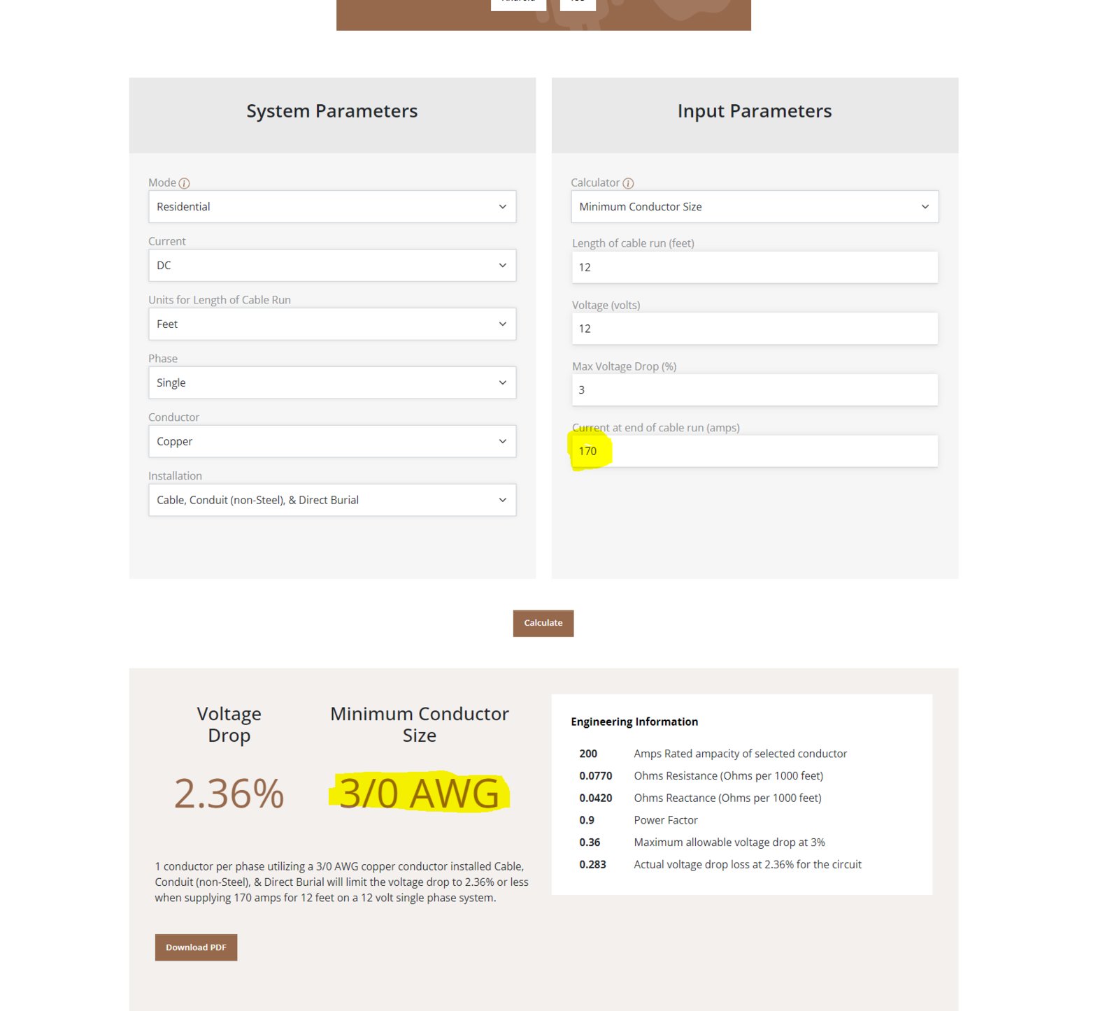

    2/0 at 12' is not big enough to run your 3000 watt inverter. I doubt you'll find anything to run that will be a continuous 3000 watts but hey who knows?? At 12 ft according to southwire you can run 175 amps which is about 2000 watts. @WhiteDevil1978 You'll need to shorten the run of 2/0 considerably.

    @WhiteDevil1978 Rather than buy a new battery I would buy a smaller invertor if you've just got money burning a hole in your pocket. Better efficiency for the likely loads you'll put on it too. Unless you're powering a 120v welder I don't think you would ever be close to 3000 watts
