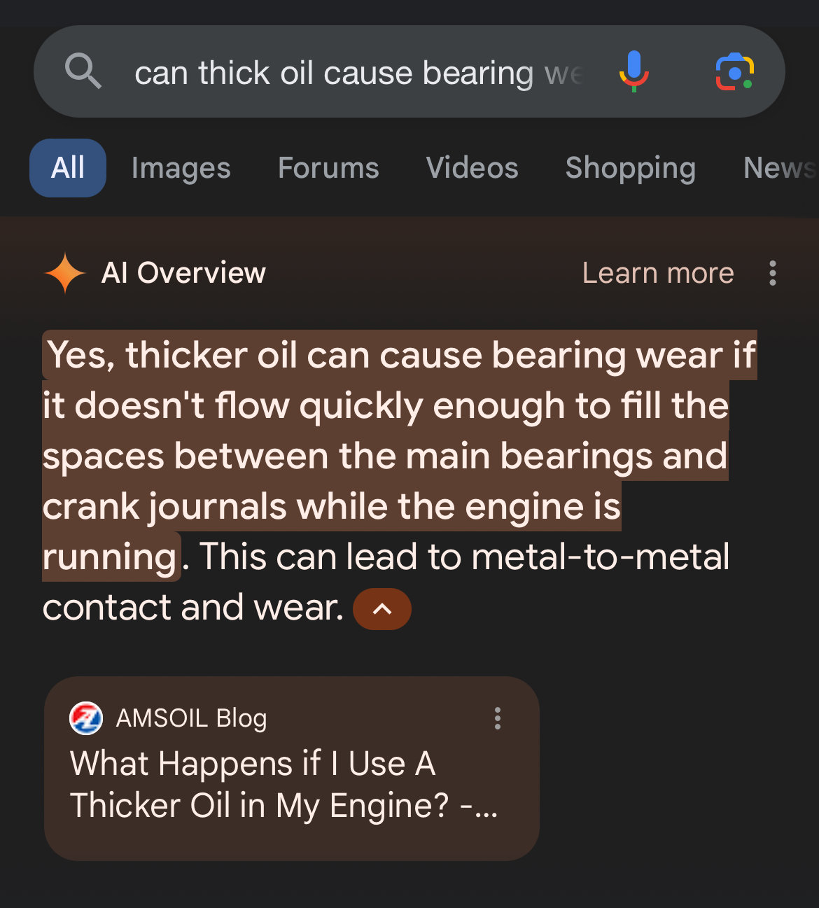

  11. May 16, 2024 at 5:33 PM

    Thicker oil can starve the bearings.
