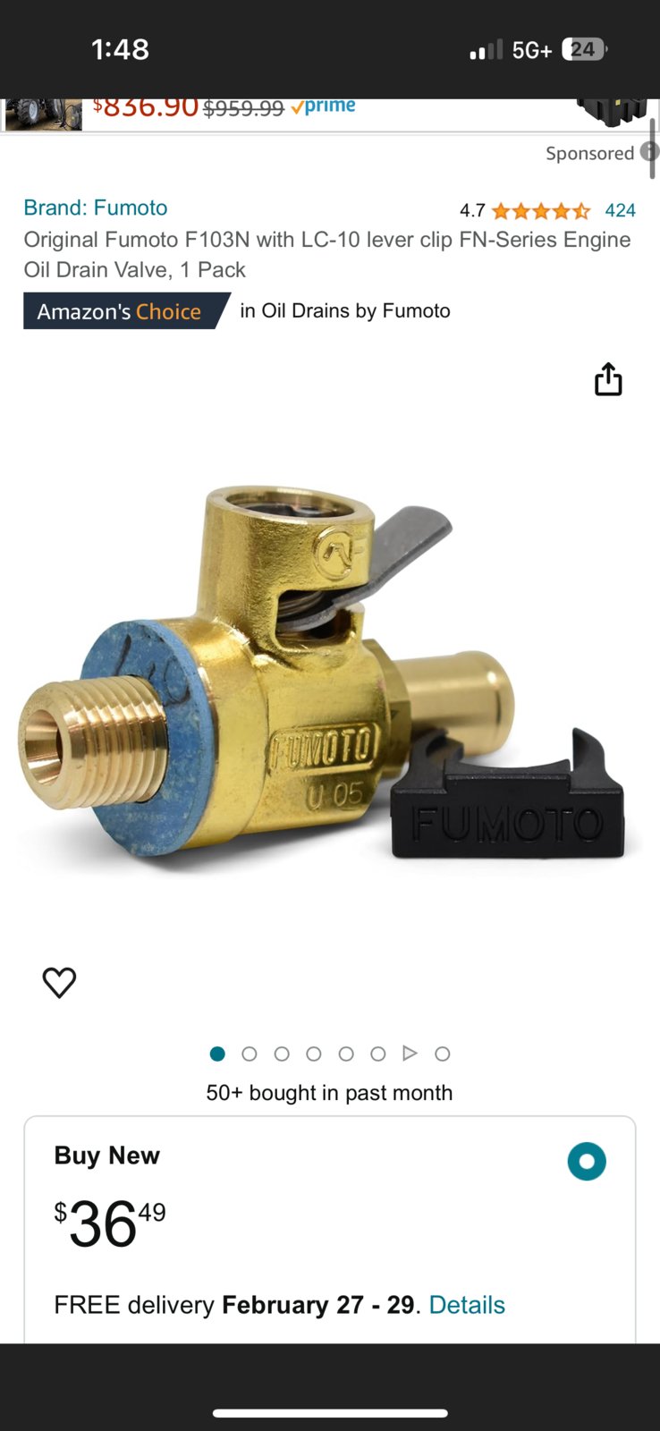

    Is anyone running one these on their truck? Seems way easier than messing with changing the gasket and getting oil on your handIMG_3939.png

    Probably half this website.

    Buy it you won’t regret it.

    Also look at the EZ Valve. Similar design with larger opening, oil flows out quicker. I have both and use the EZ.

    The only complaint I have with these is that you cannot get the last fraction of an inch of used oil out of the pan. It probably isn't a big deal at all, especially since Toyota recommends 10,000 mile oil changes. Even just pulling my drain plug, I have to jack my truck up on the passenger side to get all the oil out of the pan. I can get about half a quart more using my floor jack.
    It's probably all trivial anyway, these new oils are pretty advanced. I am sure the convenience of the Fumoto far outweighs any negatives.

    Any issues with the valve opening inadvertently? Does it lock in some way to keep it from opening?

    It does. See on the photo, there's a slot the valve lever sets in (it's open in the photo, and you see part of the spring that pushes down on it)...you have to push it up out of the slot before you can turn it. Secondly, the black plastic half ring that fits onto it, also 'locks' it in that slot.

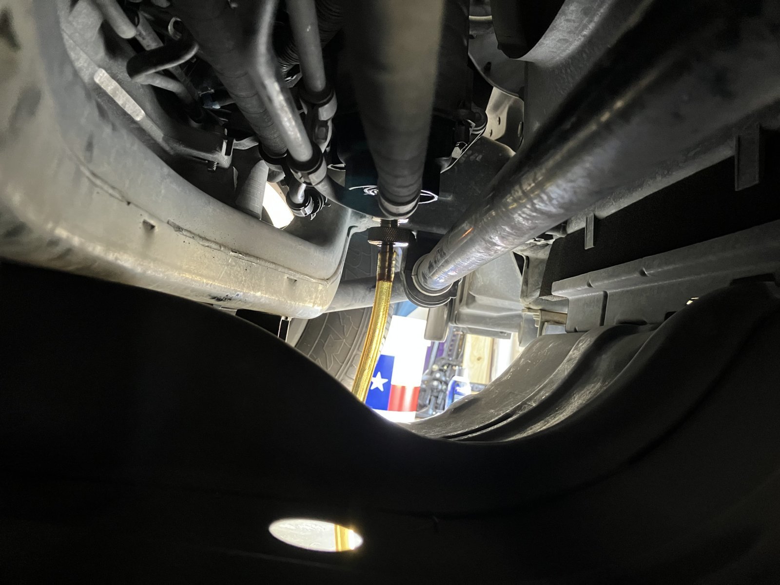

    For me, it solves the issue of the warm oil on a Tundra flying out towards the tire and making a mess. This allows you to redirect it easily. I also started using one of these for the filter a few changes back.

    What product is that? I like the idea better than the cheesy clip thing that comes with the filter.
