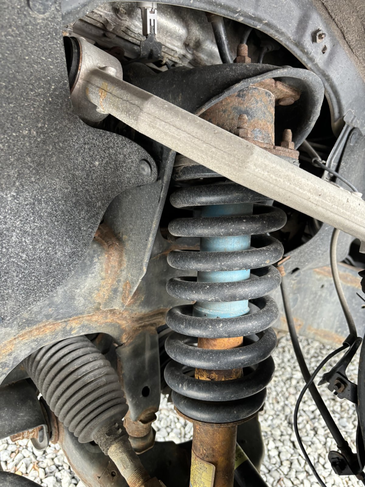

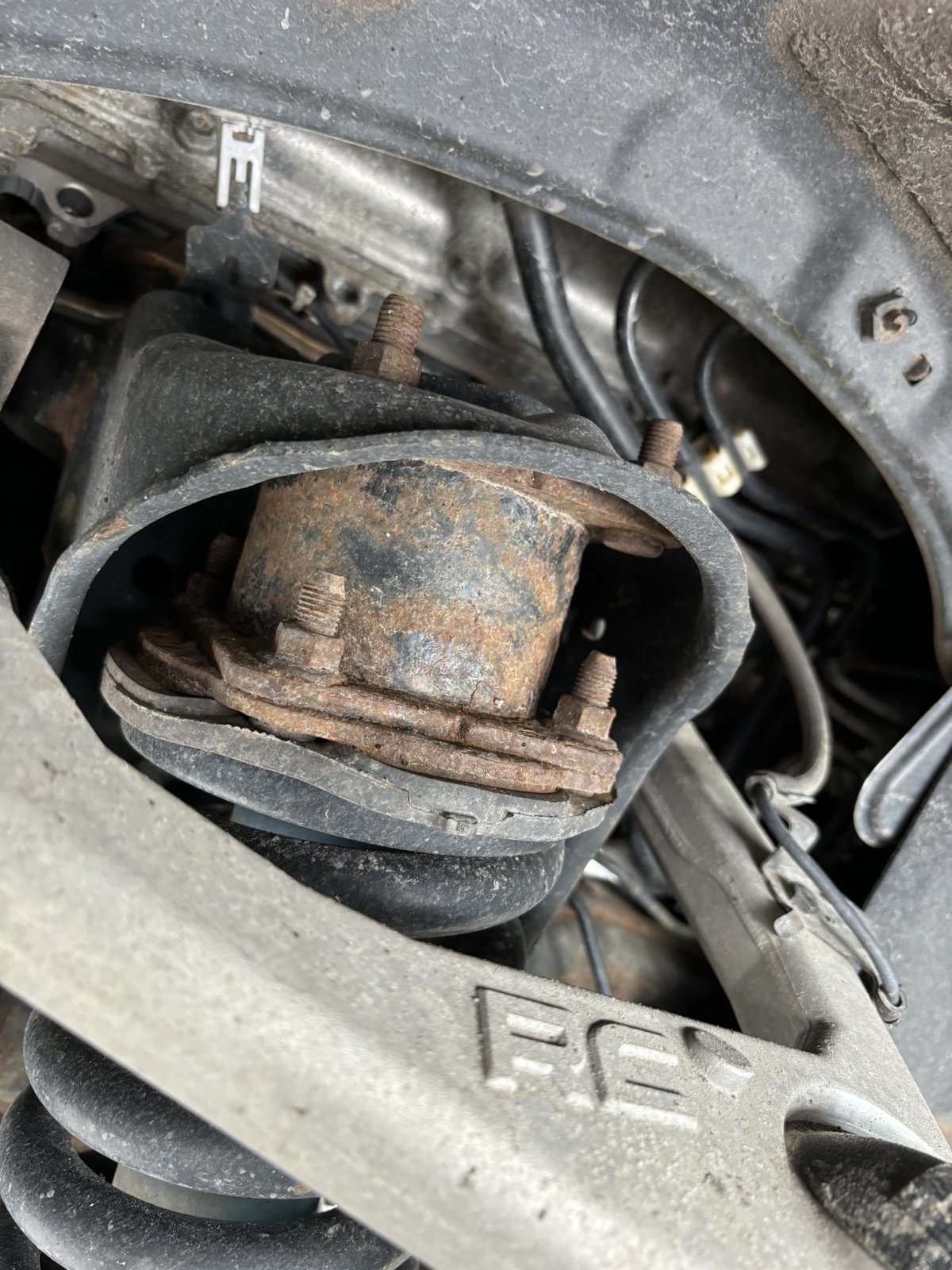

    Shoot some pics of your “bracket” lift. If it’s truly a bracket lift (didn’t know they made a 3”) then they are not easily reversible.

    I will get some pictures when I get home. It has spacers between the Coilover and mounting bracket that measure about 2.5 inches. Wheel hub to fender height is about 25 inches. I called Rough Country on Monday and they confirmed that it was a 3 inch lift. But I will get you some pictures when I get home.

    Spacer or Puck lift. Not a bracket lift which is a very good thing

    Definitely not a bracket lift. It’s just a spacer and rough country control arm. If it were a bracket lift you would be in for a lot of work because you have to cut the crossmember and replace it with the lift one. What you have will be very easy to accomplish what you’re after and much cheaper
