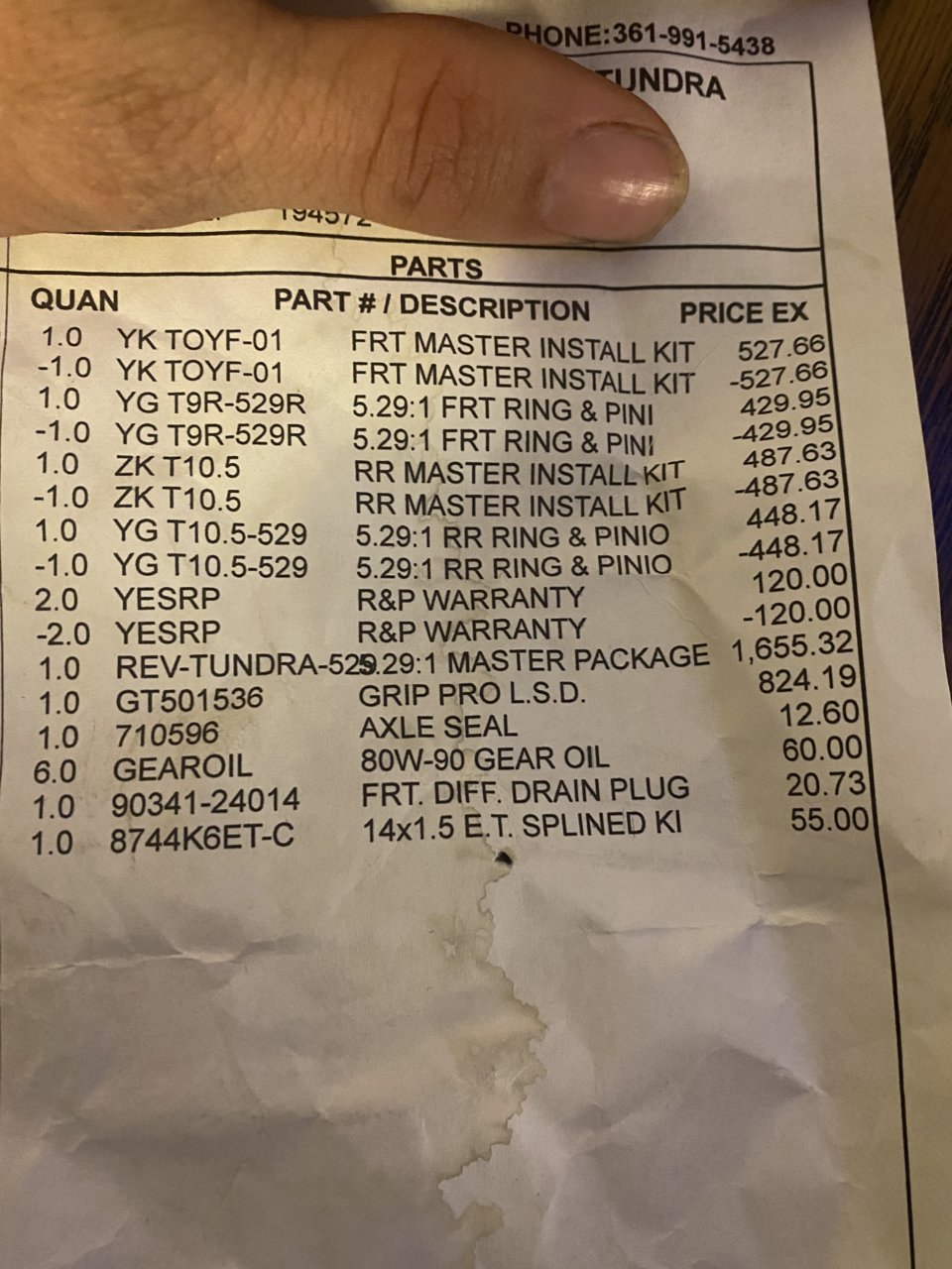

    So I went to four wheel specialties in Corpus Christi Texas and they ordered all the parts for install here is a picture of the parts list maybe the numbers can help you out

    4 wheel did mine too, but I supplied all the parts. I’m sure if call revolution they can point you in the right direction. Btw how was your break in? Longview is a long way from corpus

    I got them installed probably six months ago and everything seems to be fine I had the grip pro installed also and I noticed a difference big time breaking. Everything went smooth took it back after 500 miles for a new oil

    Oh man, I got my Revolution 5.29s back around October 2020 through a group buy on here that went south fast.
    Yea I'm also seeing that Revolution doesn't have a full kit of the 5.29s available right now. You could try calling them to see if they have any timeline on when they'd have them available.
