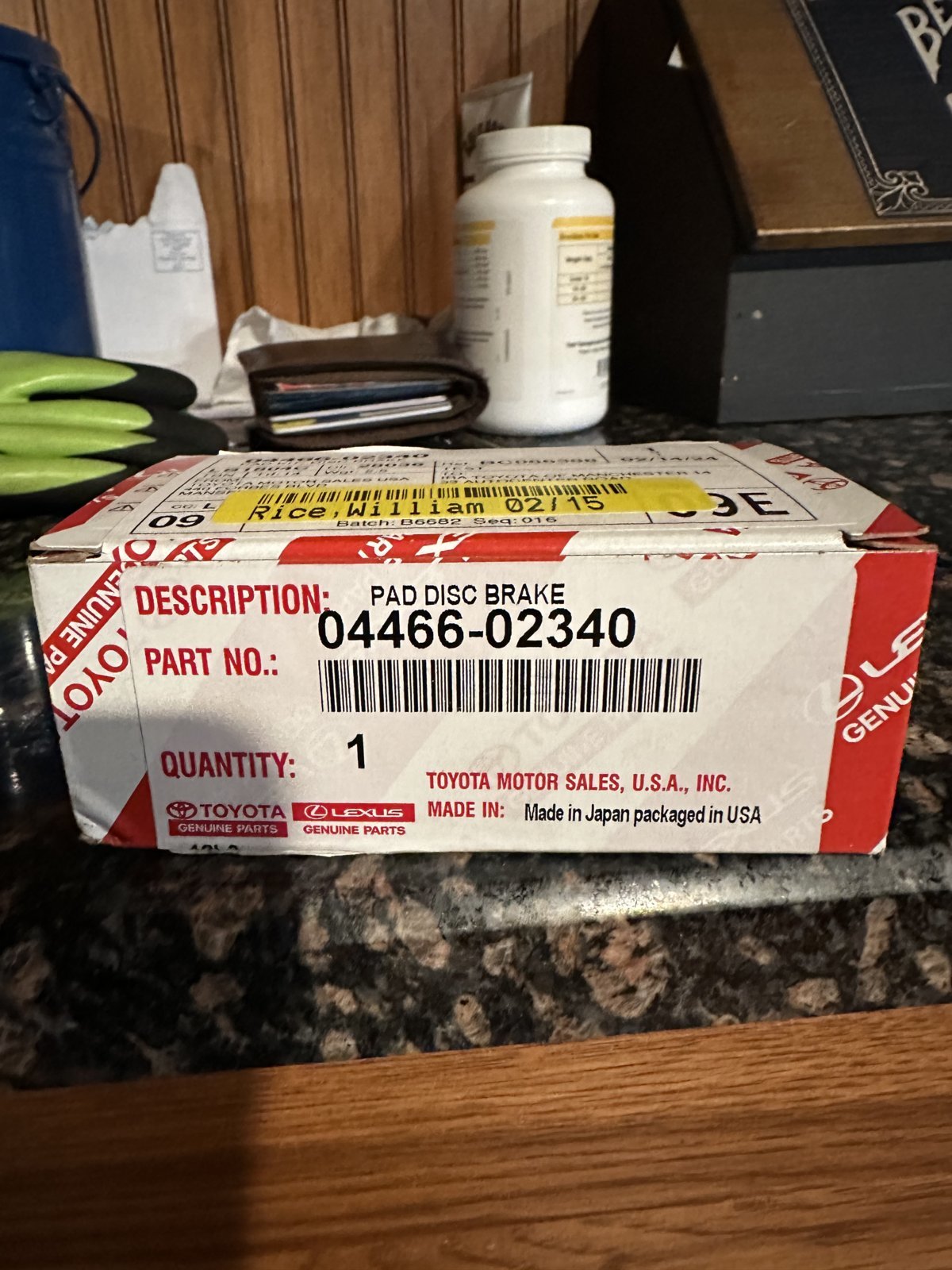

    I was told by my friend who is parts manager at a dealership that I buy from that there are 2 different pad sets. One is $62 and the other set is $90. I know the $90 set for the fronts are the same part # that came off when I changed them last year. I just ordered rears pads and Rotors. Rotors were $90 each and pads were $90. I got 83,000 out of them

    Picked these up yesterday for the rear and rotors.
