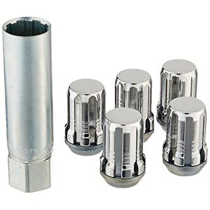

    Good Morning gentleman. New member here. 2011 XSP owner purchased new. Great truck, no problems at all. Till now. I had new tires installed at Costco around a year ago and wouldn’t you know it, they failed to put my anti theft lug nut socket back in the glove box. I have been to 2 dealers, called Toyota, ordered multiple sockets from Amazon. Can’t get the size right. It’s a seven externally splined nut on a 20 inch BBS wheel. Does anyone have any idea what it is? Part number, size, anything? Glad I haven’t had a flat. Thanks in advance for any help given. David.

    Are you referring to all your lug nuts or one of these per wheel?
    It sounds like your describing a TRD spline nut made by McGard.
    Part number PTR2734070
    PTR27-34070 - Genuine Toyota TRD Lug Nuts (toyotapartsdeal.com)
    Are you sure it is 7 splines and not 8?
    I have TRD lug nut kit.
    It has 8 spline nuts for regular lug nuts and a locking key nut for security.
    Part number PTR27-60110
    PTR27-60110 - Genuine Toyota TRD Wheel Installation Kit (toyotapartsdeal.com)
    When I bought this kit I ordered a spare locking key, a spare spline key, and a spare locking lug from Mcgard.
    I keep one set on the truck and one in the garage.
    If you can figure out what size it is, you can order a key off Amazon.
    Some of the reviews read the 22MM fits Tundras, you have to confirm that though.
    A review also states it has 8 splines.
    McGard 65302
    Amazon.com: McGard 65302 SplineDrive Installation Tool - 22mm Hex Size : Automotive
    If you do have 7 splines, there are some of them on Amazon as well.

    Thanks for everyone’s help. What I ended up doing was removing the anti theft nut by driving a 7/8ths impact socket onto the nut and removing them. I replaced them with a factory lug nut purchased from the dealership. Not what I envisioned replacing the pads and rotors. It’s been a week dealing with this. No more anti theft garbage for me. Thanks again for the help! David.
