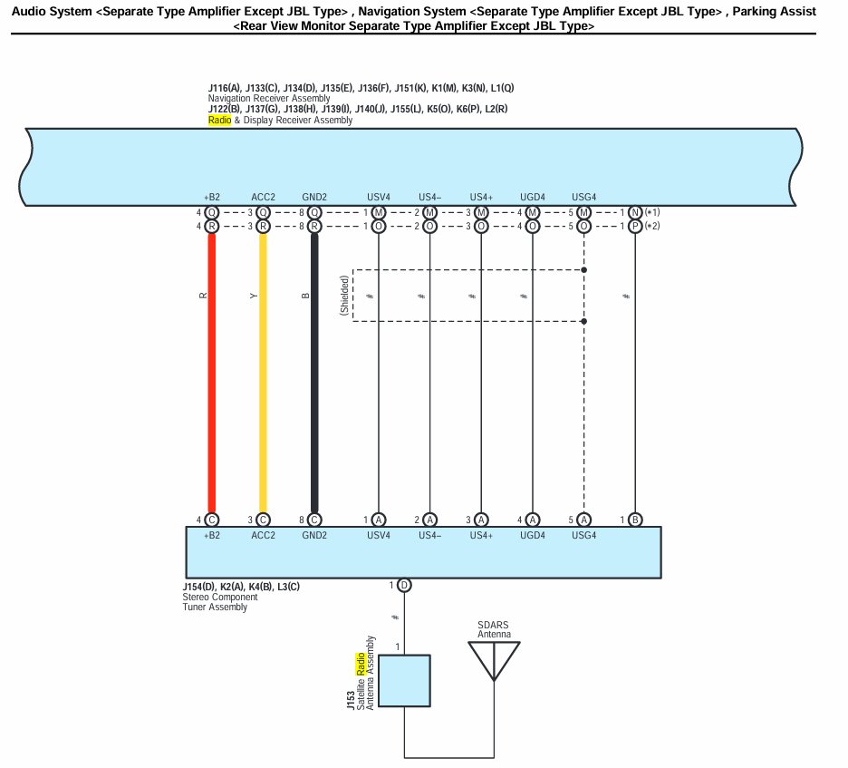

    86960-0C010 - 2010-2019 Toyota Tundra - Satellite Antenna
    There is also a connector J153 close to the antenna.
    If you can get to it, you might check that too.
    Looks something like this.
    It is behind the passenger A pillar
