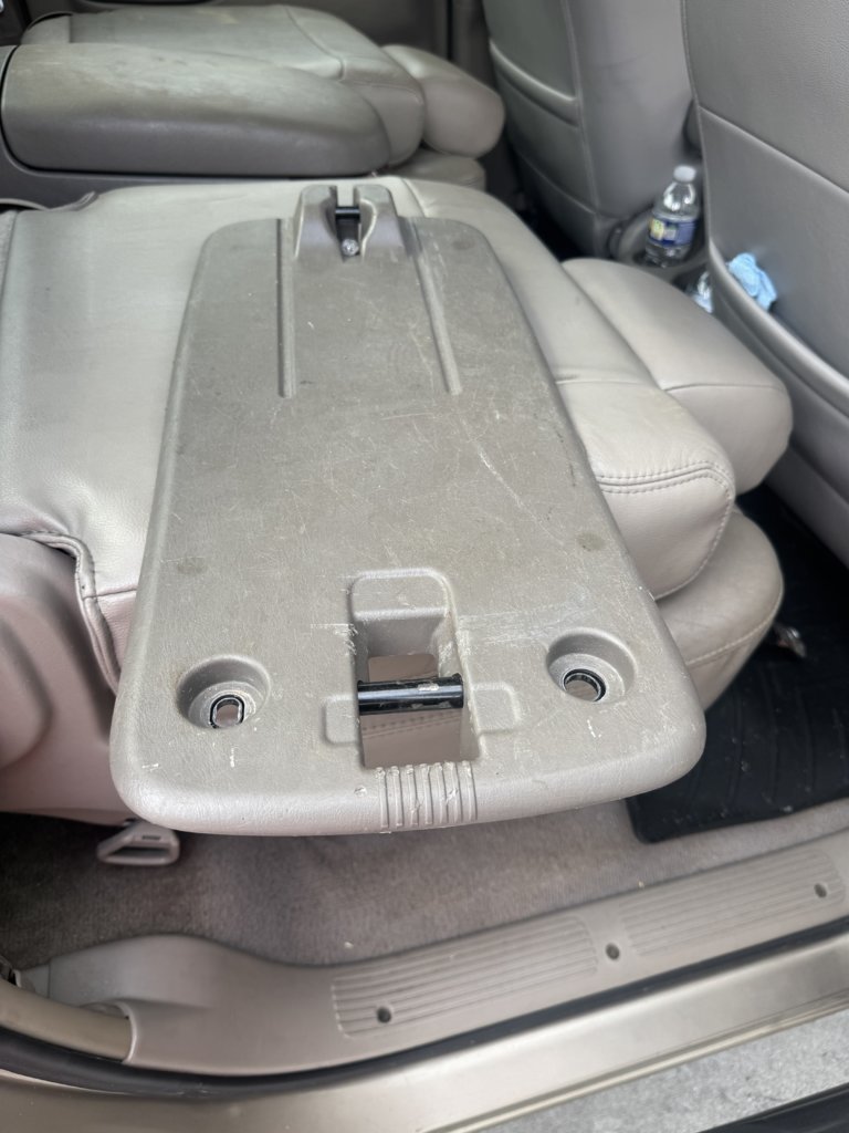

    2. Remove the center latch assembly by Unbolting the two 14mm Bolts from the latch. The cable can be removed from the latch by Turning it 90 degrees and pulling it off.
    3. Take your plastic cutting implement of choice and cut the center latch cover off of the lower seat plastic.
      With that, we are now done modifying the seat for use in the truck. You can reassemble the seat. In my case, I had to modify both seats this way to make them fit.

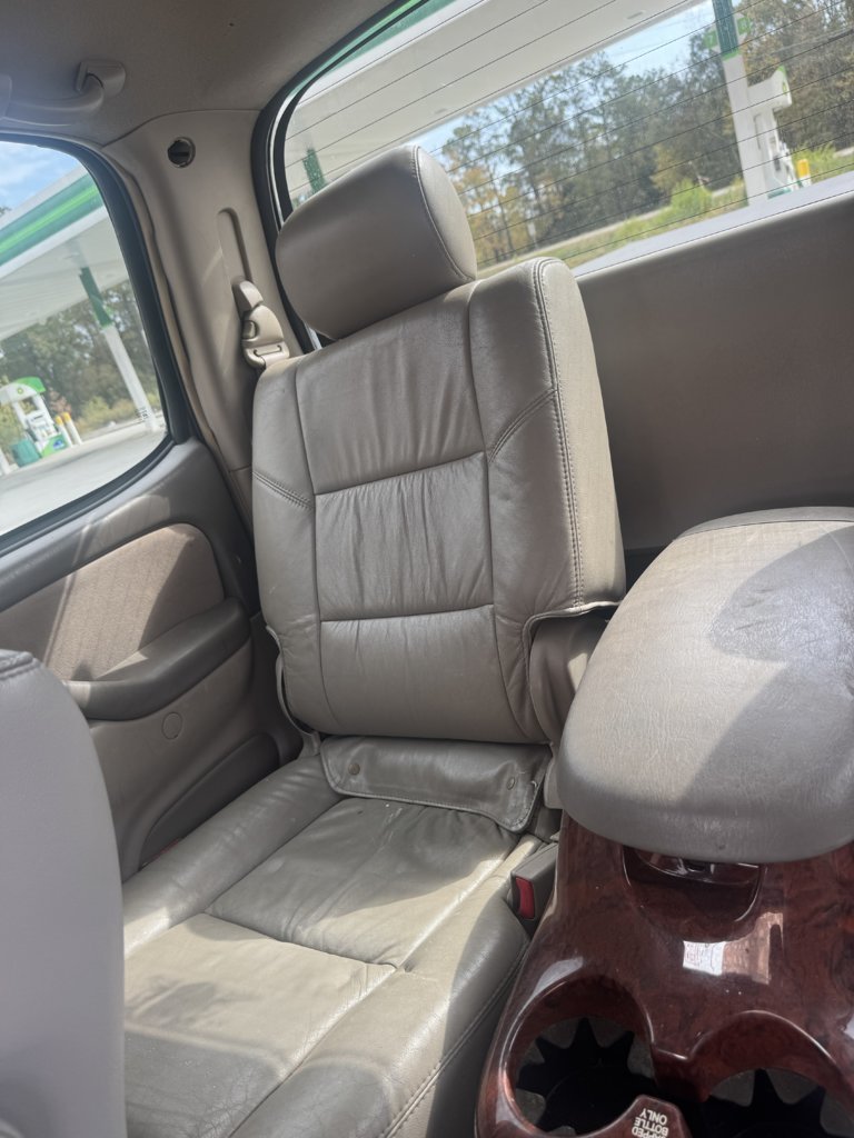

    Any pics of them installed in the truck?

    Sorry I’m not near my truck right now. Here’s the only photo I have saved on my phone. [​IMG]

    And that looks pretty flipping sweet. The amount of now-usable space in between those two seats back there looks incredible! When you get a chance, can you get an approximate measurement of that floor space opened up? I need my back seat for kids and stuff, but only 2 kids, so having that extra floor/cargo space for stuff would be awesome!

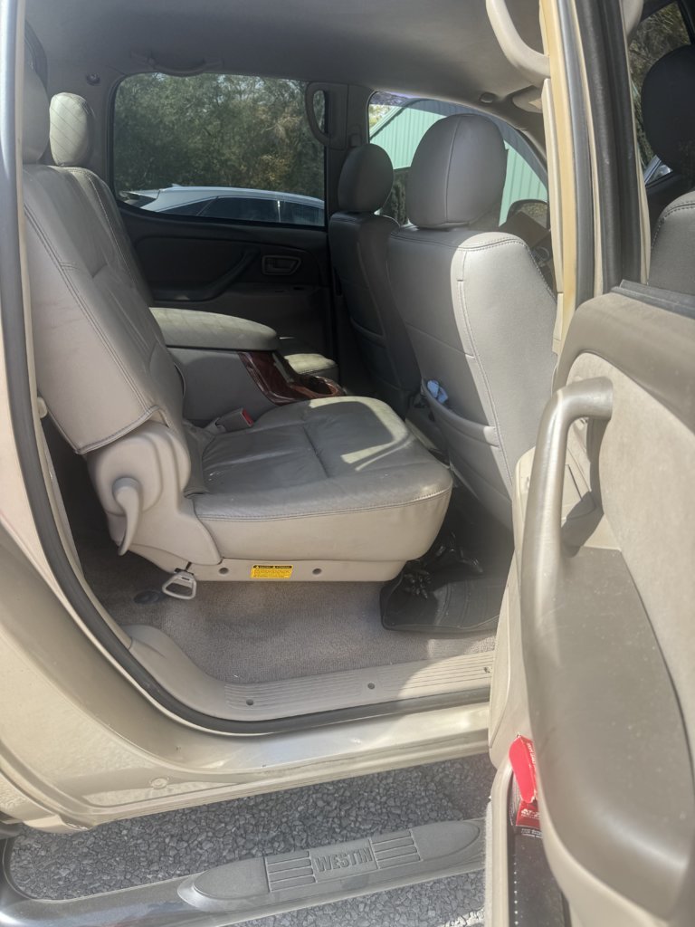

    wish I could've seen the donor Sequoia. Did you see yours? I'm puzzled why you have to cut the plastic for the latch. I don't mean I'm puzzled why you did it I mean, I'm puzzled that the tundra apparently has less clearance. I would've thought it was the same
    from the same model year as my donor sequoia
    close up of mine. The carpet is overhanging

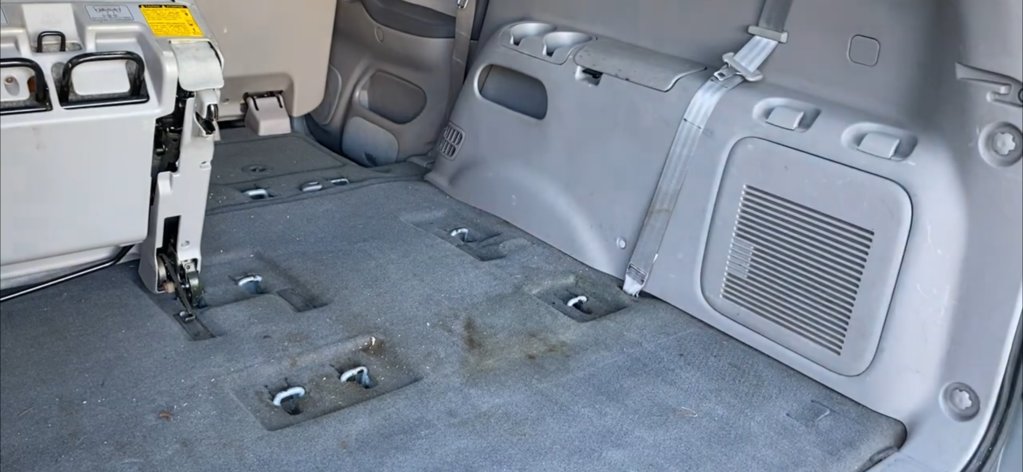

    To keep this post alive, I actually did the same swap to put the 05/06 second row buckets in my 04 Sequoia that never could be ordered with buckets and I can for certain vouch for the original post that you have to trim those off the seat and remove the latch because even the 03/04 Sequoia does not have the same striker/latch set up in the floor pan. To continue, the DC Tundra and 03/04 Sequoia also have a different floor plan under the seats because of the storage bin which meant I was in new territory since I could not find anyone else that had stumbled across this in a swap. So I ended up making a Jig and drilling out the spot welds on another Sequoia rear seat bracket mount to weld to my floor pan. Turned out perfect but was definitely a challenge!

    i'm not convinced I have to trim the plastic off of mine. When I remove the bottom plastic cover, i can easily push the part that covers the latch into the hole containing the strike plate/rod. I did not want to cut off the plastic covering the latch one if I was later going to add that second latch by cutting part of the floor pan from a Sequoia as you did
    I've got mine installed and it's working great. I'm just leaving the bottom plastic cover off until I make a decision about modifying the floor pan
    I'm trying to relocate the source, but I also read that there were 3 different types of leather in the 2006 sequoia's. My rear leather seats feel like a real genuine leather and now my truck smells like leather. Very nice smell when you open the door
    I believe the front seats from another donor sequoia were only leather inserts and were covered with the protective film
