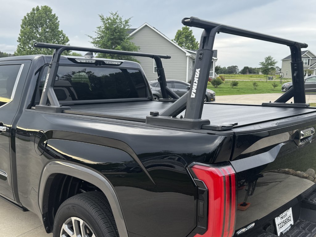

    Need some alignment on this...does this combo work?
    Elevate rails (for T-slot)
    BakFlip Tonneau
    Yakima Overhaul HD
    Does the Yakima work with the elevate Elevate/T-slot system?
    and lastly...do they come in 6.5'?

    Not sure about the yakima if it integrates into the T-slot system, but there have been some saying that the BakFlip does not work with the elevate rails due to different brackets / hardware. Trying to get more specific answers - or if anything, might as well just do an install myself.
    Even then, if you somehow manage to install the BakFlip folding cover, the rack would probably be in the way so you probably would not be able to fold it up. (also think, the Yakima rack is angled inwards).
    Another thing to think about, the base of the Yakima rack is not flat. Instead, towards the outer edge, it is angled down 90 degrees, and the length of that 90 degree run is much thicker than what the elevate rails' thickness is. So essentially, elevate and yakima overhaul is not compatible. Now put a BakFlip Tonneau in to the equation? .....

    Well, I ended up getting a screamin' deal on a Retrax XR Pro with Tslot. So, now to figure out which bed rack system I need. In a perfect world, I won't need to go above the top of the truck, buuuut...you just never know what you need.

    I'm not usually one for Amazon racks, but there is a copy Yakima system that works for t slot systems. One of those names that is a mash of consonants. I'd be willing to give that a shot for my work truck and see how it holds up
