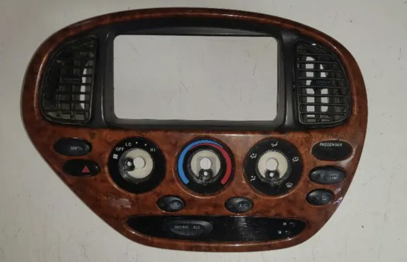

    Hello all. I was piddling around in the other wood grain threads and could not find an answer to my question (or probably overlooked it)
    Anyway, I’ve identifies a few bezels online for the 2WD but they all are a bit expensive as opposed to their 4WD counterparts for some reason. To be specific, I have bezel with the Carho Lamp and Defrost button on the on the right hand side. Emergency flasher on the left, under the Shift L button
    Is the 4WD version of the bezel above compatible with the 2WD l? I was hoping to get lucky enough for it to be compatible and just have the 2WD/4LO buttons on the clock face ignored for obvious reason

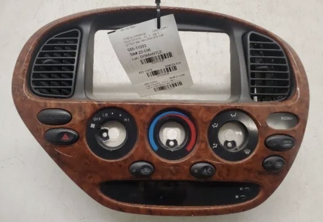

    Second picture is the one I need. First picture is the one that’s for a 4WD model. Asking if the first picture is fine to place in a 2WD model and retain all functionality of the bezel, outside of the 2WD/4WD buttons on the clock

    I'm pretty sure those are fully interchangeable

    You’ve got a lot of fun waiting ahead of you to swap stuff over. As long as the HVAC and clock chunk get moved you’ll probably be fine, not all are cross-compatible, but potentially some work there. I’d search locations other than fleabay.

    The earlier bezels have a smaller opening than the newer version

    The first has the “shift L” button for the 5 speed auto. The second has a “Tundra” button. Do you need that shift L button? Can you swap the buttons from your bezel into whichever you buy?

    You are correct. I don’t “need” the shift L button but my bezel has it. I think what I’ll end up doing is buying the 4WD bezel, switching the boards over and obsolete the buttons on the clock.

    You can peel off the long thin flexible black plastic that covers the clock and then swap it on a different bezel. The only thing is that the adhesive on the back side of it might not restick as well. Use a heatgun or hair dryer to soften up the sticky glue. And clean your hands really well before hand so that the oils don't contaminate the sticky stuff. Better yet, just make sure you don't touch the sticky stuff at all.

    Whether you plan to use it, or it’s actually required for the truck to function properly may be two different things. I’m not sure as my truck has the 4 speed and no shift-L

    i don’t believe it’s necessary. It only engages if you toggle it and to do so you have to specifically put the rig in 2nd gear first. Like I said I’ll get the bezel with the Shift-L button already available so hopefully it won’t be an issue either way
