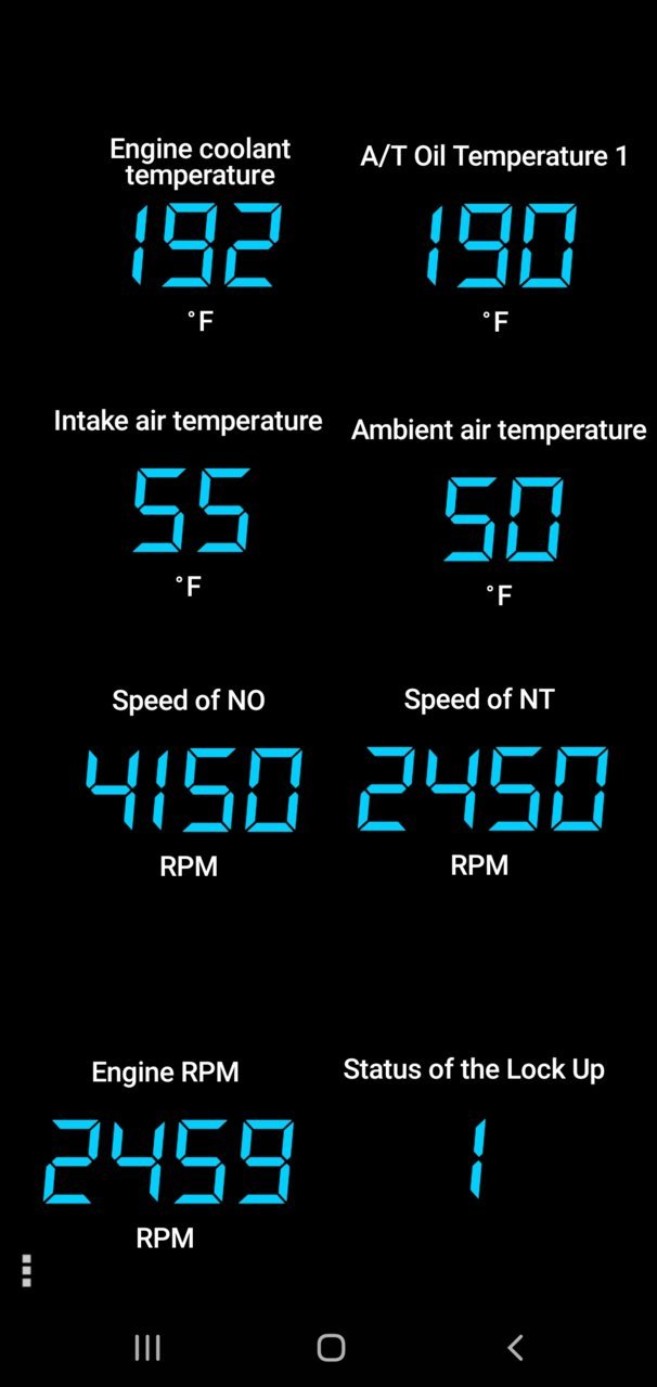

    Something not mentioned in this thread is fluid expands with temperature and pouring out hot fluid and replacing it with room temperature fluid is a recipe for failure.
    For less than $35 a Bluetooth OBDII Elm327 dongle and OBD Fusion App with Toyota PID pack and walla, you can read the temperature while under the truck.
    And ya, it takes very little idle time to shoot past 130°F.
    Here is a screenshot of app...
