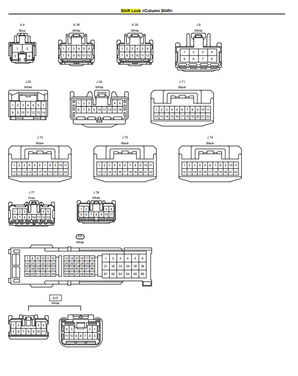

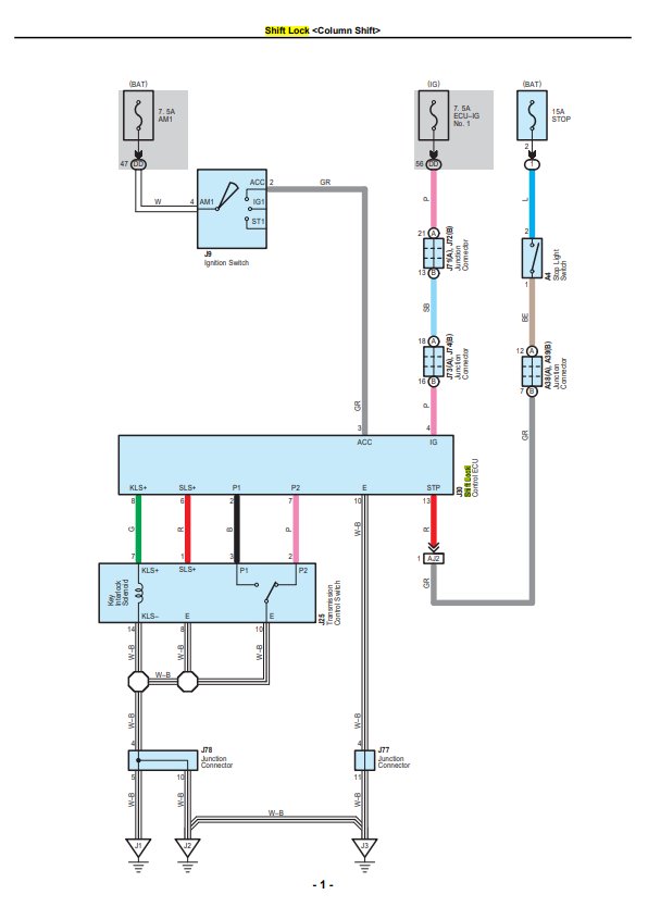

    Wiring for the column shift lock.

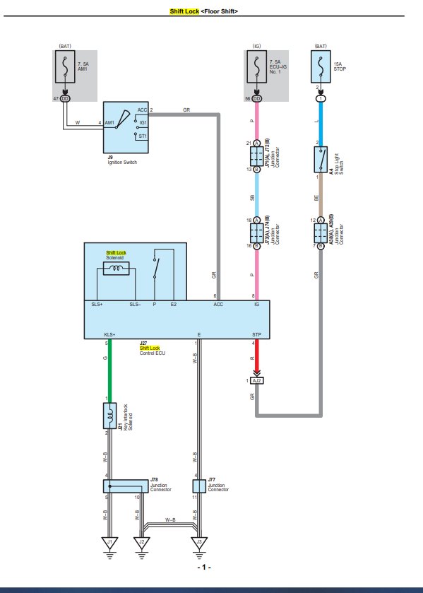

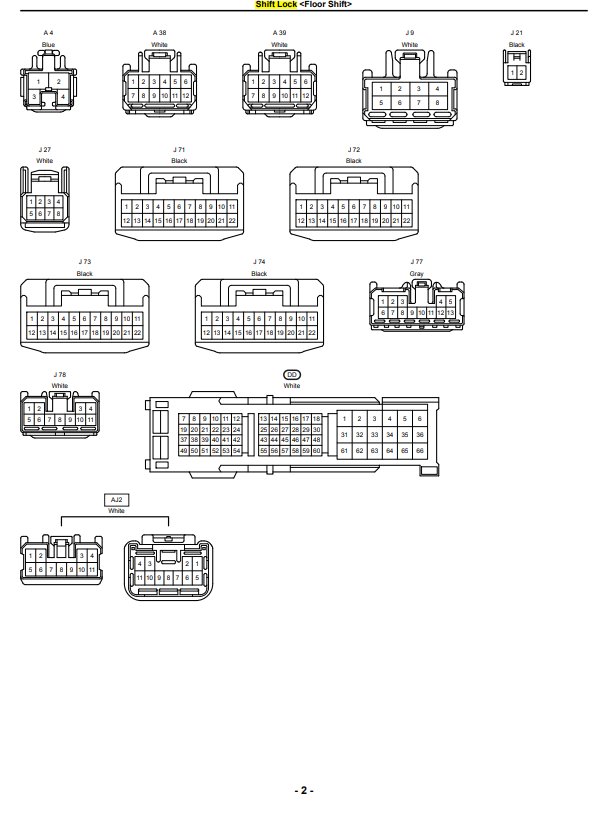

    Floor shift lock
