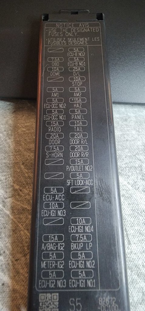

    Hi, trying to install dashcam. Was curious if anyone has installed the Wolfbox i17 or similar and what fuses worked best? Using acc hard wiring kit to have constant recording. Thanks in advance ☺️

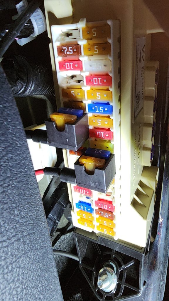

    The fuse panel above your feet > third fuse down labeled ACC. I believe I used the power seat fuse for constant power. Sorry I'm old and the cold outside will trigger major spasms in my back if I try to lay on it under the dash to see which fuse I used.
    I also used the cover below along with "add-a-circuit" style connections in the fuse box.

    Hi! I just recently installed the G900Pro a few weeks ago and love it. I tapped into Radio and P/Outlet NO.2 below the dash. Just be sure to orient the tap correctly (+ & -)
    You can also wire it to an empty slot that has power if you have any. You have a '20 Platinum so maybe you won't have as many empty slots as me:confused: Just be sure to test whether it's ACC or BATT. I may move mine to one of the empty spots

    Thank you! It worked! Was trying to connect it to the other fuse box, should have tried inside first.
