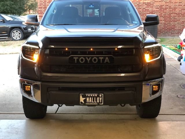

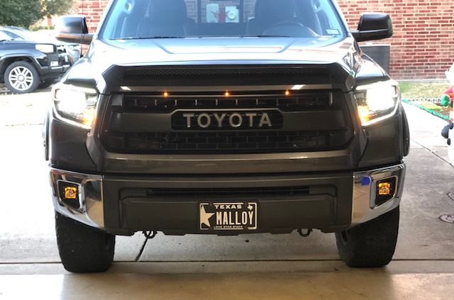

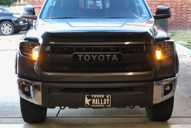

    2 issues with tapping into your DRLs;
    1. The DRL bulb has two filaments in it, they have 2 settings.
    Bright during the day and dim with the parking/headlights on.
    Neither one is 'on' all the time.
    2. Your DRL is your turn signal, so your entire bulge light would blink with whatever side you decided to tap into.
    Turn signal during the day blinks bright on and off.
    At night with the dim DRL on, the turn signal blinks bright (from what I remember).
    IMHO I don't think the hood bulge light needs to be on during the day anyway.
    I'd prefer it come on with the parking/headlights, but it isn't my truck.. :D

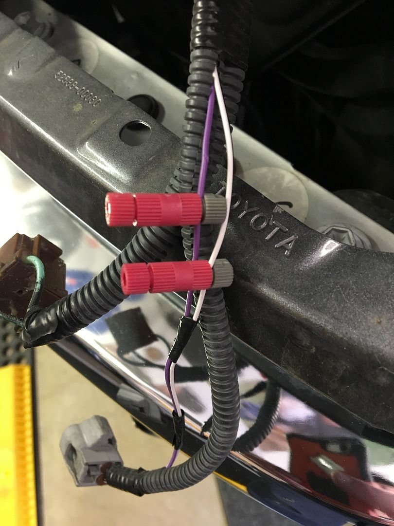

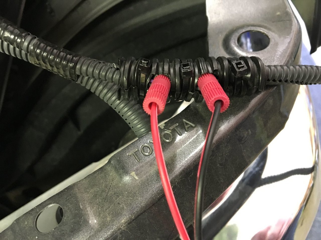

    Anyway, I tapped into the parking light circuit in the headlight for my grille lights.
    They come on with the parking lights and/or headlights.
    I really didn't want them on all the time.
    I used posi-tap connectors to tap in.
    ED9943DE-EF87-495C-B7D9-2D0618D68B24_zps_d0faeb966f11e7639dc6c2da4b3aed6349df55b9.jpg F27CB0DF-A4EC-4639-AC7D-1DA96A1B1E8C_zps_53607bf7bd2d742df3a788bb14ff050868cadfc3.jpg
    Keep in mind I have OEM LED headlights, but I kept my amber DRLs.
    I didn't like the bright white strips for daytime DRLS.
    So, daytime DRL.
    Parking lights, my Rigid pods are also on the same circuit.
    My grille lights would be your bulge light.
    Headlights..
    Good luck..............:thumbsup:
