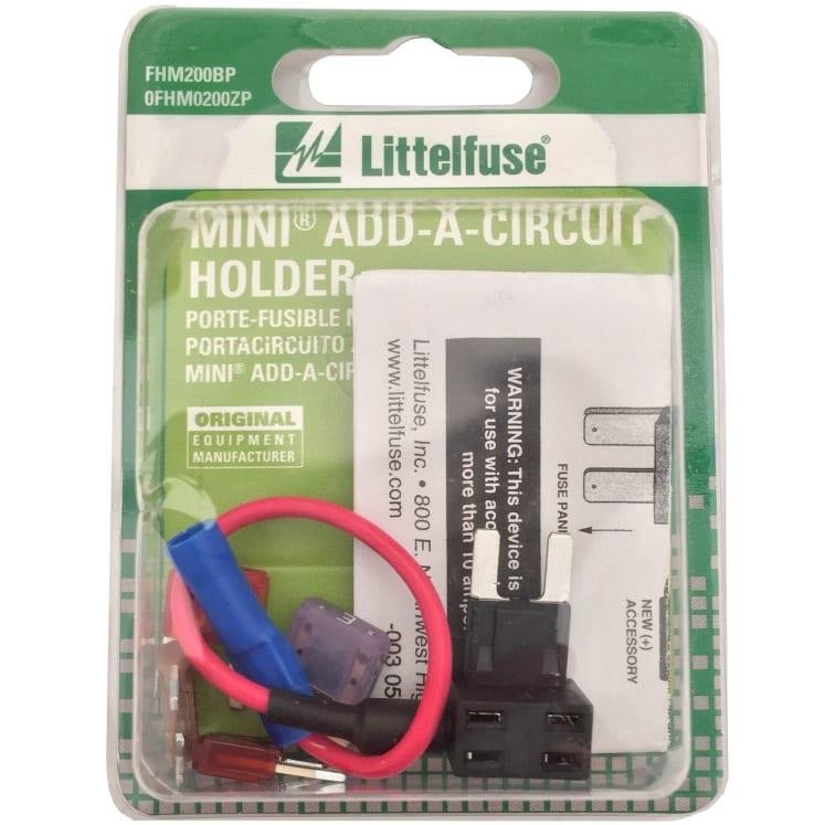

    Hey guys, I recently installed Prinsu racks on my cab and camper shell. I have Prinsu grab handles installed as well and I plan to install the Baja Designs rock lights in each grab handle. I'd like for the lights to come on when I unlock my truck, and then when I manually turn on my cargo light switch. I watched a video on a fella completing this mod on his Tacoma but I wonder if it's the same process on my 2016 CM. Anyone able to help or tell me which wire I should tap into to accomplish this? Thanks in advance.

    Get a mini sized fuse: add a fuse. Then find a fuse for the cargo light or similar either in the main fuse box or the driver e brake fuse box. Then wire accordingly to the lights. (This is assuming the lights don’t need some crazy amount of amps, I think the most this can add is 10 amps, otherwise need to wire to the battery).
