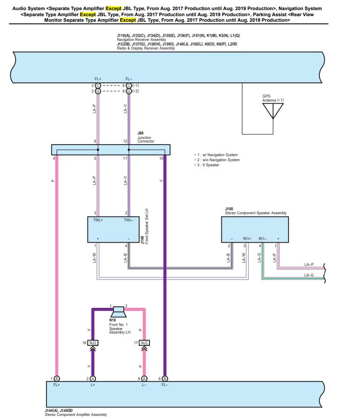

    What’s up everyone. I’m new to the site. I was wanting to reach out and see if anyone possibly has the wiring diagram for the 2021 tundra sr5 non jbl system. I’ve searched everywhere and everything I’m finding is with jbl. I’m currently installing a system using an active line out converter but I can’t not figure out where to tap into the speakers for the signal. Nothing is matching my wire colors and or pins. If you guys could help that would be great!! Thanks in advance

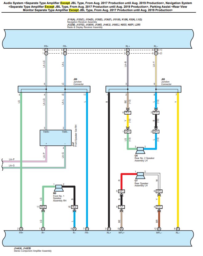

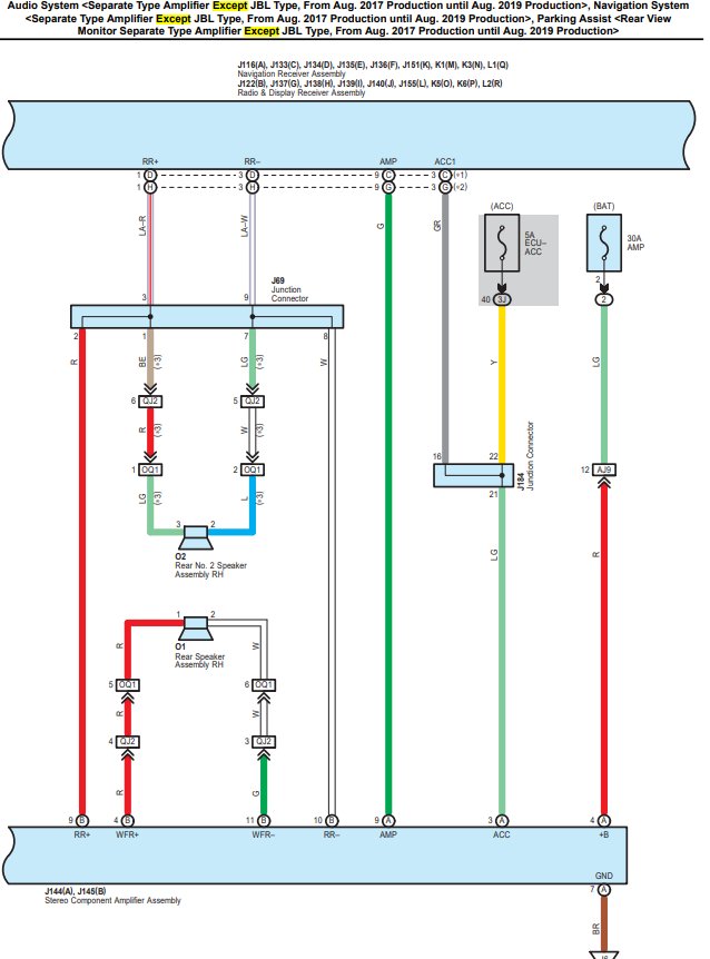

    Welcome to the forum..
    You can find what you need here.
    Ultimate TUNDRA Wiring Diagrams Collection | Toyota Tundra Forum (tundras.com)
    Just make sure you're looking at the non-JBL schematics.
    The schematics are a little different between the crewmax and the double cab, being the crew max has rear door tweeters..
    Also note the front door 6X9s only get a low and mid signal from the pass under seat OEM amp and the system uses the 3 dash speakers for mids and highs.
    The 3 dash speakers run straight off the HU.
    If you need a full signal for your LOC, one or both of the rear doors may be what you need...

    Ok I’ll check it out. I pulled both rear door panels and the speaker wires are red and white on both doors but when i look the the factory amp im not sure if the wires are the same. Everything I’m finding online is not matching what I see. Thank you for the link

    Everything you need should be accessible at the under seat OEM amp.
    Here is everything from the amp.
    You can see the rear speaker wiring changes colors 3 times on the left, 2 times on the right between the amp and the speaker for whatever reason..:confused:
    If you have a crewmax the rear door might be just lows and mids, I'm not sure.
    In my double cab it is full range since there is no OEM tweeter in the rear door...
    Good luck..
