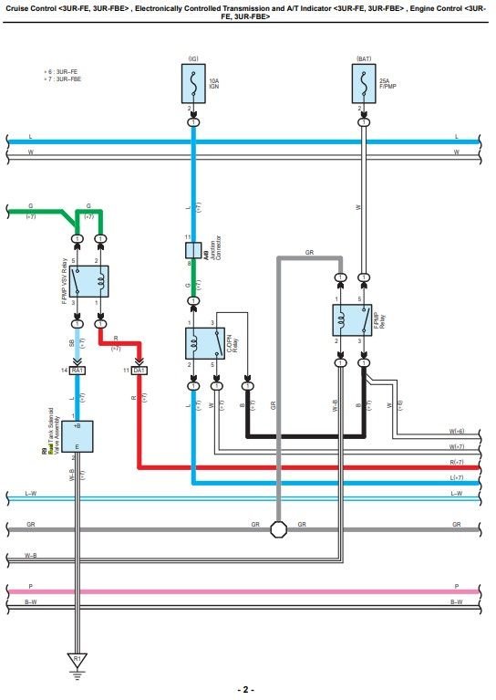

    Does anyone have the color of the relay pump switch wire for the 2014 Tundra sr5 4.6?

    Welcome to the forum..
    You can find it here..
    Ultimate TUNDRA Wiring Diagrams Collection | Toyota Tundra Forum (tundras.com)
    Give me a minute and I'll see if I can look it up..
    I have no idea what I'm looking for or which engine is which.
    If these don't help, I'm sure you can find what you need in that link.
    fuel_pump_1_cd7033ce3a5cbf92029367a2d0064a407e2b1189.jpg fuel_pump_2_658f33aa7b86e53b57bdff8e31893a91d4342dc5.jpg

    Man that's so awesome. Thank you very much for your help! Great website, I'm already loving this place and the smooth looking tundras
