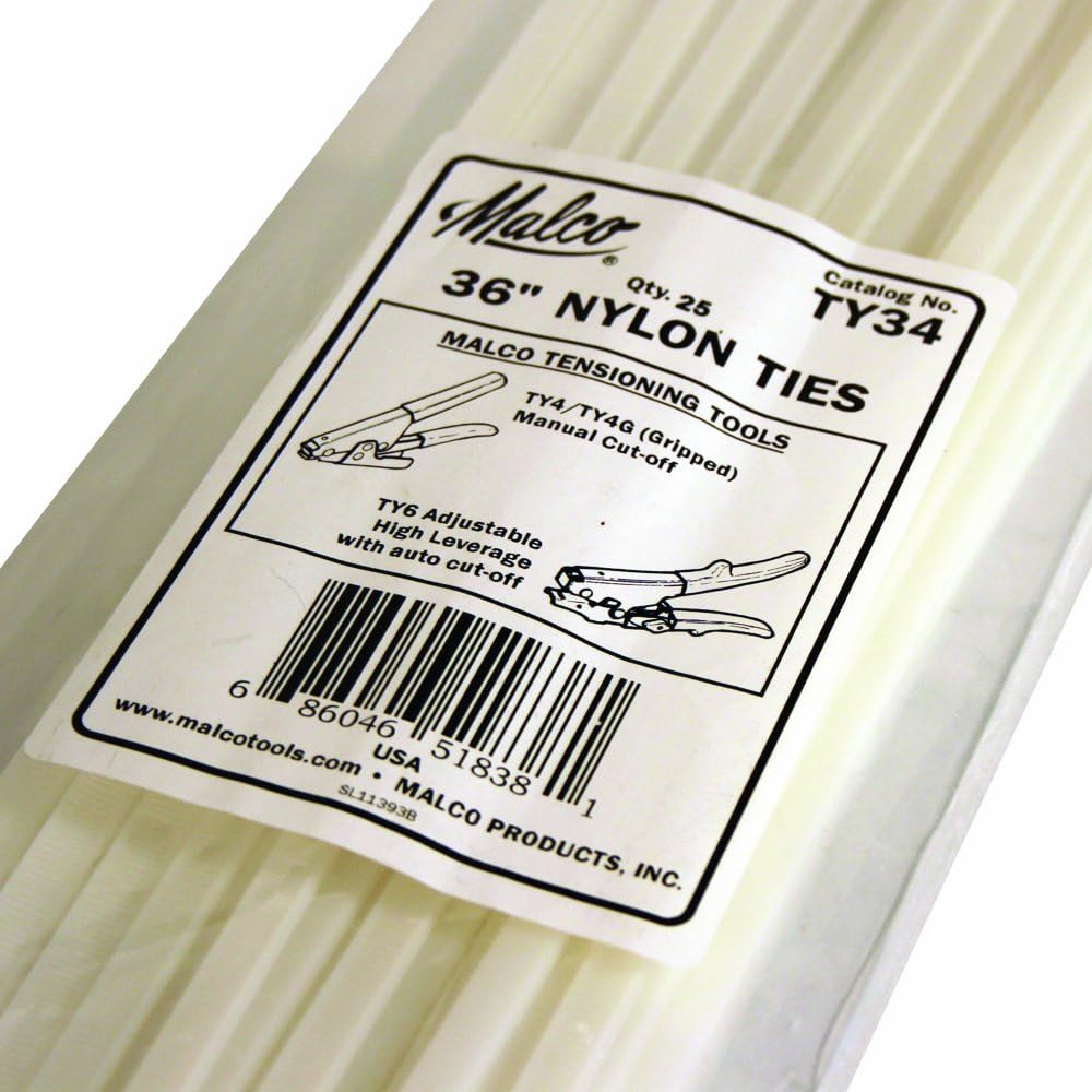

    I used 36" HVAC zip-ties to run wiring thru the dash and under the carpet for other wiring.
    I've found several other uses for them as well auto and home.
    You can find them at Lowes, Home Depot, ot Amazon.
    https://www.amazon.com/Malco-TY34-Quantity-36-Inch-Installations/dp/B003NFO5S2
